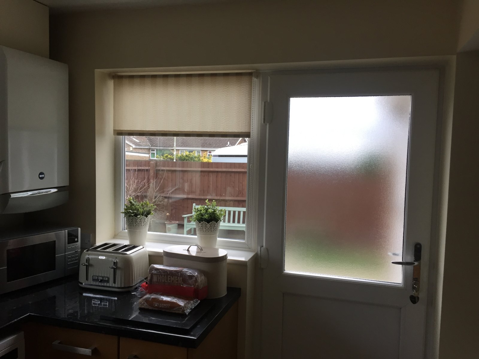

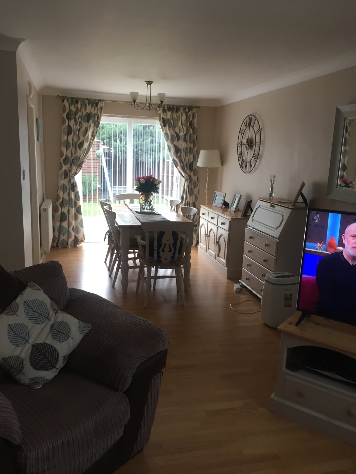

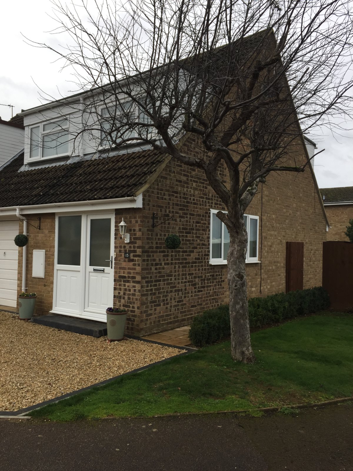

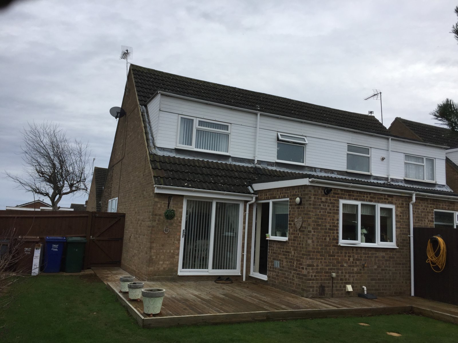

Currently thinking of extending a flat roof single storey extension to the back and side of our home but thought I could do with some feedback from you guys

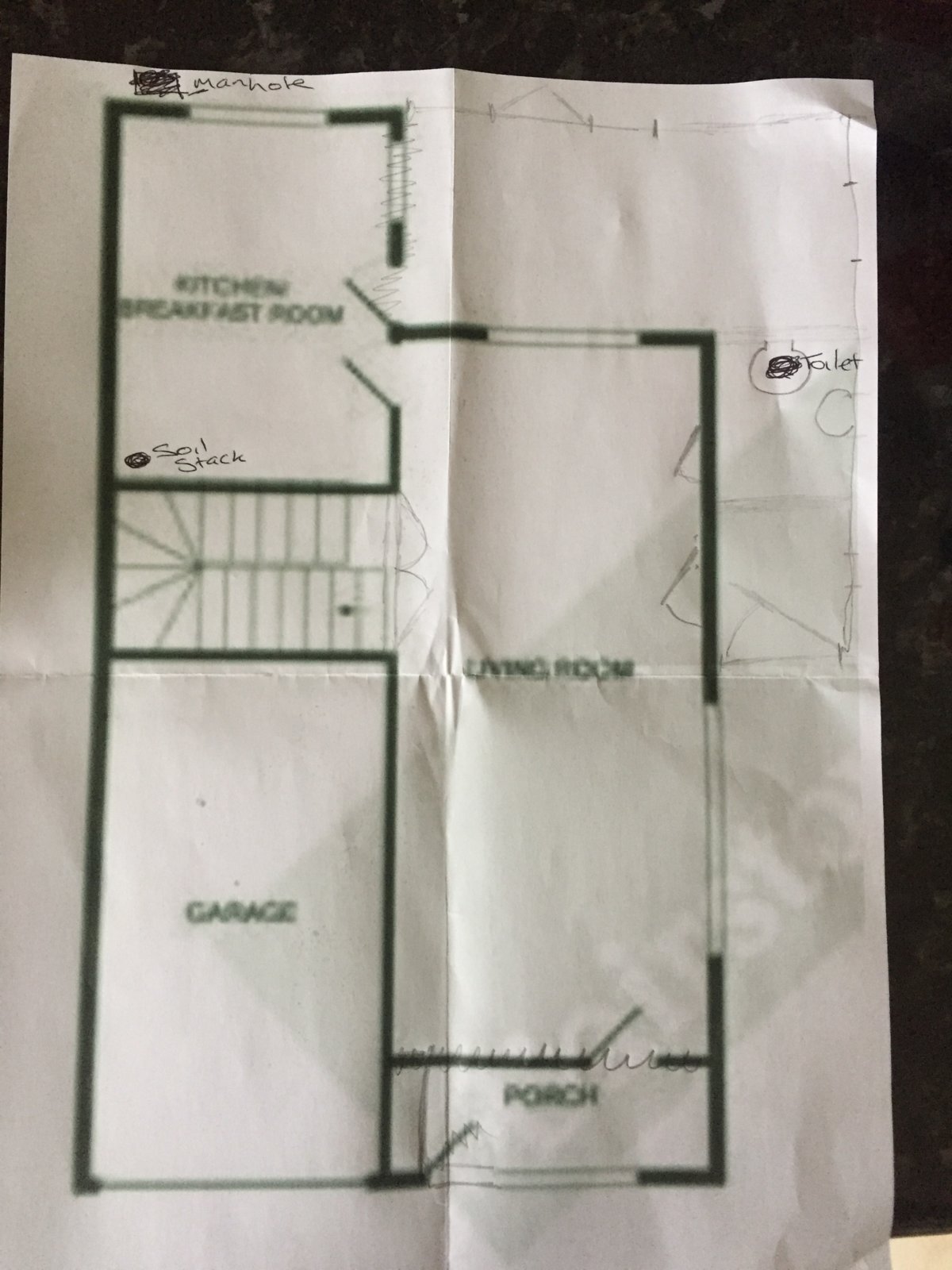

We already have a 1980s kitchen extension we inherited 11 years ago when I moved in but now we are thinking it would be nice to have a rejig of the layout and extend the living/kitchen space and add a downstairs toilet. My idea is to put a porch down the side of the house with a door opening opposite the stairs,adding a wc behind that with door opening into living room and taking out the patio door and extending where the decking is with a conservatory sized room so it is a separate lounging space to the living room. Putting a window in where the front door is and knocking the internal porch wall,I’ve added some pictures of floorplan and house from outside so you can get an idea
Only thing I’m not sure on is whether I would need to create another soil stack by the new wc and install s ridding eye where it would have to bend under the kitchen window
I’m a window fitter so will do all my own glazing,knocking down walls and doorways,plumbing,electrics,digging and roof timber work. All I plan to get in is someone to do the brickwork and roof felting,I’m hoping I can do it for £15k as I’m reclaiming blocks/sand/Celotex and whatever else I can from conservatory builds that the boss would just throw away
As the building work is beyond my original building lines to the side and facing a highway I would have to get planning permission
Complicated I know but can’t invite you all round to show you
Any thoughts?

To be honest,if I knew my way around the drawing board I would give it a go,not long finished the driveway and don’t want to rest the brain.I am planning on using the same bloke to draw up the plans that we use to pass our conservatories(ex council planner).Just trying to figure out at this stage whether it’s a good idea to extend it and whether my budget is viable
Do you really want a toilet off you living room?
You're going to end up with a really dark space.

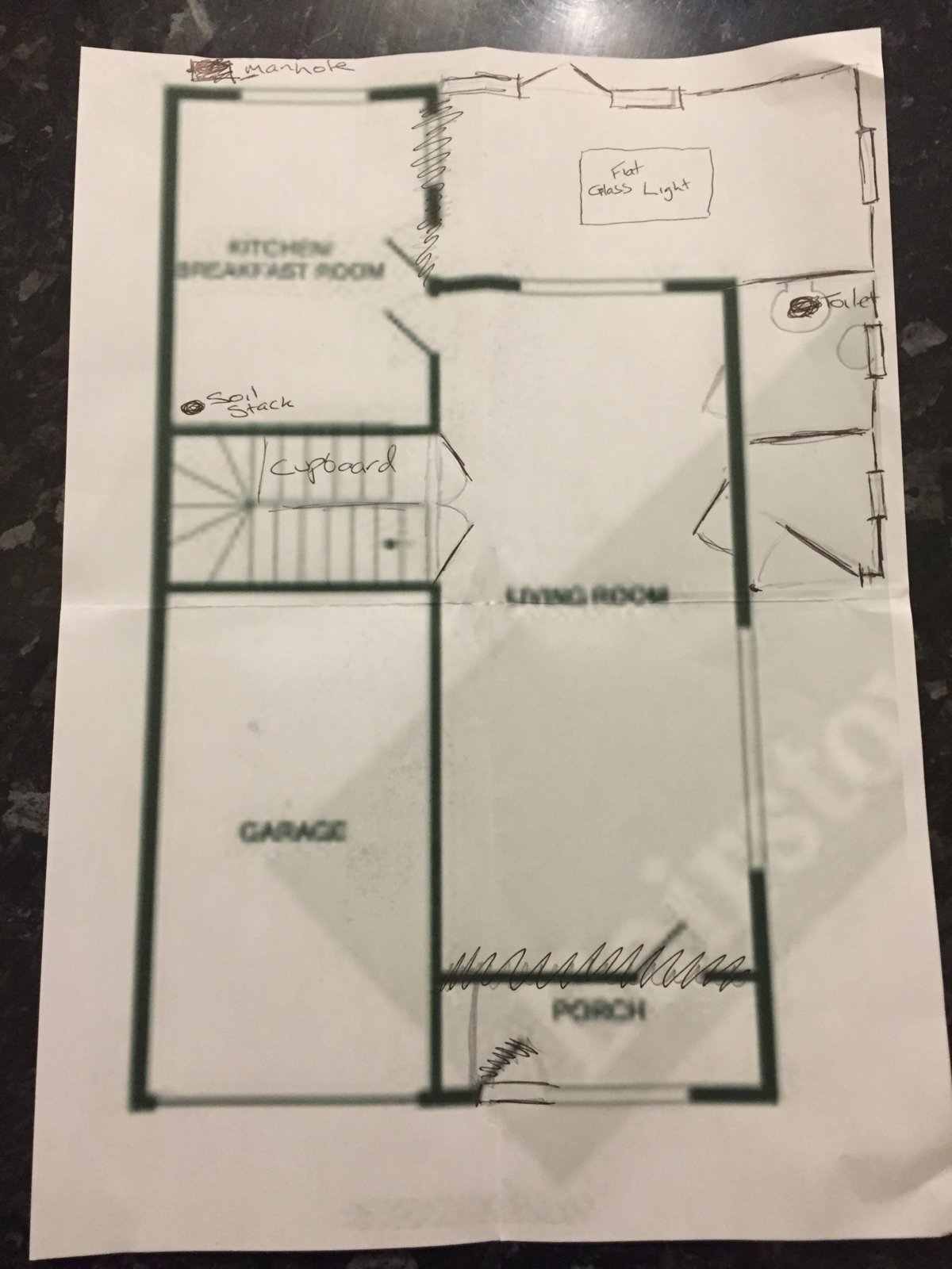

Thanks for the reply tomfe,there isn’t much choice on toilet locations due to the awkward layout,other than sticking it under the stairs so it backs onto the current soil stack but that is still into the living space. I’ve attatched a better picture of my planned layout so the porch has a side window with a half glazed internal door for light and bathroom has its own side window,the Proposed living extension would either have French doors and side screens and window onto the side or just large French doors with window onto the side. I am also thinking of a flat glass skylight in the centre of the roof,the sun is around the front for half the day and the patio door only gets sun right at the end of the day
The main benefit of this layout is that we wouldn’t have to walk through the living room to get to the stairs or kitchen from the front door

Toilet off the living room ,no surely not! How about getting an architectural designer to come up with some sketch scheme layout?
'The main benefit of this layout is that we wouldn’t have to walk through the living room to get to the stairs or kitchen from the front door ' - but you would according to your sketch as far as I can see !
