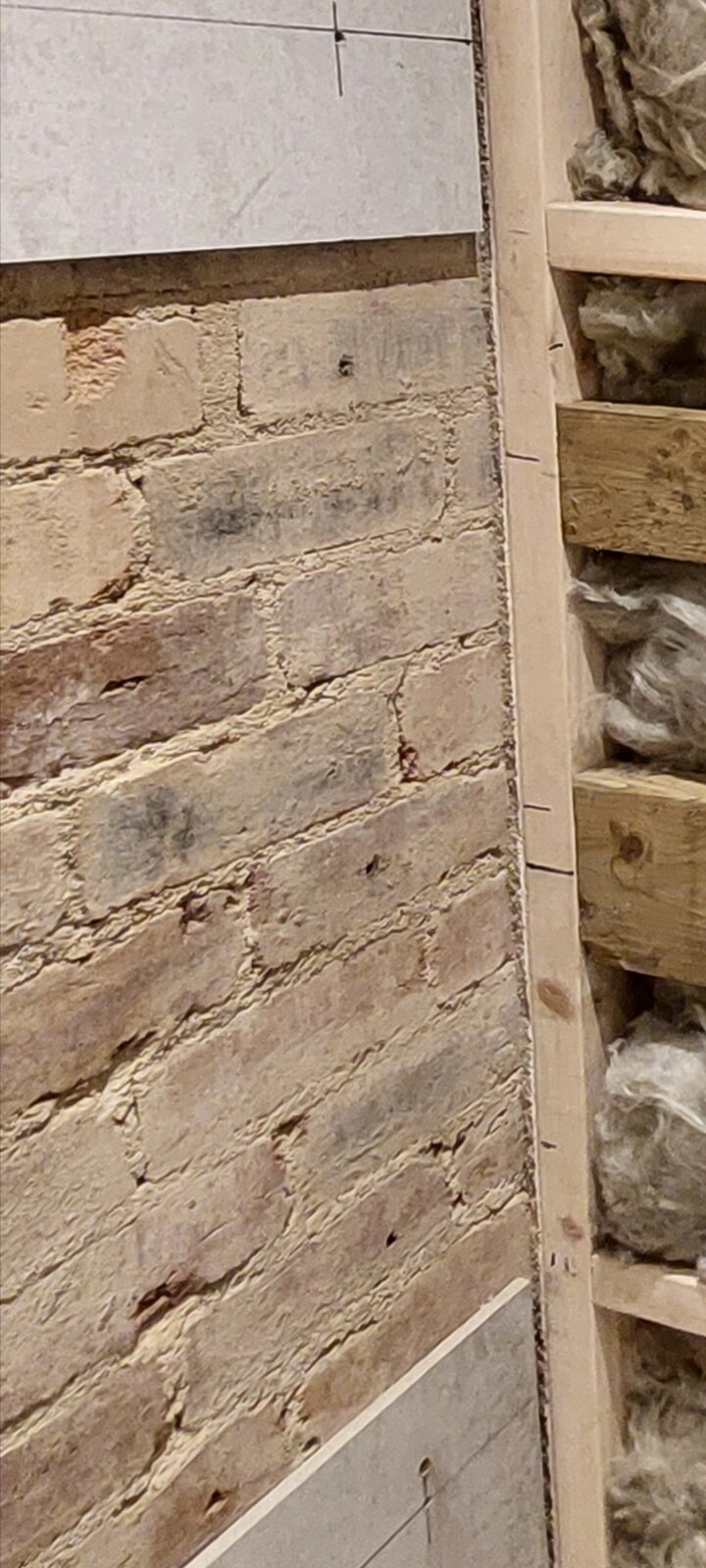

If you have the cement boards already, photo shows one that I did before where I stripped the plaster off and glued and fixed the cement board to the walls, no regrets about this, the finished tiling surface was solid and was flush with the other plastered parts of the wall and left perfect spacing for a tile trim at the edge of the tiles.

Right makes sense. For now I'll definitely get all the plaster off and I'll see what I'm dealing with on the rest of it.
That looks good. I have to say though the state of your bricks and pointing looks much better than mine though :mrgreen:
