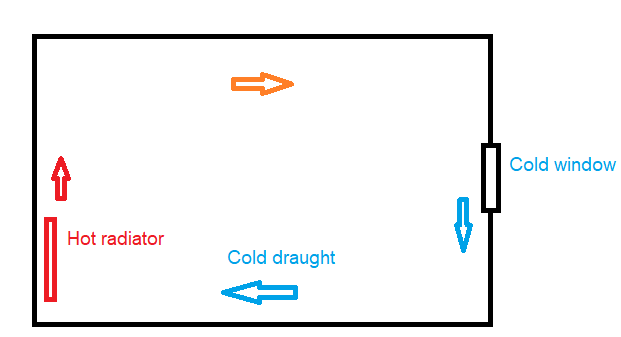

a radiator the width of the window may look more pleasing to the eye
it can be lower or higher, double or finned if you want
but it does not need to go under the window at all. If it does, you can't fit long curtains.
the old 1960's style of sending heat out through the window, to warm the birds or the cat sitting on the windowsill, is uneconomical and not necessary.
The trick is to mount the radiator a couple of inches from the wall. Then the curtains can be pulled shut behind the radiator. The curtain then provide some thermal insulation to keep heat from reaching the window and direct the heated air into the room.
Needs a pair of non standard mounting brackets but can be worth it to avoid convection driven draughts
ah, the old days of draughty, single glazed windows with no lined curtains, when cold air ran off them like a waterfall.
Once you know the minimum size then fit the most aesthecticly pleasing size to the eye and decor
