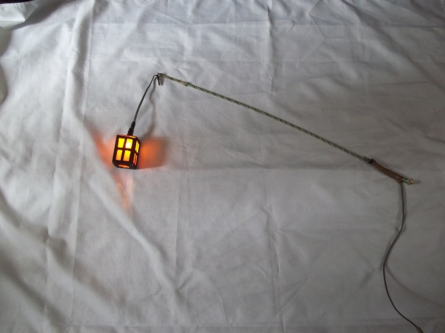

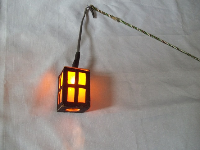

This is one of the lanterns I made in 1985 and this was the trigger that started my daughter thinking about Dad doing a special "super wow" lighting install for her wedding.
The lanterns were for my daughters ( toddlers at the time ) to carry at the village firework display with a battery pack in their pocket. They thought they were just for fun but the real reason was that we could spot where they were in the crowd.
