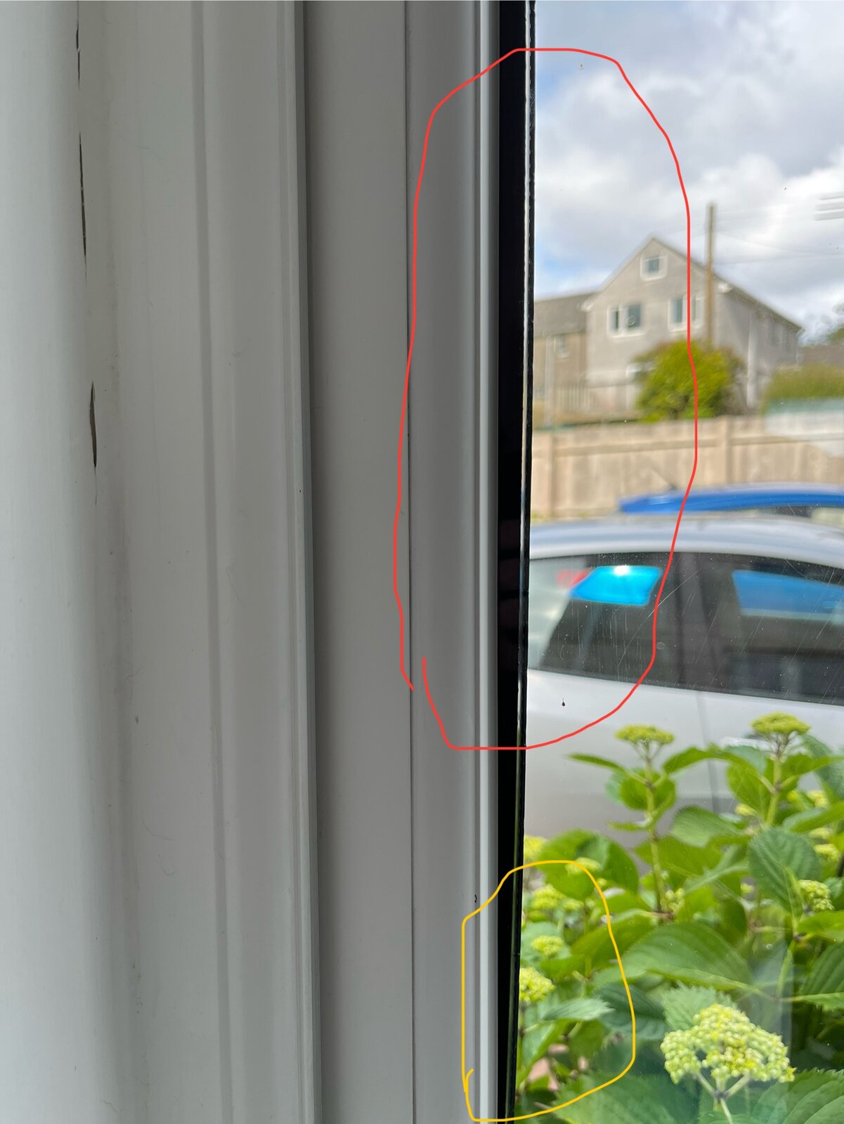

Hi
Not really sure how to describe what is happening. Picture is attached. The seal of the unit appears to be bowing about half way up the frame on the long edge for some reason - any ideas why. I guess it might be necessary to replace the glass?
See it all the time. Even my own house has units like it.
I don't know why. Don't seem to cause a problem only how it looks
So I've been told it's too much desiccant crystals inside the spacer bar, see it quite often on my travels and it usually means the unit is on borrowed time
Maybe @ronniecabers can shed some light on the cause

Thanks very much for that - I suspect it will be temperature related and will result in replacement of the unit.
It certainly won't get any better! I'd normally say too much dessicant in it if it's aluminium bar , if it's black ' swiggle strip ' I'd say age , temperature and thermal movement
I know you are saying yours has become bowed, but also they tend to get made bowed, I believe it happens when the hot melt is run round it pushes the spacer inwards towards the middle of longer units.
I guess it because of the floppy warm edge spacer bars these days
If the right pressure has been applied, and the secondary sealant , then there should be no bow at manufacture...poor sealing technique if there is
