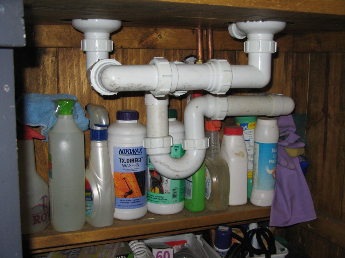

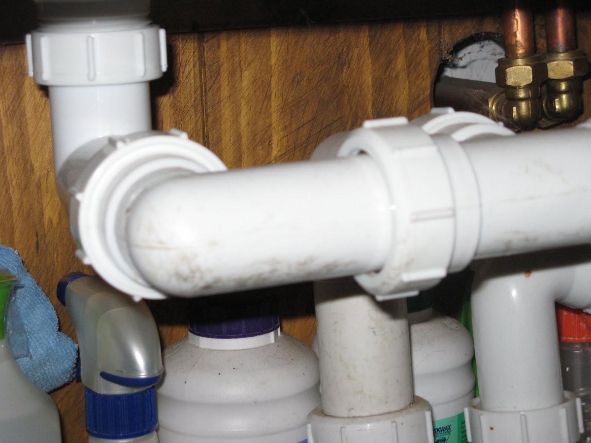

If your pipework is compression anywhere, or even worse: pushfit, you could end up in a right mess!
Hmmm... and that I wouldn't want!!!

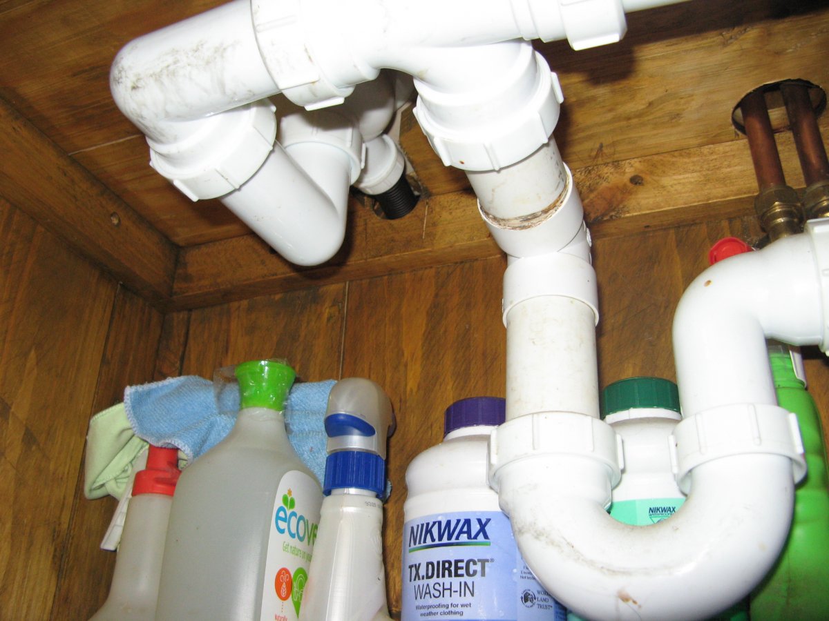

If I took a pic of the pipes under my kitchen sink, would you (or anyone) be able to tell if they are compression/push fit just by looking?
Thanks for the reply.
Yes, but it's the ones you can't see that matter. Send up some photos anyway and we can get a good idea of the install!
I'd take your sink trap out and give it a good clean with fingers/old toothbrush and dishcloth pulled through a few times. If it's all scaled up and rough surfaces inside, then put a new one in!

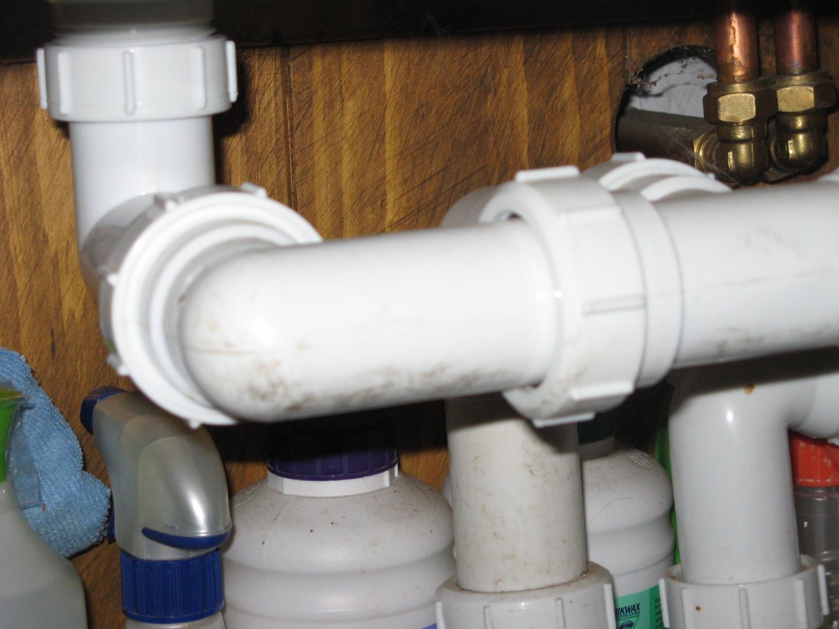

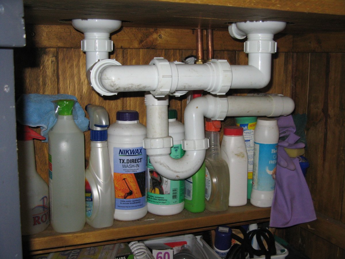

OK, here's some pics....
I would be happy to remove the trap and clean it, but I always worry about stuff like that in case when I put it back I don't do it properly and cause a leak. Perhaps once the photos have been looked at someone can tell me whether removing and re-installing the trap is easy in my set up.
Thanks again
Max
I tend to tackle blockages like yours with a wet vac. Remove and clean the trap. Use the wet vac on the pipe where the trap connects. Try and get a good seal either with your hands or by using something like blu-tac. A good suck should clear most food/fat related blockages. You can get a decent wet vac from Wickes or Screwfix for around £50, which is less than I'd charge to do the job. Make sure first that the slow running sink is not due to the blockage of a gulley or sewer further downstream. That would need tackling first.
As for removing the trap, put a bowl underneath, undo the compression nuts and pull apart. Leave the nuts and washers on the pipe. When reassembling, be careful not to cross threads and do the compression nuts up firmly hand tight. Run water slowly and check for leaks. If ok, put the plug in, fill the bowl and then empty sink again checking for leaks.
Another tip... when reassembling compression waste fittings... do them hand tight, run hot water down the plug hole and then give all the joints another turn by hand and you'll likely find that expansion from the hot water passing through them will allow another 1/4- 1/2 turn on each nut.

Thought I'd write back to update. I took the U bend off and cleaned it up. But then I couldn't help myself and started to take off other sections bit by bit and gave them all a clean up. Everything went back together, I've been keeping an eye out for leaks, and so far everything is fine and dandy :)

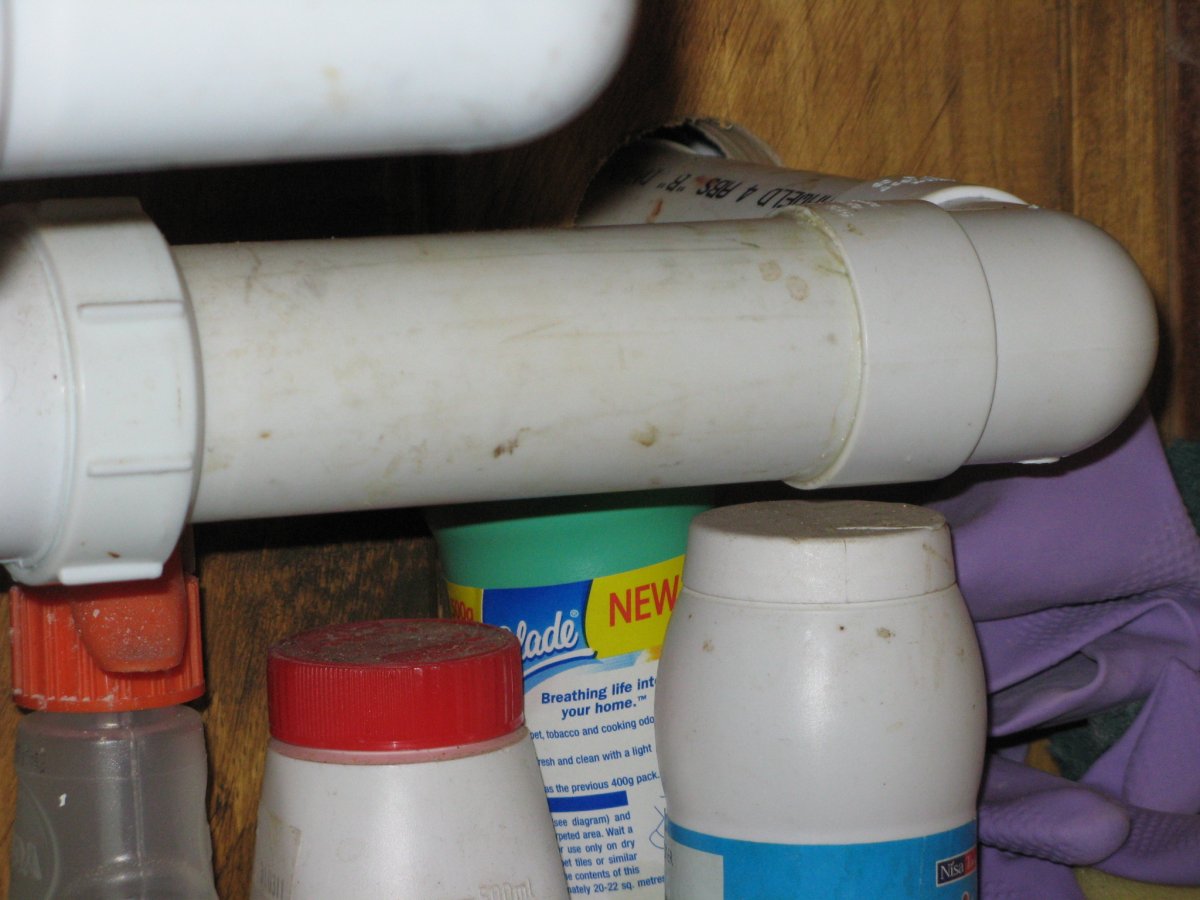

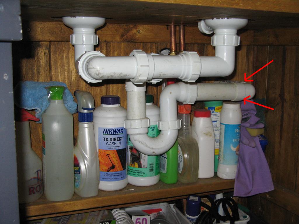

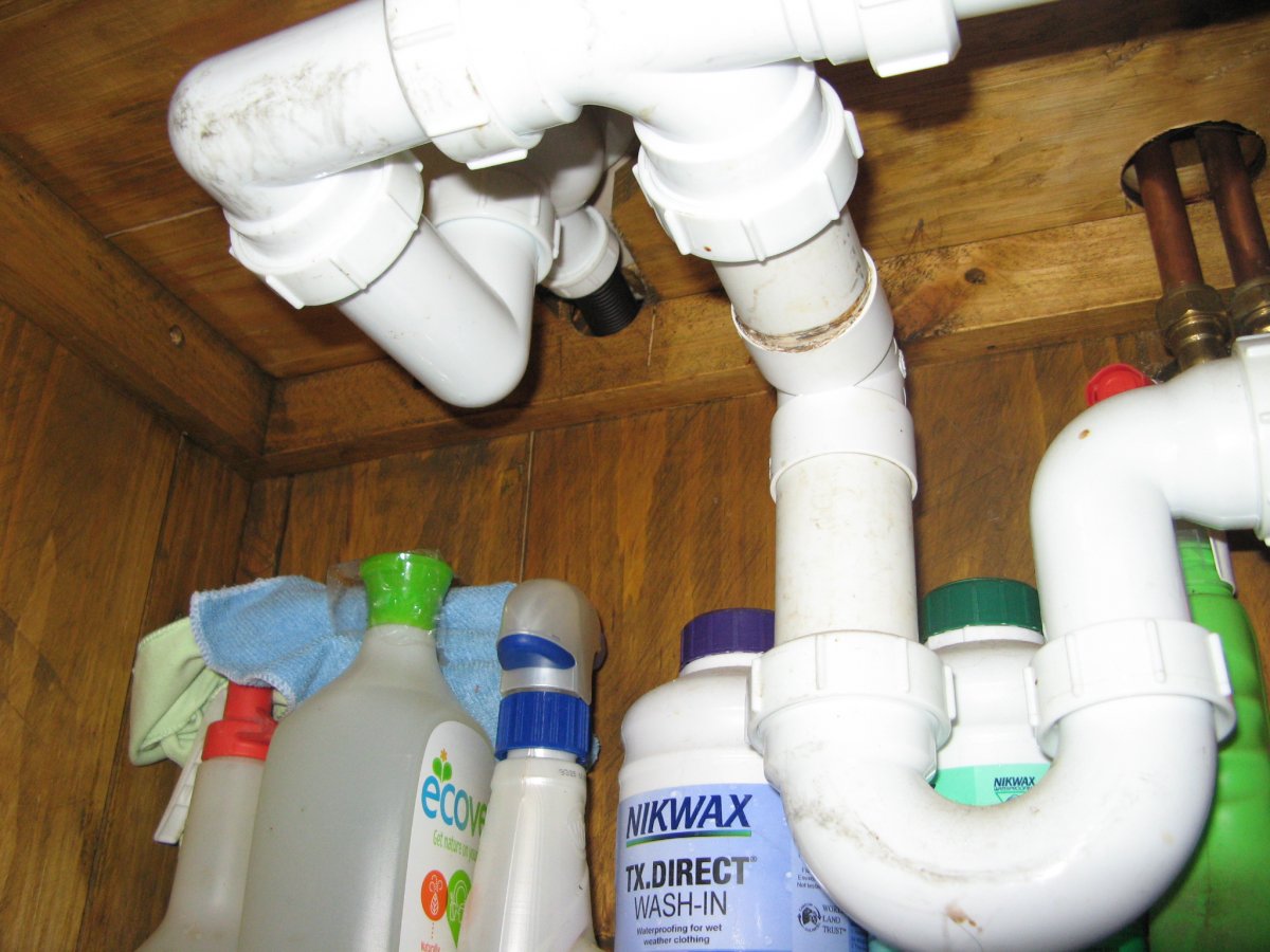

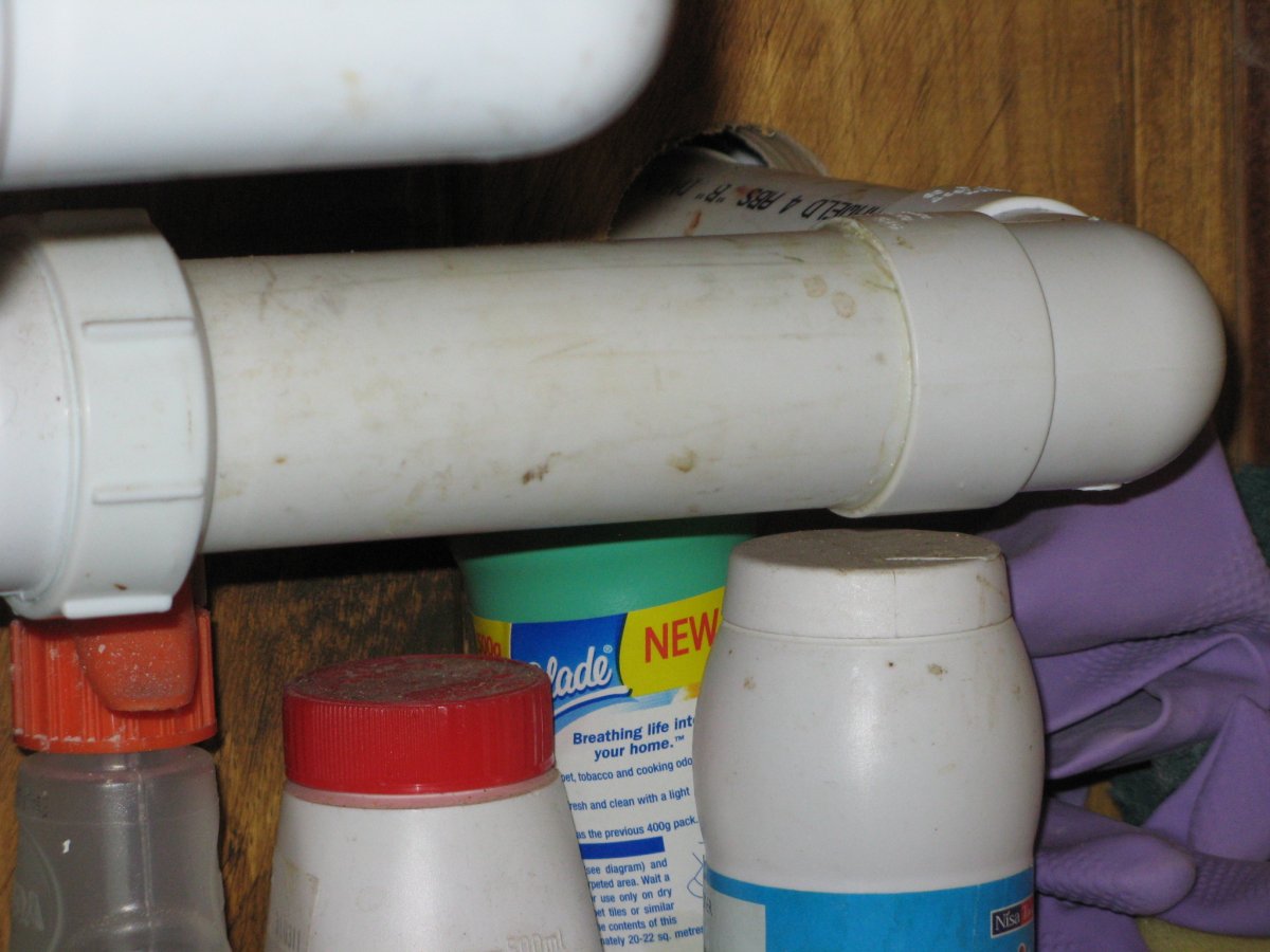

The one part I couldn't get to properly was this:

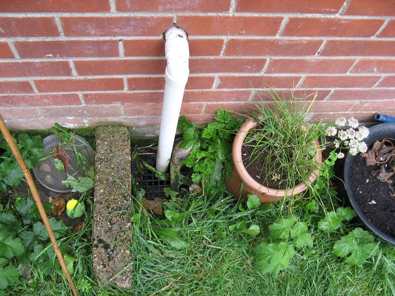

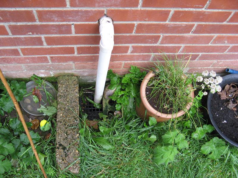

Sorry to be so novice-like, but what are those kinds of fittings called? And how do you get them undone (and done back up again, water tight)? Would be nice to be able to clean that section manually, and also, the pipe outside has the same fittings and I'm quite keen now to get that apart for a good clean:

Those fittings are solvent weld and are glued together therefore it isn't coming apart, it would need to be cut out.
