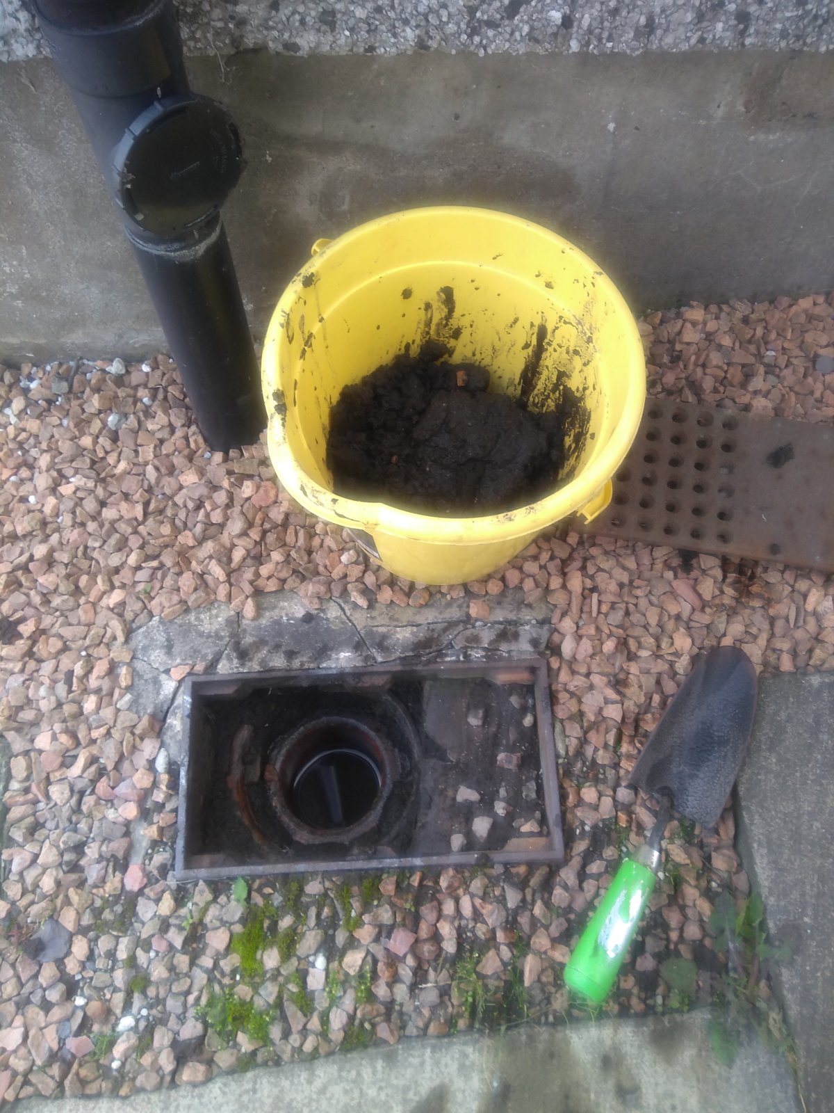

I removed a drain cover just next to a plastic down pipe and found that it was full of soil (see picture attached). I wasn’t sure if the soil had collected in the gutter over the years and had been washed down or whether it had been deliberately placed there.
I excavated the soil that was sitting in the drain and discovered that the drain seems to link to the plastic downpipe as about 18 inches/ two feet under ground level, there was an opening facing the plastic downpipe. I also filled the drain with water and found that it only drained as far an an opening.
I have two questions. We’ve been in this house (a Wimpy late 60s build), for 14 years and haven’t had any drainage problems. Is the drain (that was previously packed with soil) serving any purpose? If not, should I just replace the soil (or fill it with pea gravel), on the grounds that if ain’t broke don’t fix it or leave it empty?

From what I think I can see in the bottom of the hole, it connects to the fall pipe directly adjacent to it at the top of the picture. What is the fall pipe for?
What did you mean by - "I also filled the drain with water and found that it only drained as far an an opening."?
What opening is that?
The pipe and water should flow briskly away and into a manhole, is there a manhole inspection cover in the area?

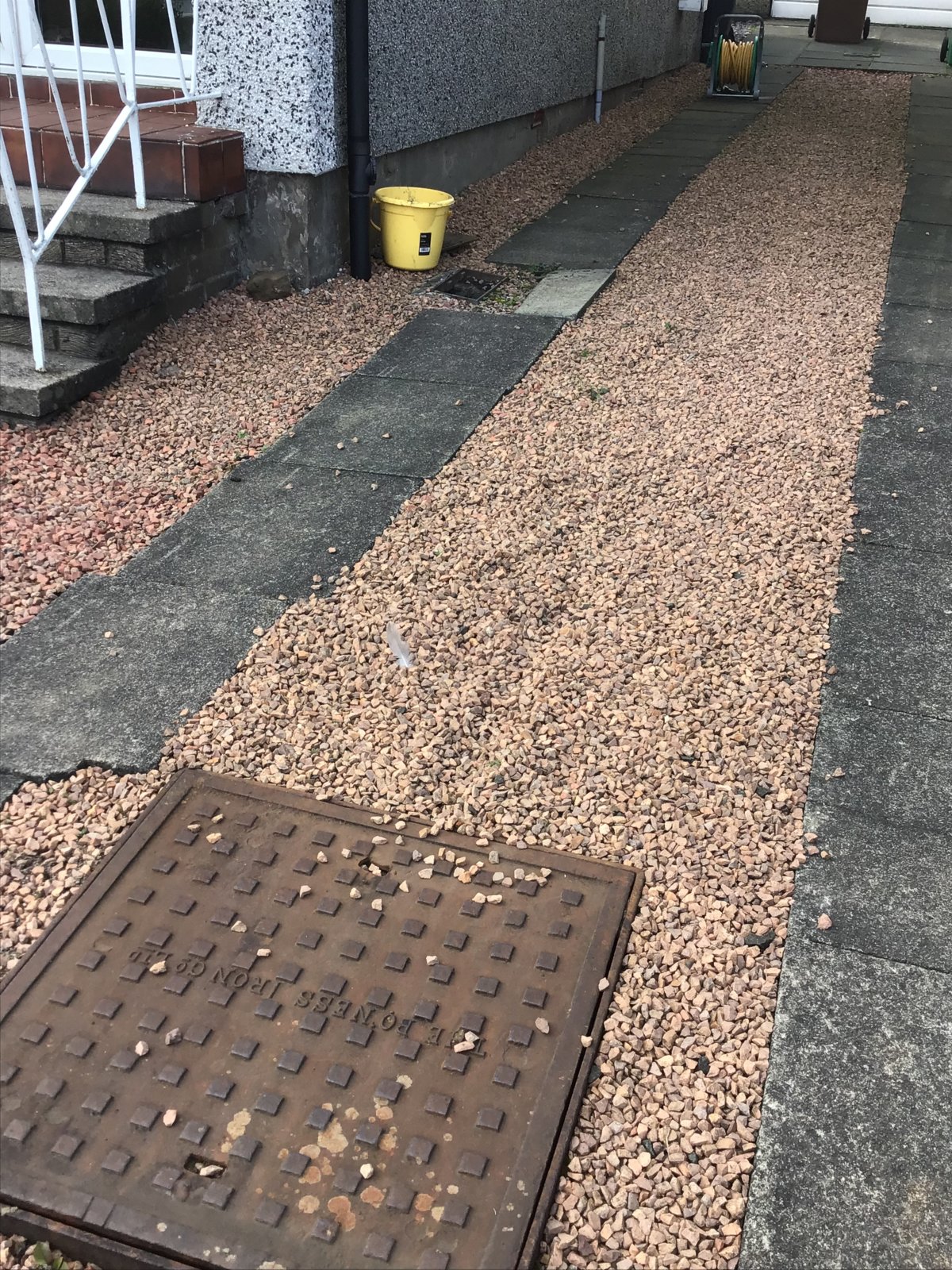

Beginning to wonder if it’s a redundant drain (which might explain why it was filled with soil?). I’ve run a hose again and the water is just lying. There is just one opening in the excavated pipe and this faces in the direction of the house wall where the plastic downpipe that collects rainwater from the gutter is clipped. Can’t see any manhole covers other than the big one on the picture where I've previously seen flowing water when the kitchen sink has been draining.

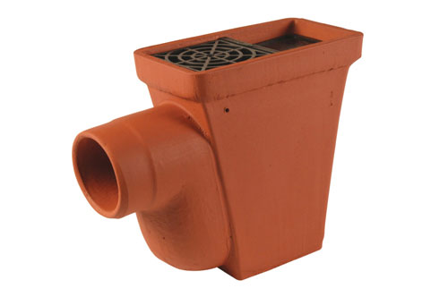

Looks to me like a 'Back inlet gulley'. Opening towards the house is the connection from the downpipe in the picture, bringing the rainwater down from the gutters I assume. The pot should have a certain amount of water in the bottom, this acts as the trap, sealing off the gulley from the sewer, and preventing any odours escaping. Pot may look something like that in the picture, you wont see the outlet as it's buried & not visible unless all the water is removed.
Many thanks. Yes, that’s what it seems to be. I was surprised at the amount Of soil in the gully. It was full to the top of the cast iron cover. It was almost as though it had been filled in deliberately. Having said that, when we cleaned our gutters we couldn’t believe how much soil had collected. There were even weeds growing. Don’t know how it gets there.

fwiw: the clay gulley shown in the pic above looks like a P-Trap gulley not a BIG back inlet gulley
