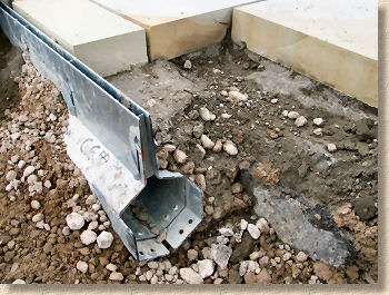

I wonder if I could get away with a drainage slot network. The flags lay on top of the ground, but a network of drainage slots are placed between the flags. Something like as shown in the picture. There may be inexpensive plastic product offerings. Or maybe one could home-make something.

Where will the water making its way into these slots go? Magically disappear? I will say again that the volume of water coming off 40sq/m of paving is considerable. It will not simply soakaway naturally.
The system in your picture is a stainless steel brick slot but that simply gathers the water like an aco channel and then drains it to a gulley somewhere for removal.
You need to either use a good sized soakaway buried or run to your surface water drainage system. Piping it to the nearest gulley or manhole will not be expensive, if you can post a photo or sketch layout of the paved area and your gulleys and manholes in the garden we can help.
