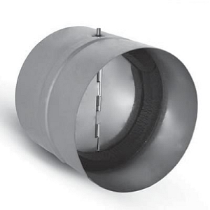

Apart from a cowl vent, the kitchen extractors I've had, have come with backdraft shutters; something like...
Do you know if you have one?
Sometimes they can get a little gummed up with grease and stick open - it may be worth investigating?

Not sure if the installers fitted one when we had the kitchen fitted and the ducting is not easily accessible (it's in the wall cavity) between the cooker hood and vent (about 3 metres). If we have one, It's definitely not next to the cowl vent so not going to be accessible. But I'll have a look - Thanks.
The cowl vent usually has a large backdraught flap. Is yours stuck, or broken off?
It is possible to make it hang more closed by supergluing a 2p piece near the bottom. Cooker hoods are quite powerful so will easily push it open.
Is the duct properly sealed to the wall, and to the vent? Maybe a draught is getting in through gaps.
D'oh - apologies. My bad. Yes, of course, the backdraught flap is attached to the vent. The idea about gluing a 2p coin to the flap is a good one. Let me try that - it'll probably do the job!
