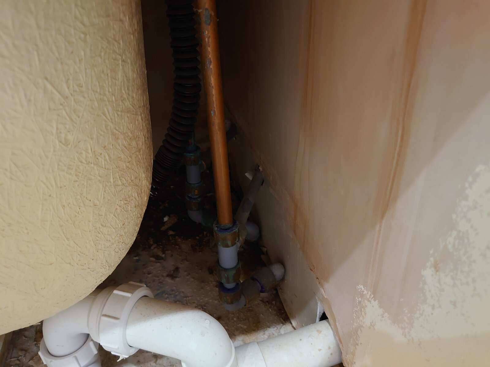

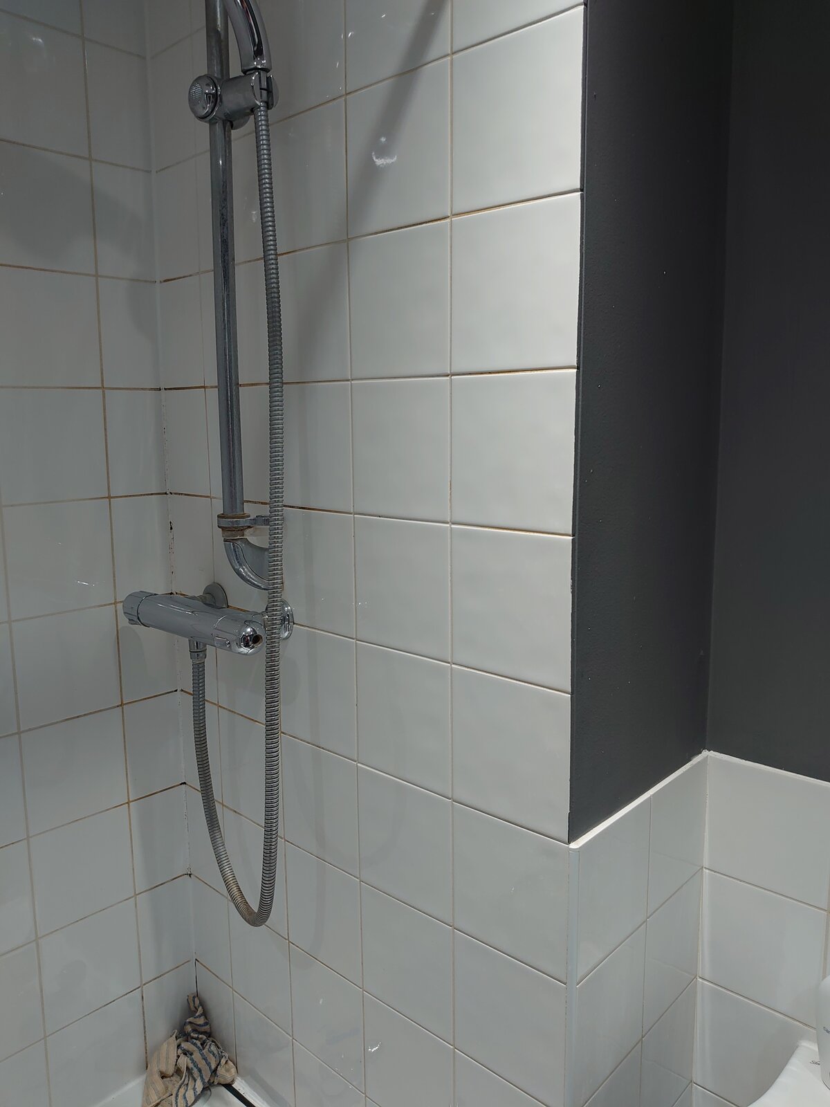

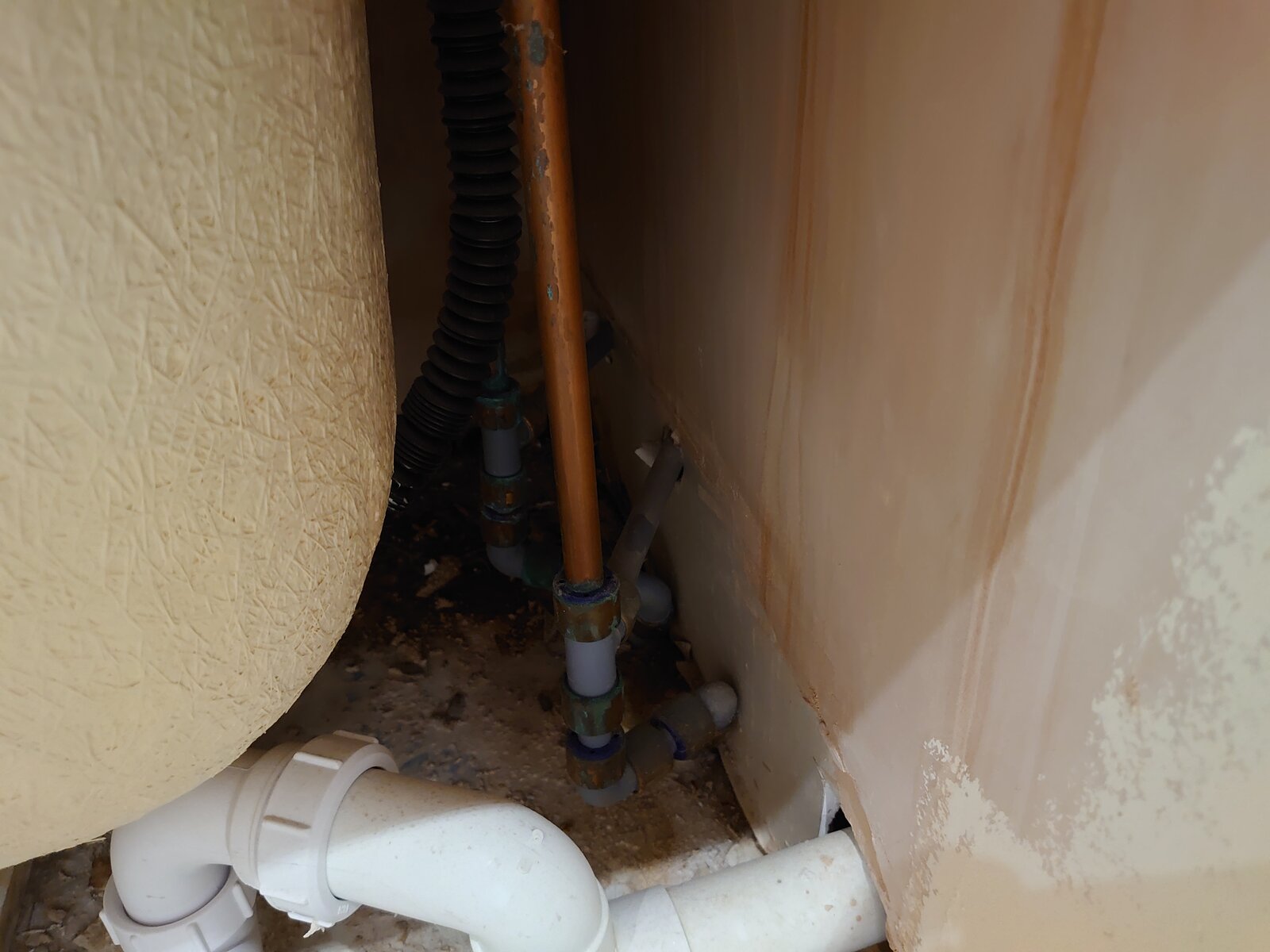

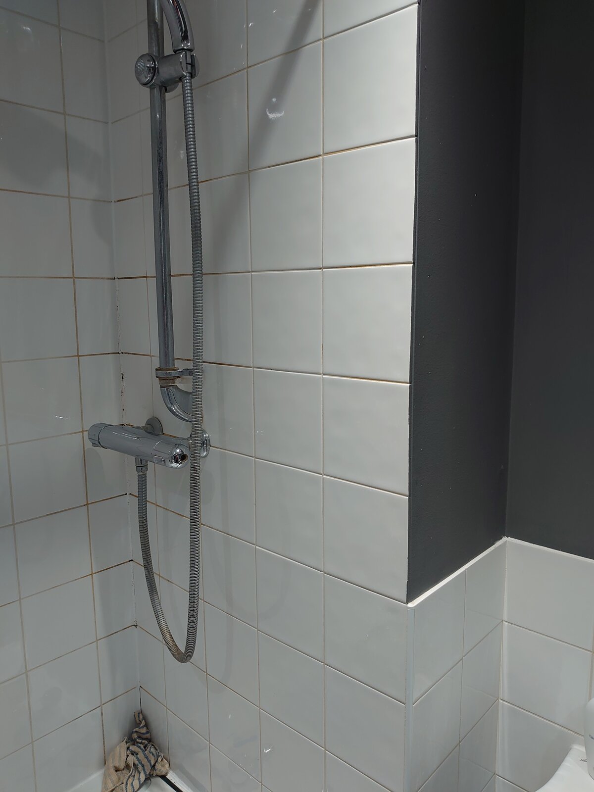

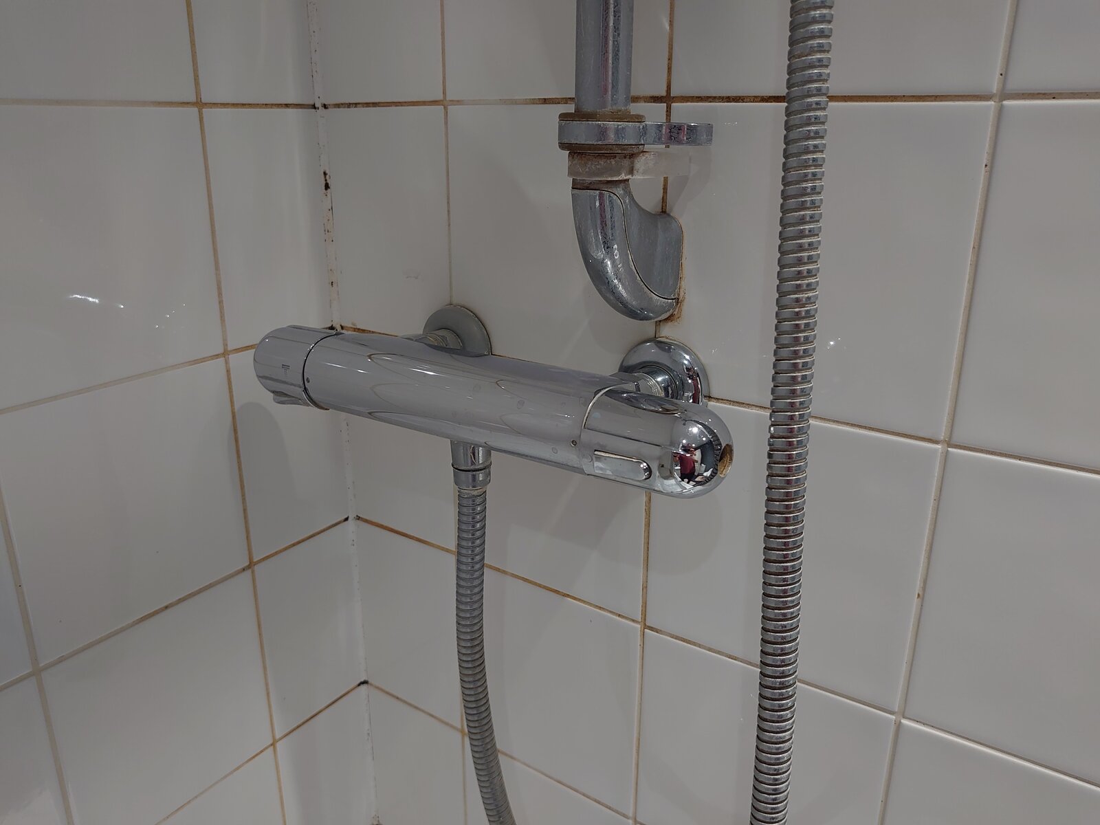

Hi, as per title I've recently discovered a dripping noise from behind my shower bar in the boxed in section. I've attached some pics to help. From what I can see the feeds to the shower are flexible pipes taken off the bath tap feeds. It only drips when the shower is on and then gradually stops when you turn the shower off. It's mains pressure fed from the combi boiler. Obviously I'd rather try and fix it myself if possible. I was going to remove the shower bar and see if there is anything obvious amiss. I guess the only likely cause is the joint from the flexible pipes behind but wasn't sure if this is accessible. I could potentially also cut away the plasterboard underneath the bath to see how wet it is at floor level. My main concern is that it's something that isn't accessible without cutting part of the wall away. Any advice or suggestions would be much appreciated.

You could isolate water supplies to it ,and remove the bar from the wall.
Remove the chrome covers and See if any signs of water ingress behind tiles.
I took it off and no sign of water leaking back.

Can't see much of your waste pipework in the pic you posted ,just heads into the plasterboard. Is there clearance around it at that point ?
Doesn't seem to be a leak on your supply pipework though.
Yes there is clearance. That's the end wall that the shower is fixed to above. I assume the bath waste T's into the sink waste pipe which would come from the right and then join the main waste pipe to the left which would run vertically. If I go into my bedroom which is the other side of the bath the sound can be heard clearly from the corner, so definitely within that boxed in void.
