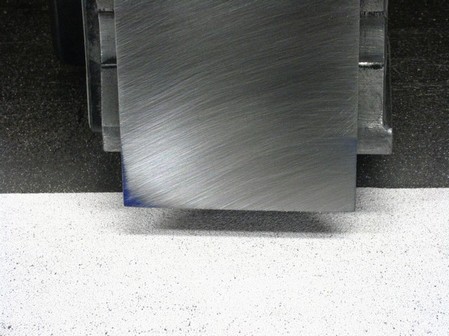

I'm trying to flatten the back of a new plane iron with 120 grit sandpaper on glass but I keep dubbing the edge so could someone tell me what I'm doing wrong. I though it was because I've not stuck the sandpaper down but I've read people are having the same problem when they stick the sandpaper down.

Left hand corner?
No idea what that is without seeing it.
What make is the plane?
Some thoughts off the top of my head =
It's almost as though you are putting pressure on that corner when you are flattening the back. Do you always lead with that corner? (Question based partly on the direction of the scratch marks). I have a tendency to make more of a fore and aft movement when I flatten chisel backs, although I use a diamond hone (which is basically a 5mm steel plate). Also, what thickness of glass are you using and what is beneath it? Your glass (which should be float glass) will need the support of a thick and inflexible piece of plywood or MDF if it is less than about 10mm thick - thinner gkass really can flex.

I'm using 10mm float glass resting on my hop up. That's not my plane iron in the photo but it's the exact problem I'm having so maybe I'm using to much pressure. What diamond plate do you use as the two I have are rubbish.
How do you know its the exact problem?
Now that you've revealed its not your plane iron I can give my opinion on the dark spot.
Which is most likely a "heat spot" caused by a machine.

The dark spot is blue marker pen from where the iron is dubbed over and the sandpaper is not touching. Have you got a link to the grit you use.
Then its a low spot. A twist in the iron? Bad quality manufacturing machining?
Probably a low cost iron. Chinese?

I use ITS diamond hones. Relatively cheap but serviceable without costing an arm and a leg - after all joinery isn't keyhole surgery, is it! I use a paraffin-based industrial lapping compound to "float off" the swarf and keep the diamond surfaces clean (never, ever use water - it encourages rust) - real paraffin will do just as well, but is an awful lot niffier. Note that you don't need to flatten the entire back of the iron - the bottom 1 to 1-1/2in up from the cutting edge is sufficient. You can check the cutting action by wiping the iron clean, blacking the back with a large chisel tip marker then doing your flattening. That will tell you what isn't flat (it shows up as still black) - and not all plane irons are flat. The process can be repeated several times but that 120 grit alox paper you are using is fairly slow working, so if after the first couple of strokes you have an unground area it may be that you need to use a coarser grit to get it flat first.
If you go away and do that and come back an post a photo it may be possible to tell you where things are going wrong
BTW, what is the history of the iron (new. old, been flattened before, first time, etc)? Is this the first time you've ground it? What grit did you start with?
Edit: There have been additional responses whilst I was writing this, so, it looks like the cutter has a thin spot. The only way to deal with it is to use a coarser grit (say 40 or 60 grit in a carborundum or silica carbide paper) and flatted with that first before working up through the grits.
