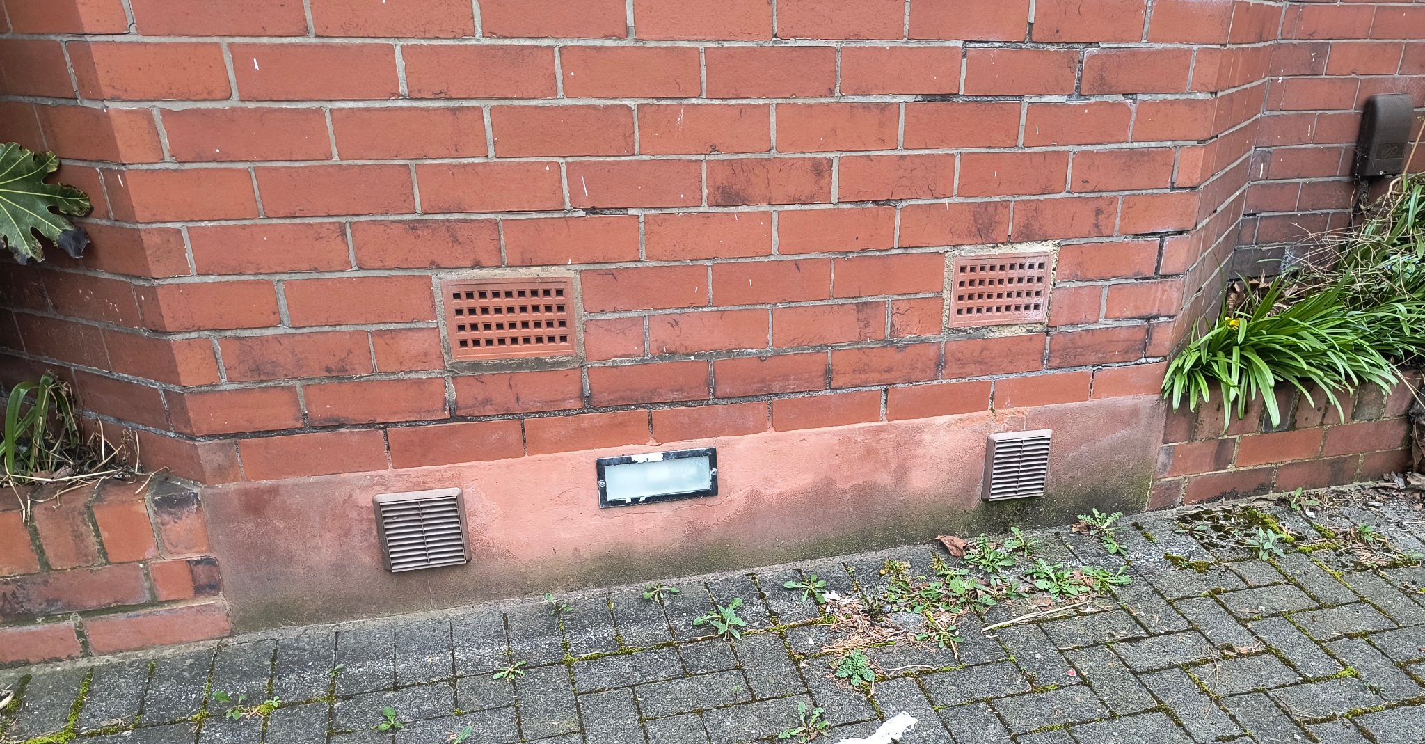

We are currently renovating our ground floor and adding an extension on.
We currently have a thick concrete sub floor in the existing house as was built in the 80's, with no insulation, that we are taking down to then build back up, adding celotex 90mm and 65mm screed with UFH too which will match the new extension that the room will be part of.
We have been advised its best to duct the hob fumes/moisture out of the house, rather than recirculating, due to also having a wood log burner in the room and a MVHR, but have seen a lot of reading around the best way to do it.
My two main questions are (but will take any extra advice!)l
1. What happens to the moisture that condenses and can 'pool' in the duct if we're going vertically down through the island, through the floor under the island (beneath screed and insulation), underneath the floor to the external wall (approx 3 metres from duct entry) and vertically back up and out of the external wall?
2. Does the duct run under block wall and up through the cavity (then out the brick wall below DPC) or behind what will be tall kitchen cabinets?

Any condensation will evaporate. Especially with underfloor heating. Personnely I would take it on the surface, not in the cavity, above the DPC as you probably won't know at this stage what your outside ground level will be. Use flat ducting.

Thanks for your advice, when you say surface, is that as in above insulation or do you mean the surface of the wall?
The suface of the inner or the outer wall, Staright through the cavity not in the cavity as you suggested then any riser that is needed on the inside or the outside which ever is easiest to access once any cupoards are fitted. I would have thought the depth it's set into the floor will be goverend by your underfloor heating.

thank you, and would you cut space out of insulation that is on top of the concrete subfloor, or cut out of the sub floor and keep insulation in tact over the top?
Probably set it into the celotex as its easier than channeling the sub floor.

as we're already having to take some of the very thick subfloor out due to no insulation and then build back up, would it be worth whilst we're there to just channel out the extra space for this ducting as to not have any spots with less insulation?
Why does it need to come back up? Is your external ground level too low?
You should do it in 4" soil pipe. I have two x 5m runs, not for an extractor but because I have a gas tumble dryer - one is an air supply and one the exhaust. They go down and straight out. You could easily lower the ground level locally if necessary.
If you wanted to come up and through the cupboard and do a lot of steamy cooking you could fit a drain at the bottom of the pipe.

Your choice but can't see it makes much difference.
