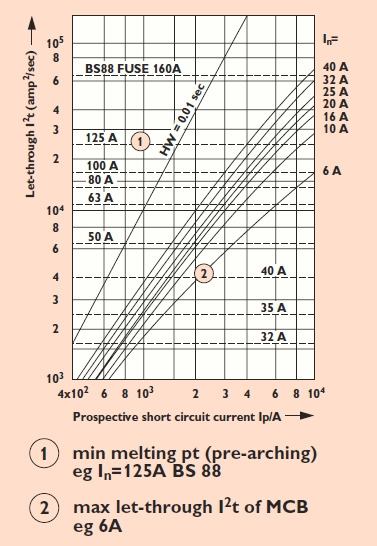

I remain pretty confused about this 'let through' business, not the least by the 'let through charts' to which you have referred. I presume you are talking about something like this (Wylex) ...

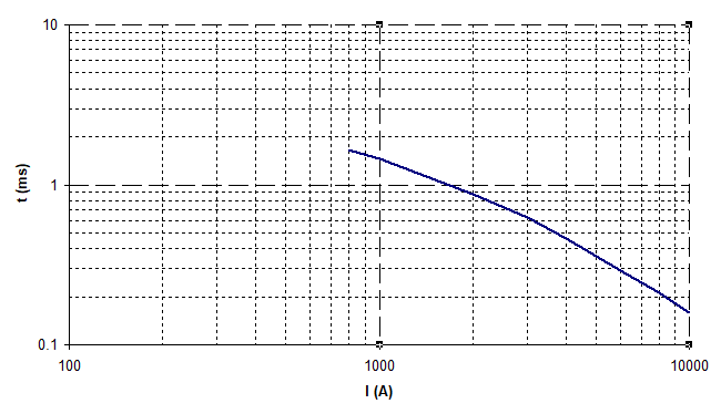

For a start, I still don't see why there is a need for these charts to be in an 'unfamiliar' format. Since we've been talking about a B6, I've done my best to read figures off the 6A curve in the above and, once I had done that, it is a trivial exercise to turn it into the 'familiar' "t vs. I" characteristic curve format, namely ...
You will see that, even at 800 A, t is only about 1.6 ms, and when the current gets up to 10,000 A it is down to about 0.16 ms (i.e. 160 μs). I have to believe it but, in view of my previous comments about 'mechanical factors' etc., I'm pretty surprised to see that an MCB can disconnect that quickly.
However, the main thing is that I cannot find any evidence that the PSCC is anything other than what we would expect it to be, nor that that chart is presenting anything other than the characteristics of the device - so, with reference to you comment above, not related to any particular LV transformer (or anything else external to the device).
On the other hand, if, despite the absence of any mention of it, the 'PSCC' in Wylex's 'chart' is meant to be something other than Uo divided by the ('worst case') relevant fault loop impedance, we're back to square one, even with the 'chart', since we don't know how to determine that 'PSCC'.

As you say confusing, in the main MCB's and RCBO's are either 4.7 kA or 10 kA rating, all we want to know is if a 100A BS88 fuse is fitted will the let through amps exceed 4.7 kA or not so as the installer I know if I can use 4.7 kA rated devices or not. I really don't want to have to read curves.
As said only once have I measured the PFC of an installation and found it exceeded 4.7 kA, I mounted a BS 88 fuse holder and fuse inside the enclosure, but could not really work out if it did or did not now comply, however the resistance of the fuse resulted in the PFC to now be under 4.7 kA so no worries.
With a 100A BS88 it says watts loss 10W so 0.001Ω, need 0.05Ω to be under 4.7 kA at 230 volt, however how accurate is a loop impedance meter when measuring 0.05Ω? For 10 kA 0.023Ω but meter will measure 0.02Ω, I have never measured a loop impedance anywhere near that low on a domestic. For a 500 kVA transformer looking at 0.0166Ω so plus BS88 fuse and some cable it is unlikely to be lower than 0.02Ω.
As you say confusing, in the main MCB's and RCBO's are either 4.7 kA or 10 kA rating ...
Where does 4.7 kA come from? I think all the 'standard' domestic MCBs/RCBOs I've seen have had a breaking capacity of 6 kA.
... all we want to know is if a 100A BS88 fuse is fitted will the let through amps exceed 4.7 kA or not so as the installer I know if I can use 4.7 kA rated devices or not. I really don't want to have to read curves.
Yes, that what (and all) we need to know. The concept of 'let through amps' doesn't really exist - the only way a fuse can influence the fault current is by the resistance/impedance it adds to the circuit, and if that is sufficient that the PFC falls to below the breaking capacity of the MCB, then that is obviously fine.
My understanding is that the 'dispensation' to which you refer (when theoretical PFC exceeds the breaking capacity of an MCB, but there is a BS88 upstream of the MCB - as per the 'dispensation' for domestic CUs) is more complicated than you suggest, and a while ago we considered a theoretical article which went into this in some detail.
