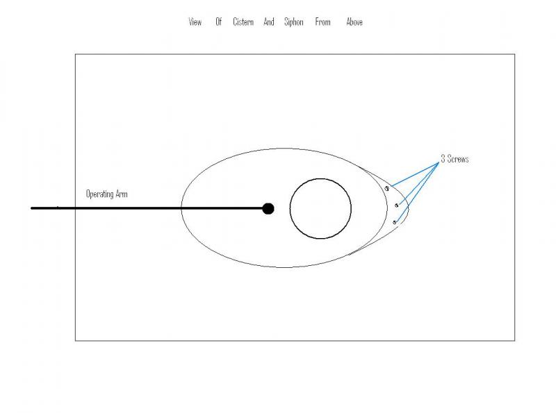

My shop has a very old high-level cistern, made of rubber I think. The supply and flush pipes are lead.
The diaphragm is split, as the chain takes a lot of pulling to flush. Most siphons need to be completely removed to replace the diphragm, but I don't really want to disturb the lead flush pipe, as it has many layers of paint, and hasn't been disturbed for decades. I forsee many more problems.
I notice that the plastic (i think) siphon fitted has 3 screws near the base inside the cistern. If I remove these screws, can I split the siphon and not need to disturb the joint under the cistern?
My shop has a very old high-level cistern, made of rubber I think. . Most siphons need to be completely removed to replace the diphragm, but I don't really want to disturb the lead flush pipe,
Try the screws but don`t hold your breath :cry: . you might find though - that the syphon plunger will come out without removing it all - even undoing the flush pipe isn`t really a problem - the paint will just flake off the lead . nothing else
Sorted. Removed the 3 screws, and the top comes off the siphon. Turns out it's a Dauntless siphon for a wellbottom (rubber) cistern.
New diaphragms are available online, they're the circular ones, with a circular hole in them that fits over the siphon tube in the cistern.
Many thanks.
Thomas Dudley Dauntless Rubber Well and Rubber Line (now superseded by the Tri-Well) cisterns usually had D shaped syphons and so needed a D shaped washer, not circular.
