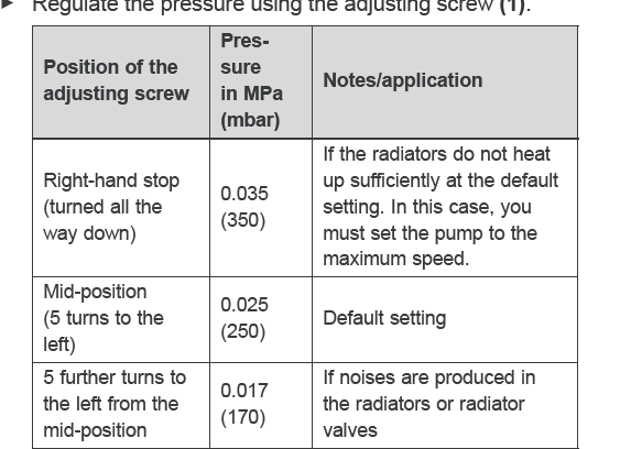

The default setting of the internal bypass is set by default very low IMO at 2.5M, I wouldn't mess around with it just yet, the pump speed also has to be set to 100% if you increase it to its max of 3.5M.

If you screw in the bypass valve, making it require a higher pressure to trigger (not that i'm going to, just out of interest), then why do you need to set the pump to 100%?

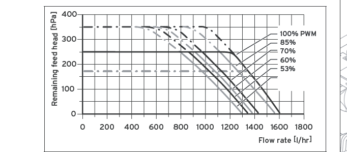

I see your point re having to increase the speed as it actually makes the bypassing worse with reduced flow, if the pump is at its default setting of 70% and the bypass is set to 3.5M then the by pass shouldnt begin to open until the flowrate reduces to 880LPH , 14.7LPM but if set to 100% speed then it will start to open when the flowrate reduces to 1000LPH, 16.7LPH, these settings seem a bit rediculous to me as a head of 3.5M even after a Hx is regularly required for even modest systems of even 6 to 8 rads.,

What are the downsides of making the bypass harder to trigger but not changing the pump speed and leaving it on auto? The manual seems to advise against this.
I don't really know what 15% refers to, it may be that 0 to 100% range is 53% to 100%, so 15% request may be a pump request of 60% and if the request falls to 0% then the pump request is 53%?? which means the bypass when set to 3.5M will commence opening at ~ 450LPH, 7.5LPM, which IMO is perfectly adequate.

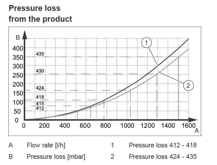

I looked up the ecotec plus 430 and it gives the pressure loss through the Hx which almost certainly will be the same for the 630 so can see what these curves really mean.
The Hx head loss is 2.55M at 1290LPH so requires the equivalent of a 4M pump curve so should be just about ok to increase the bypass to 3.5m because once the flowrate fall to 450LPH then the Hx head loss is only, 2.55*sq(450/1290), 0.31M, leaving ~ 3.7M.
