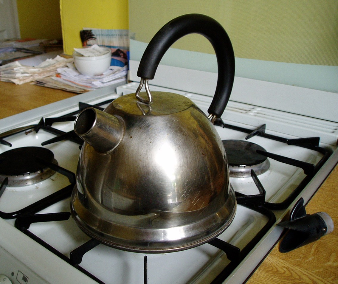

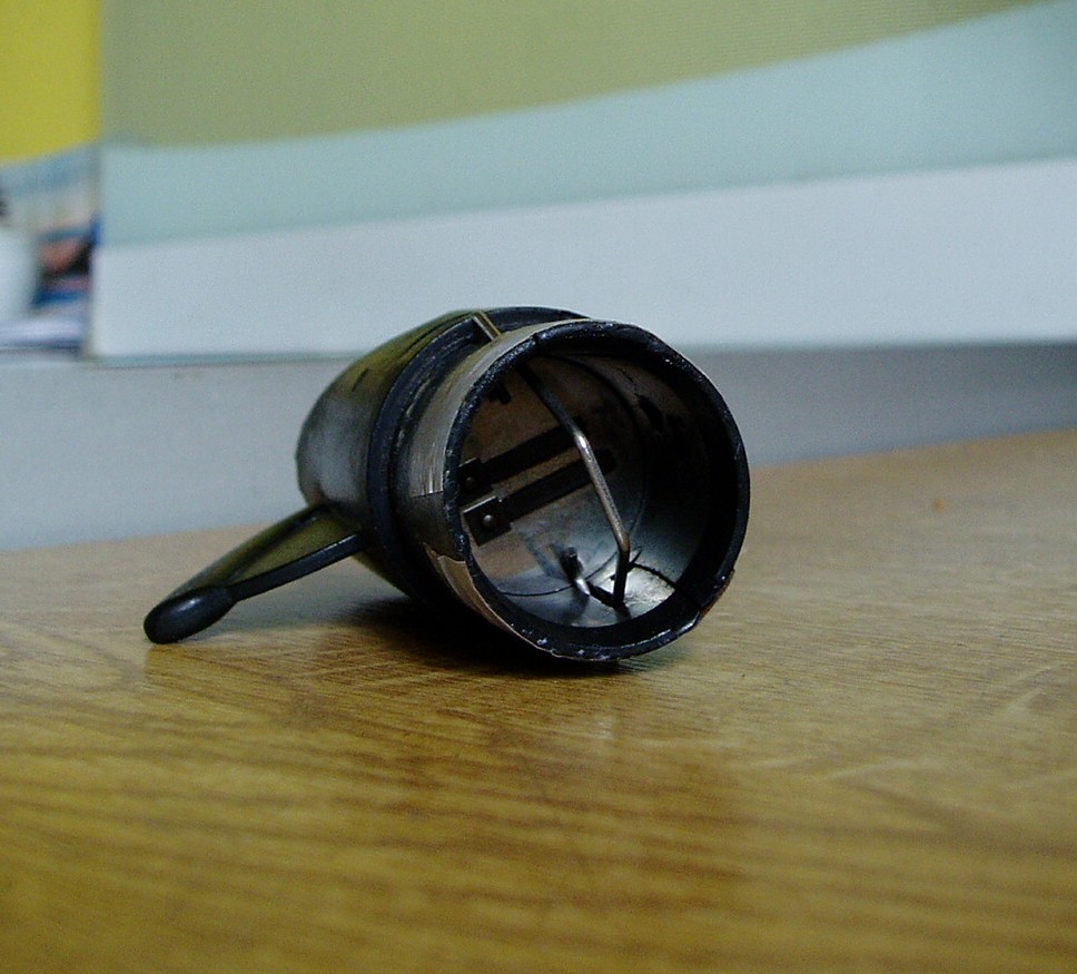

I have a Dutch kettle, vintage 1993, with a delightful two-tone whistle. The whistle is internal, i.e. it fits inside the spout and is held in by a spring clip with two protrusions that expand when it is inserted. The problem is that the plastic retaining the spring is cracked now in several places and the whistle is on the point of disintegrating.
The internal diameter of the spout is 25mm (1.0 inch) and the external diameter is 28.5mm (1 1/8in). I have looked in vain for both internal and external whistles with this diameter. So clearly I will have to make some sort of repair. But what? As you can see I have tried taping it up with a variety of tapes but at 100C they all either lose their stick or melt and peel off immediately. Any suggestions / ideas welcome - thank you.

For now I have applied a 'bandage' of heavy-duty aluminium foil (Reynolds Wrap) around the cracks. It stuck to the whistle OK using the residue of all the other tapes that melted/came off! It's holding at the moment - only been in use 2 days - but it's only a temporary solution.
So when that fails it looks like I'll have to find some sort of pipe adapter, as suggested above. But it is very difficult to find the right combination of sizes.
You could try JB Weld extreme heat epoxy? It is ok up to 1300°c so would work - possibly apply with a brush to fit into the cracks then brush over to create a new surface. That could be left to cure and sanded down for a tight fit.
Possibly "painting" the inside and outside of the tube that slips into the filler and making use of the cracks to join the inner and outer of the whistle would add strength. Even drilling a couple of holes to allow the epoxy to join inner and outer?
Just read up on it and check it's food safe
