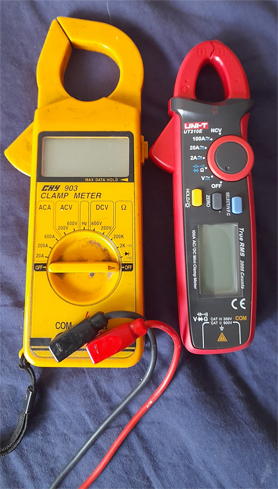

I have multiway to measure current. These Clamp-meter-small.jpg are the easy-to-use method, but these
today also measure it, plus using my old multimeter
I select an easy method, depending what I am working on. The red and black meter in the first picture has a NCV (non-contact voltage) option, this is handy to see if something is dead, before removing screws needed to access terminals, but what it will not do is test a neutral.

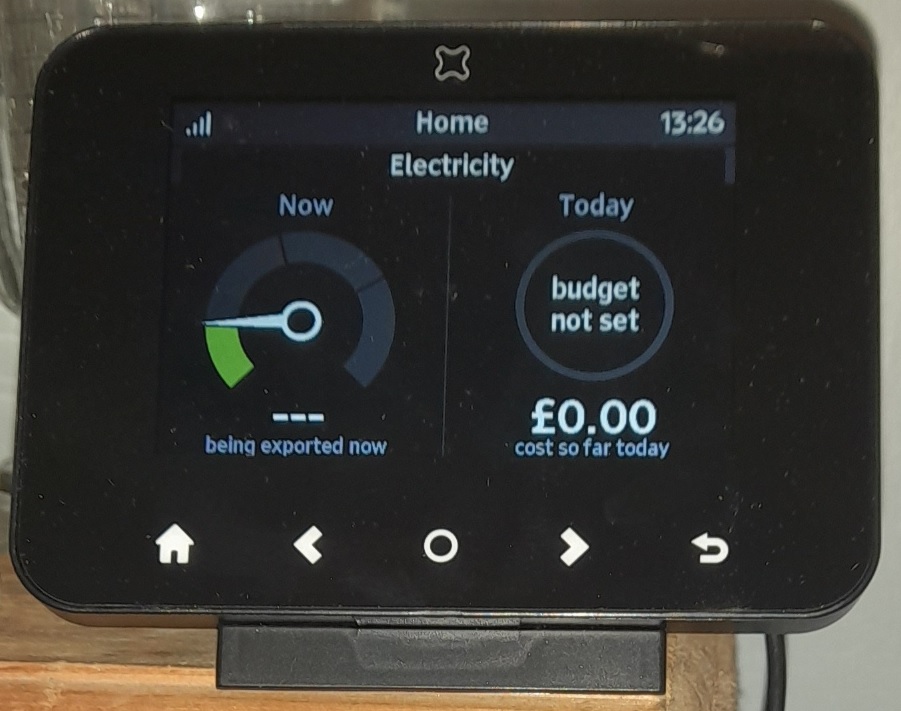

You have to use some common sense, even one of these Exporting 1.jpg silly things can help, if no other loads or inputs, it would not work for me due to solar panels, but then the solar panel software can also help.

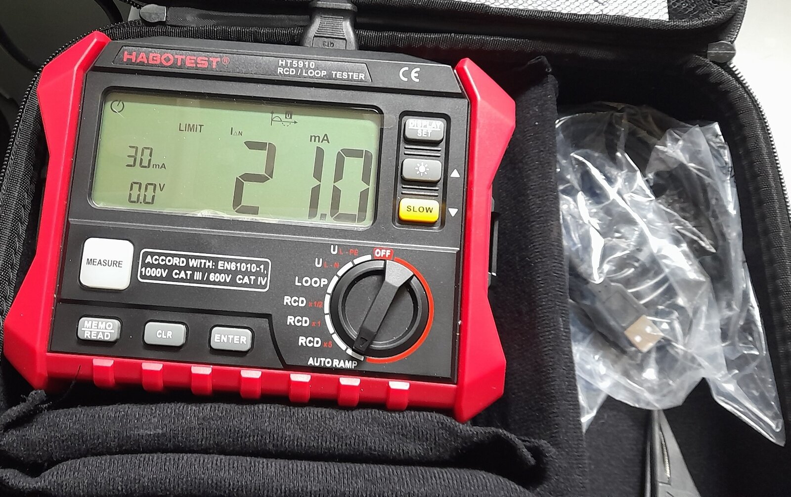

The problem I found is under floor heating takes so long to warm up, so looking for some faster way to test, be it a full-blown tester, RCD tester ramp.jpg or a neon screwdriver, but also need to test the neutral, and NCV, or neon screwdriver will not test the neutral.

So I can see what I used when, can see where the washing machine went on, must tell wife off about that, 5:30 am too late, off-peak ends at 5:30 am, then I can see when I made first cup of coffee, 12:42 and second cup of coffee, 15:48 talk about big brother watching me.
