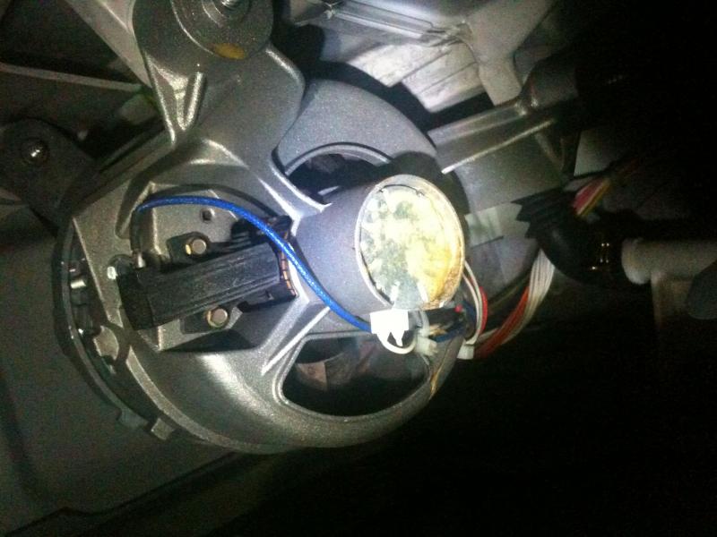

As it is a built in appliance, I was going to pull it out and go through the back. However, having undone the front inspection cover I can see (and reach) the tacho on the motor. I took a picture just incase I am barking up the wrong tree. A little unsure of how to proceed next, the tacho itself (which I am guessing is the end bit) doesn't look too easy to remove. I know that I need to check if the magnet is still attached - how is the best way to go about this?
I'd really appreciate some more advice, I've not tried fixing washing machines before so this is new territory. Thanks, jmh.

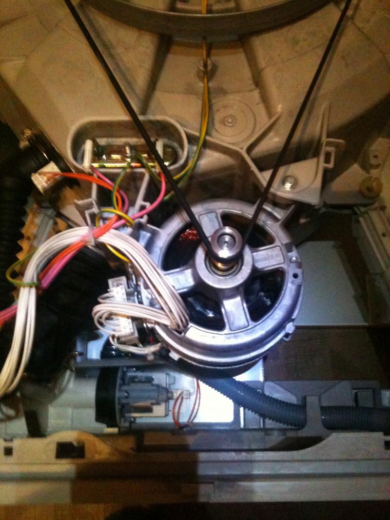

The easiest way to go about this is to take off the rear cover & remove the motor. Take off the belt & motor plug. Remove the 4 motor bolts & tap the motor back & off its locating pegs. It only takes 10 mins. Once out you can check the motor & tacho on your kitchen table instead of busting your back & knuckles working upside down on the floor. Trace the tacho wires back to the motor plug & check the coil resistance (two different coils were fitted in these motors, one is 184 ohms & the other type is 500 ohms). If it is open circuit you need a new one.
The tacho coil body is press fitted in the non-drive endshield, usually you can lever it out but be a little careful. If you can't get it out dismantle the motor from the drive-end & check the magnet once the armature is out. BTW the commutator on your motor looks black so check the brushes at the same time. If they are badly worn change them out. If the magnet is tight & the coil resistance ok check the motor wiring from the plug back to the pcb. If the wiring is intact, tacho/magnet ok, & brushes ok then the pcb is the problem.

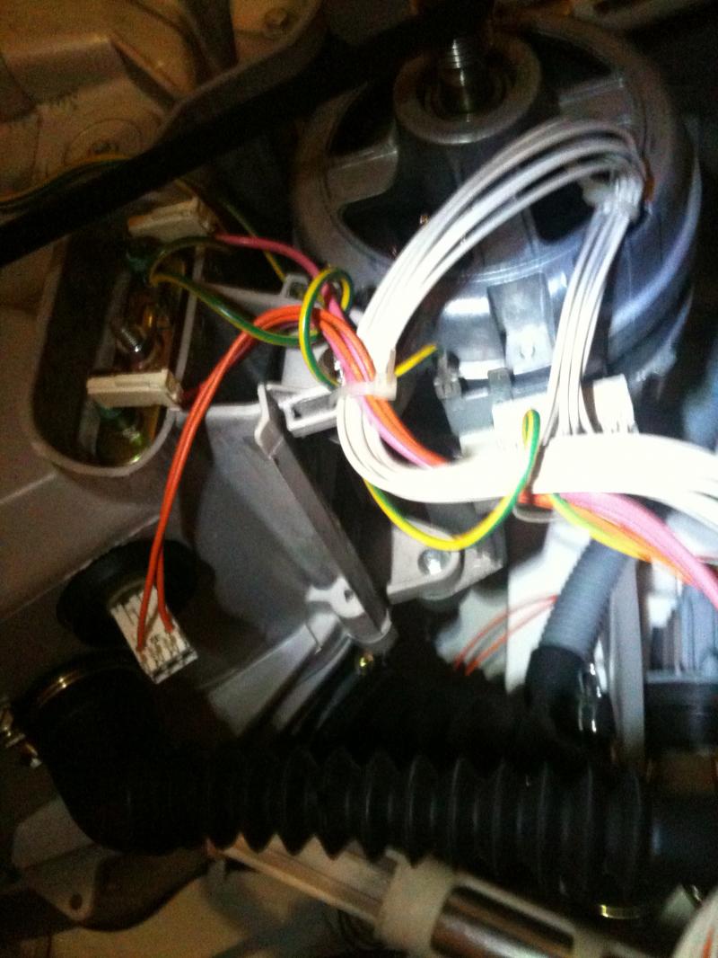

Nope, user manual is rubbish, believe me I've already looked! Anyway, machine is now out. Only snag is that the back section wraps around the machine, so not easy to remove.
Thanks for your help so far....think I'll leave it till tomorrow now.
If there is a seam on the sides then the outer case is split Zanussi style...(still only takes 10 mins to get apart).

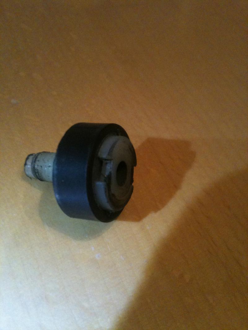

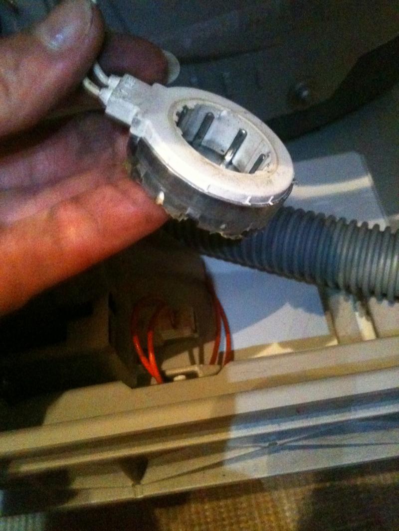

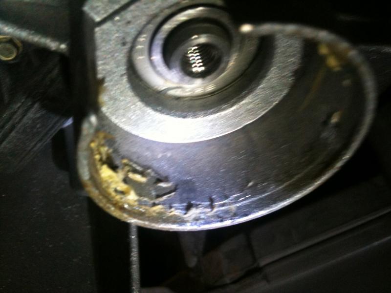

Right. Got to motor. Can anyone tell me what the magnet looks like? I've take the tacho cap off and am looking inside onto the shaft. I can see a white plastic internal bit, with a ring shaped bit of metal around it. Is the ring the magnet? if so, it is firmly in place (as was the tachometer cap).
Hmmm. Someone else mentioned that if the cycle started normally then went into an un-demanded spin, then it could be the electronic board instead?
help!
Checked that the magnet was indeed in place, but noticed that it was a little loose. Tightened it finger tight. After putting everything back together again I thought I'd run the machine, and amazingly, I seem to have fixed it. I'm really surprised that the difference of a tight magnet to a loose one makes a difference, but it obviously does. I took lots of photos to help anyone else tackling the same problem. A big thank you to zipper who talked me through the process :LOL:
Good job:cool:
The tacho sends reference voltage to the pcb which in turn controls motor speed. If for some reason it doesn't deliver voltage or the reference voltage is too low the machine can ramp up speed with a wash load/water inside. Spooky stuff :eek:
