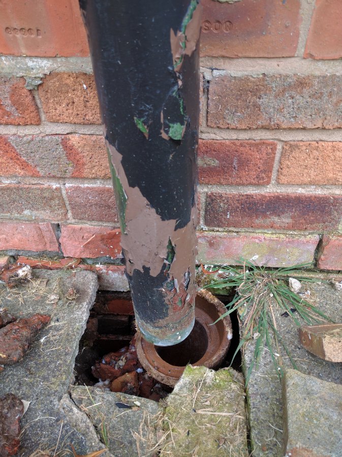

Hi,
Just bought a house and noticed a lot of rubble and cracking around soil pipe base, uncovered some rubble to find this :( how much should I be expecting to pay do you guys think to get it reconnected?

I wonder how he is going to do it when the pipe does not line up with the socket.
The proper job would usually entail digging up the clay pipe and replacing it with a new one in the correct position under the pipe.
Tony
I think that it WAS correct but has just leaked and washed soil away from underneath and has just sunken.
Probably fracturing the next joint underground which is why the whole thing needs to be dug up and replaced/corrected.
I suspect the £70 job will just be a bodge job above ground only!
Indeed leaving the underground connection leaking could cause damage to the house foundations.
I see the likely proper cost as about £250 being most of a day's work and a new clay elbow!
Tony
OP, it wouldn't harm your cause to lift those pavers and (carefully) reveal the clay pipe as far as the next joint.
If there is damage, your plumber pal would be able to effect a repair far more cheaply than if he had to do the digging.
The original fault is probably that clay bend is not bedded on weak concrete mix.
Any replacement should be done properly!

On the plus side, he makes a good point in that you should probably have a good look to determine what has happened. It probably is a lazy installer, but worth checking for movement of the pipe.

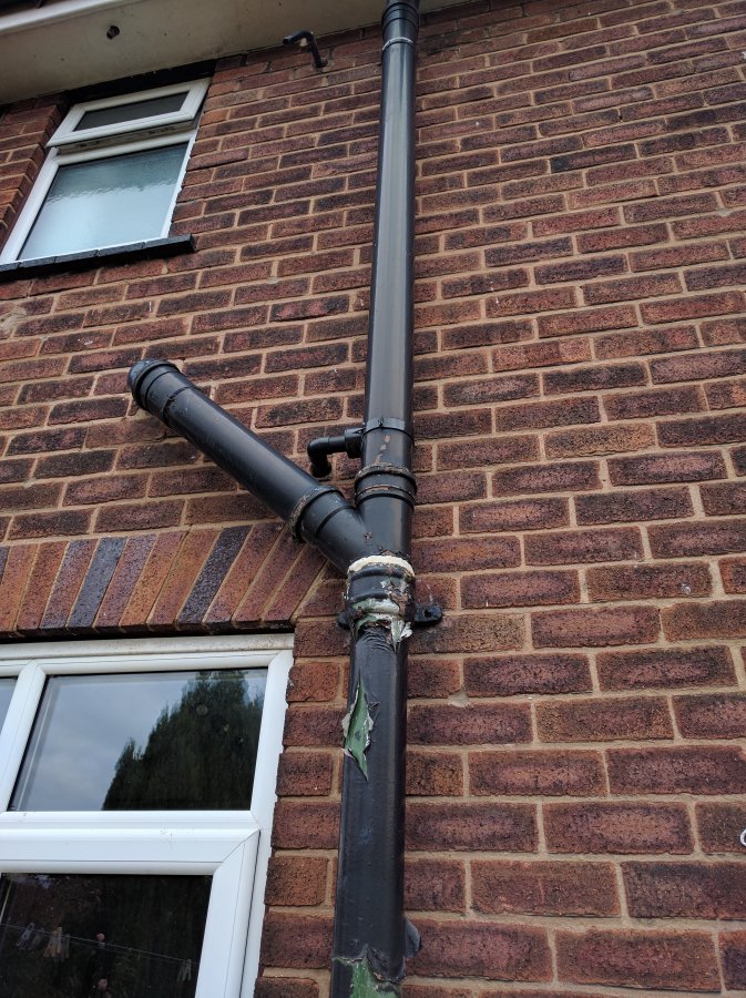

Have lifted the flags and done some digging, all seems very secure and no breaks.....metal pipe has some movement and can be pulled back in line with a wiggle, noticed that it seems a poor job by whoever fitted new bathroom before us as changes from plastic to metal half way down, picture attached

If the clay pipe is really secure and the next joint is not leaking then it could be simply repaired if the cast pipe can be pulled into position and is then vertical.
Not wishing to spend your money for you, but you might take the opportunity to remove the last section of metal (that joint looks a real botch) and go plastic down to ground level.
Good luck, buddy!
Thanks for your help, they've sent CCTV down, definitely no other breaks :)........just a quick seperate question, should a rainwater hole in floor from roof guttering hold some water when not raining or should it always empty itself completely?
