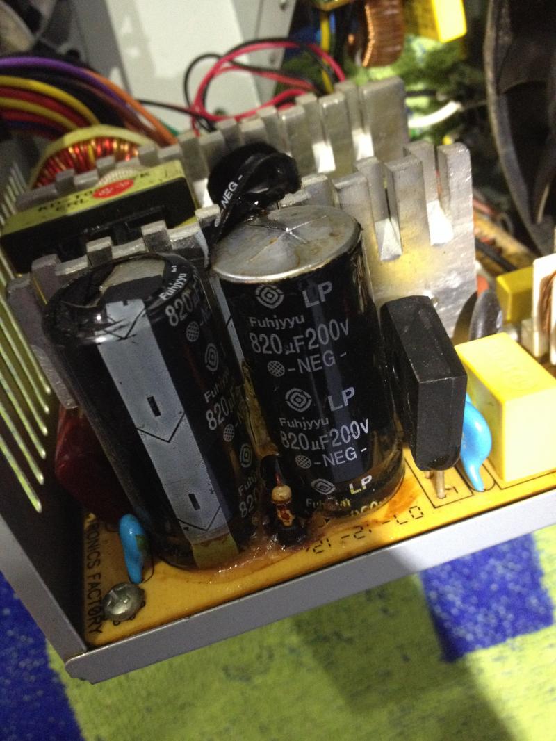

Ever tried powering up a 8 year old computer PSU by shorting pin 16 (PS_ON) and 17 (COM) together on the main ATX power connector.
Well I did, and it powered up and ran fine for about 10 seconds before making a loud pop and whoosh sound whilst releasing lots of obnoxious white smoke and leaking horrible brown fluid! (side note: What is the brown fluid and will it wash out from my bed cover?)
Lets just say one of the main Caps inside failed catastrophically!

When resurrecting an old power supply or anything else with electrolytic capacitor the risk of a capacitor "boiling out" is significant.
If it is essential to use the item then the risk of a boil out can be reduced by re-forming the capacitors by applying a very low DC voltage to them ( via a resistor to limit the current in case the capacitor is beyond repair. ) If the current drops after time to be close to zero then slowly increase the voltage.
The majority of electrolytic capacitor are constructed from two long strips of aluminium foil ( plates ) separated by paper soaked in solution of a chemical that is conductive. These are then rolled up and put into a can or other package, As such they are NOT yet a capacitor. They are then "formed" into a capacitor by applying a voltage to them. The current causes the chemical to react with one of the plates to create a thin layer of oxide ( or other compound ) This layer is an insulator and thus the capacitor is created.
Over time if the capacitor has no voltage applied the oxide layer dissolves and then when voltage is applied the capacitor current will flow from plate to plate through the liquid. This heats the liquid up to and beyond boiling point. The oxide starts to form but is detached from the foil by the high current, hence the current limiting resistor when forming the capacitor.

Consider yourself lucky that the can is deliberately weakened on modern caps. I recall years ago someone telling me about reforming caps (in the context of powering up old (valve) TVs and radios), using a variac to slowly wind up the voltage. Go back a while and caps tended to have stronger cans and a hard seal - thus internal pressure could build up considerably before anything lets go.
He told me on one he'd had where the can punched a hole in the side of the case (the thin ply common in the 70s & 80s), before embedding itself in the wall.
The last one I had fail was only a small one - it sent a shower of paper and aluminium foil shreds round the room.

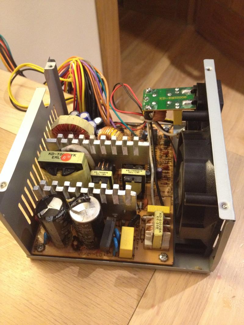

Also, this is the internals:

I have to say, it is scary when a cap unexpectedly and catastrophically fails whilst making one hell of a noise and filling your bedroom full of rancid smoke.
Sumvision just one about one of the worst brands, the Sumvision PSUs on Ebuyer etc £10 etc! I run an IT support business and wouldn't be able to sleep at night if I sold that rubbish to customers.
EVGA sell some decent PSUs and a bit cheaper than Corsair etc.
The specs are a joke too on that PSU, 26 amp on the 12v rail and supposed to be 600w! I bet it wouldn't have been able to cope with 15 amps.
