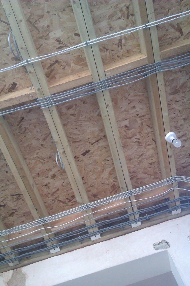

So, I've gone from this sort of wiring:
Ripped it all out and am now doing my own install (First fix only so far)
I do feel so much better about it :)
I assume these cables are to be covered up (ceiling)?.
How do you intend to comply to the regulations concerning cable protection from mechanical damage?
50mm batons installed at 90 degrees to joists with plasterboard over the top.
Though I wasn't aware the ceiling was an area that is deemed susceptible to damage. Especially considering the number of cables I've seen just fed down between joists during re-wires.
Did you apply for Building Regulations approval?
Hope you never need to do anything to those cables ever again.
And what's above the ceiling?
How far are those buried cables from the corner? They don't look to be within 150mm.

Nope, as the work is all getting inspected before cover up by a qualified spark, along with second fix, final testing and sign off.
I agree, hope I never have to change anything. But I've got around a 50% redundancy with the cables, so I can change quite a bit without needing to re-run anything (all run back to a central, accessible, distribution point)
No where near 150mm from corners. All buried cables in the wall are a vertical drop to an accessory point though.
Yea, that's the toe of a boot lintel :| I hate those things. Thankfully, it's not directly carrying the weight of the roof any more.
You found one prepared to lie and say he did it all?
Serving that point, or just passing through? :wink:
And what's above? You say this is an extension, so if that's a flat roof what about insulation and VCL?

One piece of conduit per accessory box. No pass throughs. All run as spurs to a common distribution point.
It is a warm deck flat roof with 120mm rigid foam insulation, 2 layers of 18mm OSB3 inc. a VCL. Topped with EPDM and bird cr*p. All new, and a damn site better than what was there.
Are you trying to find holes in my work Sheds? :p

OK - it just looks like a lot of cables, that was all.
No - just wondered if you were planning on putting insulation between the joists.
Well I assume you will be fitting plasterboard, therefore screws every 150-200mm, doubled up where boards a butted up. That is about 15-20 screws per square metre. So taking that into consideration if the screws are of a length that can cause damage to the cables, I think there would be a good chance that cables will be damaged. The regulations state no less than 50mm form top and bottom or must be mechanically protected, it does not matter what the state of the cabling and routing was previously, you are installing new cables so needs to satisfy the regulations.
A lot of that cable is network, alarm and speaker. Most T&E is for the lighting.

PrenticeBoy, I highly doubt I would have a problem with a screw hitting, even without the extra 50mm. But that's only because I'll know exactly where every mounting point and cable is. Though it's an appreciable concern of someone over boarding in the future. I may look at armouring them up regardless. Never know when someone is going to get overly zealous with a hole saw :|
I could have drilled the joists, but I would have needed a lot of holes, and would rather not impact the strength of them.
It annoys me that, legally speaking, it's more acceptable to leave dangerous work alone and ignore it. Than make it safe / correct it. But, being a law, it's a line that needs to be towed in public I guess.
metallic capping would not be considered suitable, at least 2mm gauge would be required to deem it as mechanical protection.

Heavy gauge conduit is usually specified at around 2mm, this product is deemed suitable as mechanical protection, so with that I would say 2mm is adequate. I all once on a job with a rather awkward building controls office asked what their opinion/instruction was on the gauge used as mechanical protection, they also stated 2mm. BS7671 does not actually specify a gauge size. I think in these cases an assessment should be made and common sense used.
