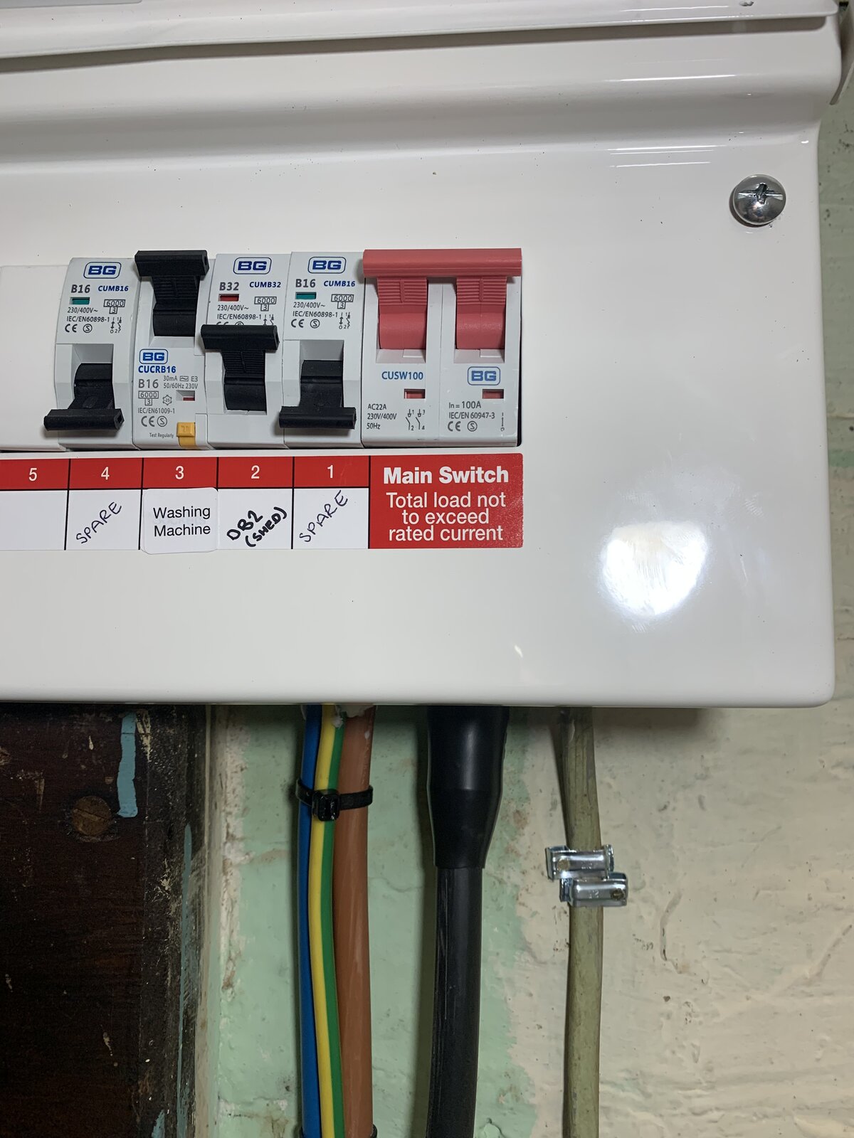

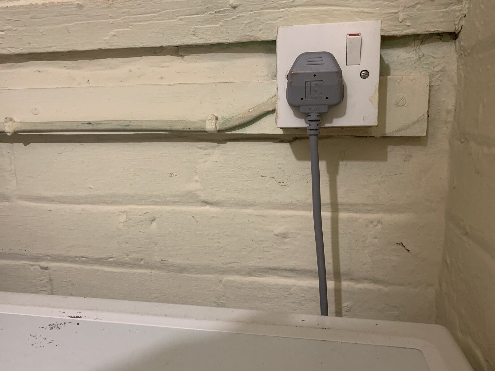

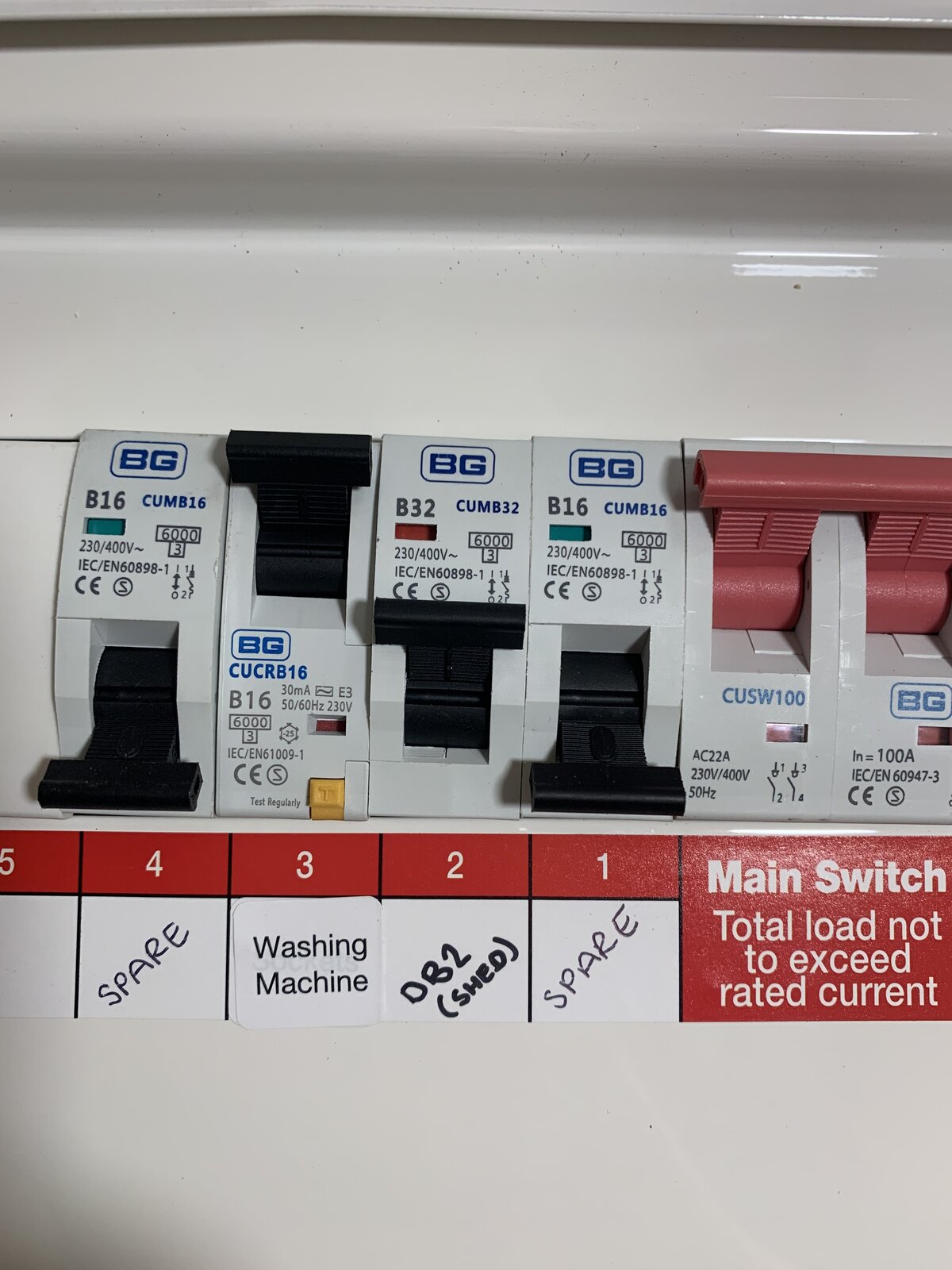

Good evening
Before I ask, if I need an Electrician then so it be it I’d rather do it via the book than not be safe. Anyhow I’m wanting to install an external socket down the side of our house, the most direct way to connect it up would to use the washing machine redial direct what goes from the consumer unit to a 1gang socket via 2.5mm t&e cable , what Wanting todo is to put FCU in-line so I could spur off to the external socket. Am I allowed todo this myself without having a Electrician involved.
many thanks

Assuming the work doesn't involve a new circuit and doesn't involve work within the zones of a bathroom or in a room containing a swimming pool or sauna heater, then it's not notifiable.
There is no electrical need for a FCU, you can use one if you want but a plain junction box or a 20A switch would be fine too.
However before spurring a new socket off a 16A circuit that already supplies a washing machine, I would ask yourself what you plan to use the socket for. If it's for occasional garden tools then it's probablly fine. If it's for charging an EV then I would be more skeptical of the idea.
thanks for your reply, the socket will used to connect our micro caravan up when it at home, mainly just to charge the 12v leisure battery up and to use the odd 700w heater.
Then I would leave the 16A RCBO as it is and simply fit a 16 amp socket.

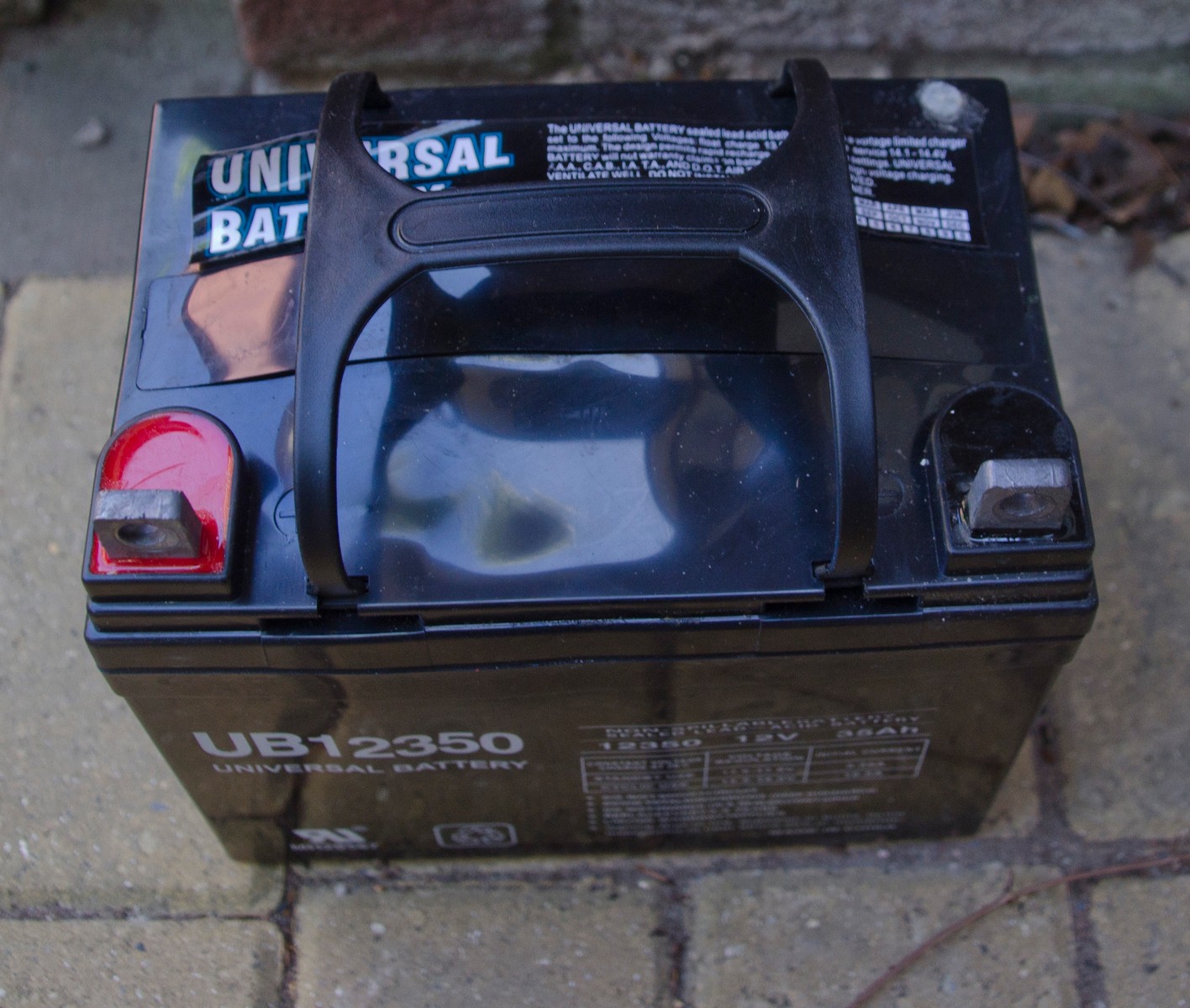

Two caravans ago I walked past it parked on father-in-laws drive, and thought some thing wrong with drains, smell of hydrogen sulphide, then it twigged, and yes cell gone short circuit, had I not realised it could have taken out the built in charger, and clearly an explosion risk if any smokers walked past, 18 amp of built in charger is great in use, but in storage can cause a problem. So the Lidi smart charger once it drops charge rate from 3.8 then 3 to 0.8 amp will not return to higher output it will go between zero, 0.1 and 0.8 amp so no real risk of explosion if the battery fails.
This DSC_3937.jpg was the result with a mobility scooter battery 35 Ah with just a 4 amp charger when a cell went short circuit, bad bit was it also took out the other battery of the pair, as 24 volt.
