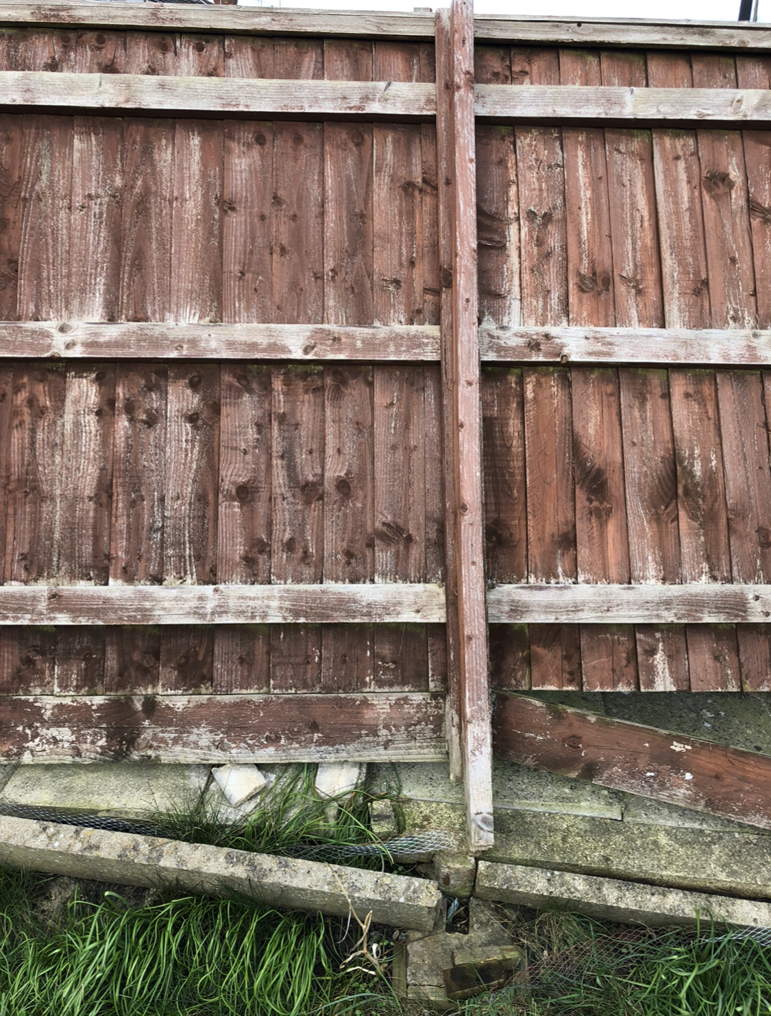

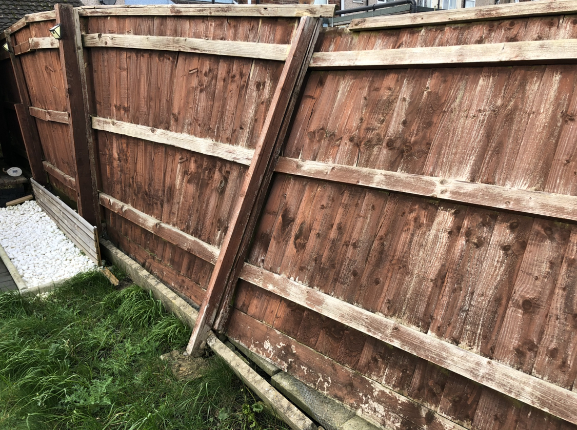

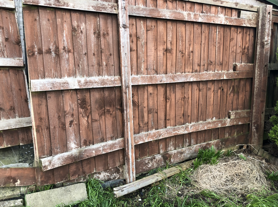

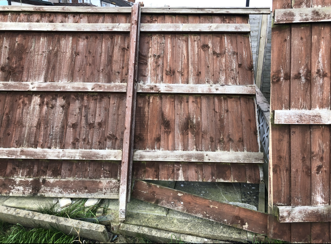

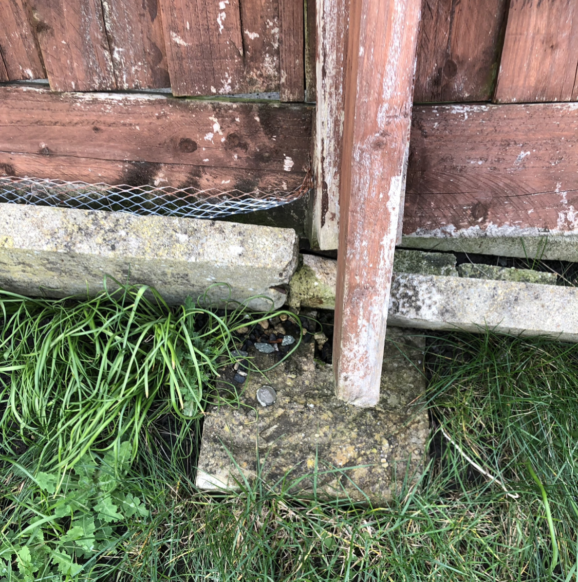

I’ve got this fence that has fallen due to the recent winds, simply put how do I go about repairing it?
Concrete repair spurs.
After setting them, you lift up the fence and bolt the old posts to them. Cut the rotten end off and position them so the timber post is not in contact with the ground (which is the cause of the rot leading to the break).
Resolve never again to put wood in the ground.
Metal supports are nowhere near as good.
Other support items are available. To be honest looking at that lot it all needs pulling down and replacing.
If you can afford it you need concrete posts with slots for the panels and put a gravel board in first so no wood touches the ground
Agree
But once the spurs are in, he can fix new timber if and when he feels like it.
