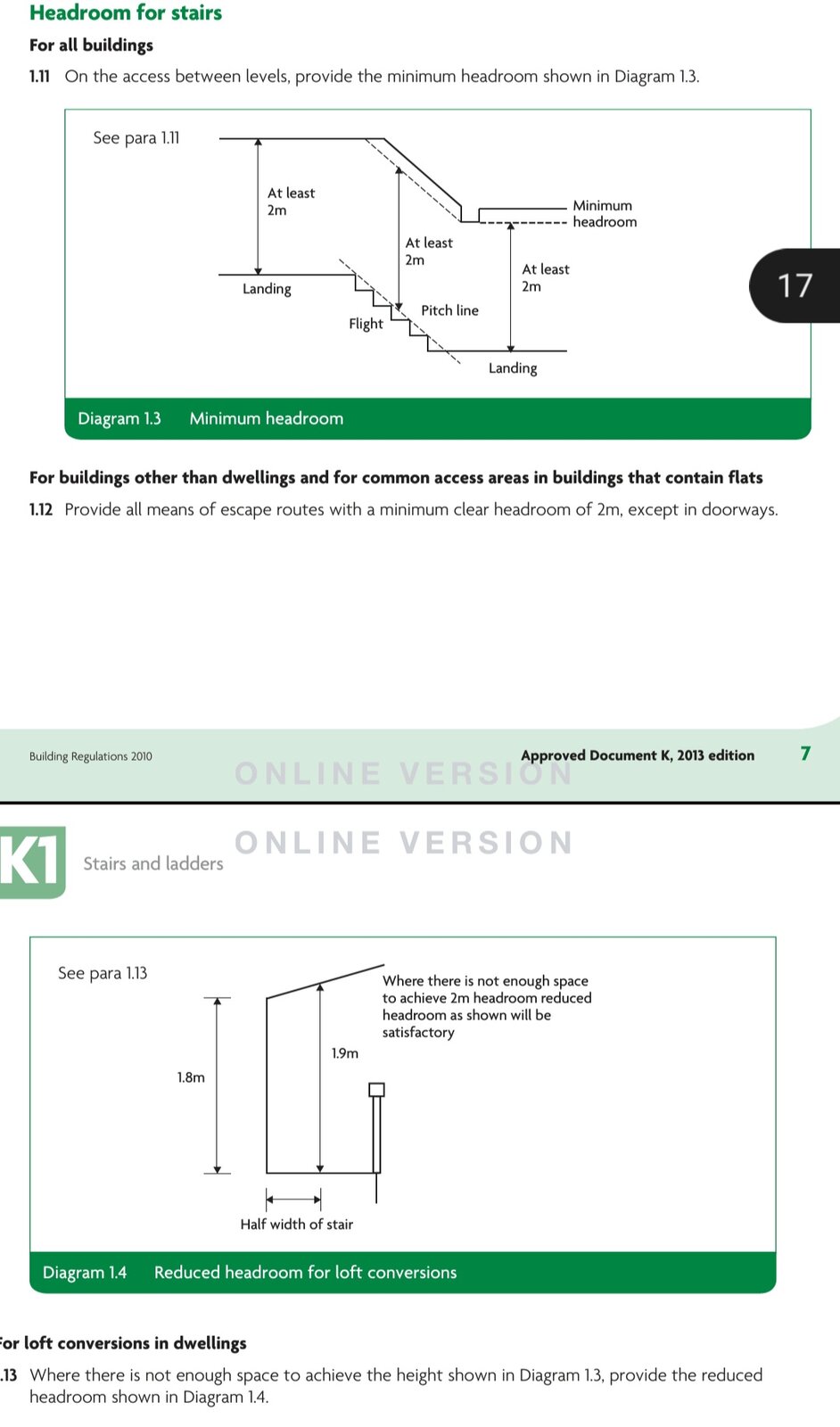

The only building regulation linked to head height, relates to 2m on the landing, outside the door at the top of the loft stairs - there is even some leeway in that and some ways around the limitation - i.e. having a velux at the top of the stairs may gain you a crucial few cm, rather than that section being an insulated roof section.
Ideally the head height in the conversion should be 2m, but if you can live with less, it could save you a lot of hassle in lowering the ceilings.

2.3m ceiling height for first floor bedrooms is not so bad, it wouldn't put me off. 2.4m is pretty standard. If you're planning on staying for a couple of years at least then I wouldn't be perturbed.
What regulation is that?
Can you be more precise over which part you object to, so I don't make the same mistake again?
According to the guidance to the building regulations, provided by approved document K.
Section 1, part 1.11 suggests 2m headroom should be provided on landings, but there is some leeway for loft conversions where a ceiling may slope...

The 1.9 is measured on the centreline of the stairs.
There are several ways to gain an inch here and an inch there to maximise the headroom you can achieve dependant on how good your designer is.
. If you can then putting the separating door on the first floor and boxing in the stairs for separation can help.
