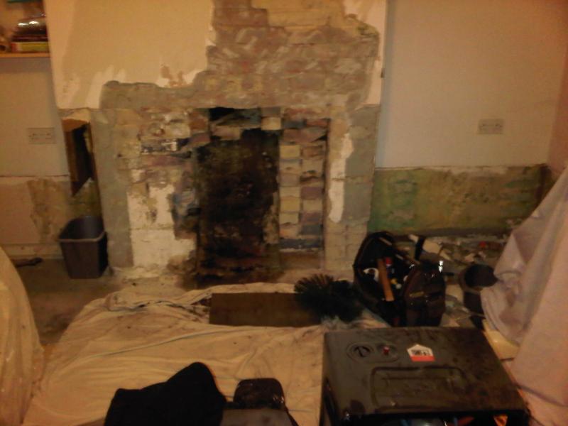

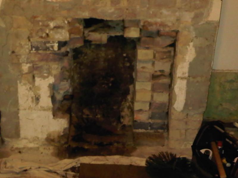

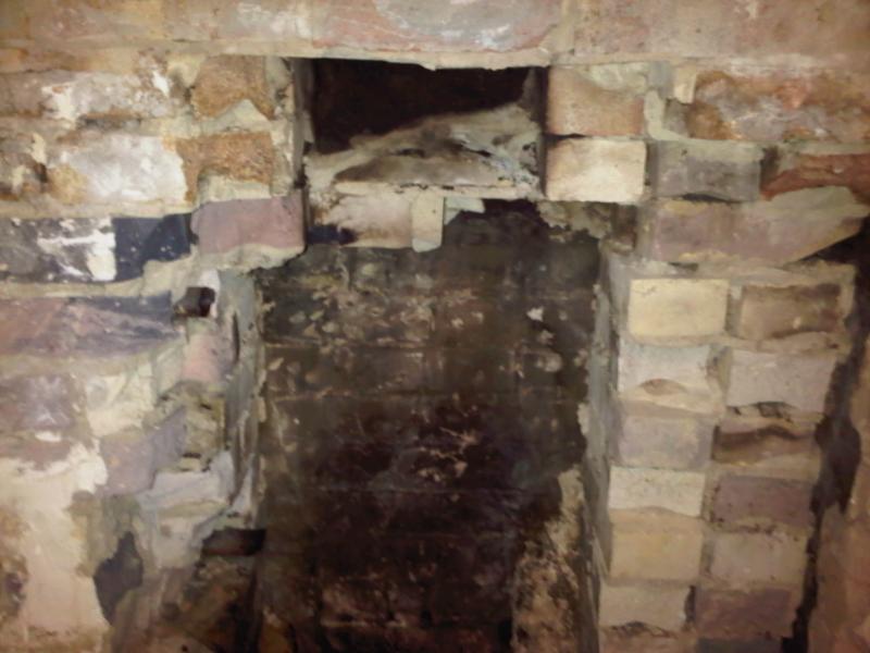

hey all. i have today removed the fake fireplace etc to see what we are looking at for the new woodburner. on removal i found no lintel, just an old back boiler packed in there. ive chased nearly all the way up the wall and found nothing. now i dont think itll be a problem putting a lintel in however teh way the previous build has been done, i dont understand how the colums will be supported. the colums look like they have also been redone and none of the bricks tie in, they all point the same way. can anyone help? im kinda stuck scratching my head. if its just a case of putting a lintle in the front then not a problem, but i dont want to remove the inner bricks in the picture incase it all comes down.
jez[/img]
It's as Joe says. The structural jambs are the 9 inch piers at the sides. That's the builders opening. The fireback and infill is put in later.
ah right. but what about the lintel? the piers either side dont look like there tied in either. the way the brick goes into a point at a top aswell is a bit worrying. i have a builder coming at 9am tomorow. hopefully all will be well. thanks guys

1. yes have all the dimentions and with the fill out of the way it will fit lovely with a nice gap either side to put some logs / bucket and tools.
2. the register plate i can make on install.
3. the sweep has been in since i took them pics and done a full sweep, smoke test and scoped the chimney from top to bottom. he says it all looks good now and have a cert to go with it.
4. the c stack should be looked at this morning with the builder.
5. the hearth is the width we would like already (with the fill out) however i will be taking it down and releveling it to neaten it up.
6. i drained the pipes yesterday before i cut them. i have to go upto wickes today to but some stop ends for it as they are being removed all the way up to the ceiling.
7. a burner installer friend of mine will be coming in once fitted and testing the burner, flue and fitting a a CO meter, temp guage and then signing it off for regs.
hopefully the buuilder will have some good news for me this morning :)
