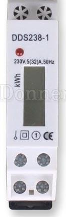

just seen one of these on ebay tho, I have room in the fuse box so might work?http://www.ebay.co.uk/itm/LCD-5-32A-230VAC-DIN-Rail-Electrical-Kilowatt-Hour-kwh-Meter-DDS238-1-UK-Stock-/221290848575?_trksid=p2054897.l4275
In theory (if the total load is no greaterthan 32A), but installing one of those in your CU would probably not be at all straightforward. As TTC has suggested, just an ordinary cheap kWh beter inserted in the feed to the CU would probably be simpler.

The type of meter that I linked to (above) is the same as used by electricity companies in many houses.
These certainly retain their reading otherwise your meter would go to zero with every power cut!!
The DIN rail meter in the 3rd post has a fake CE marking. Stick with known brands.
