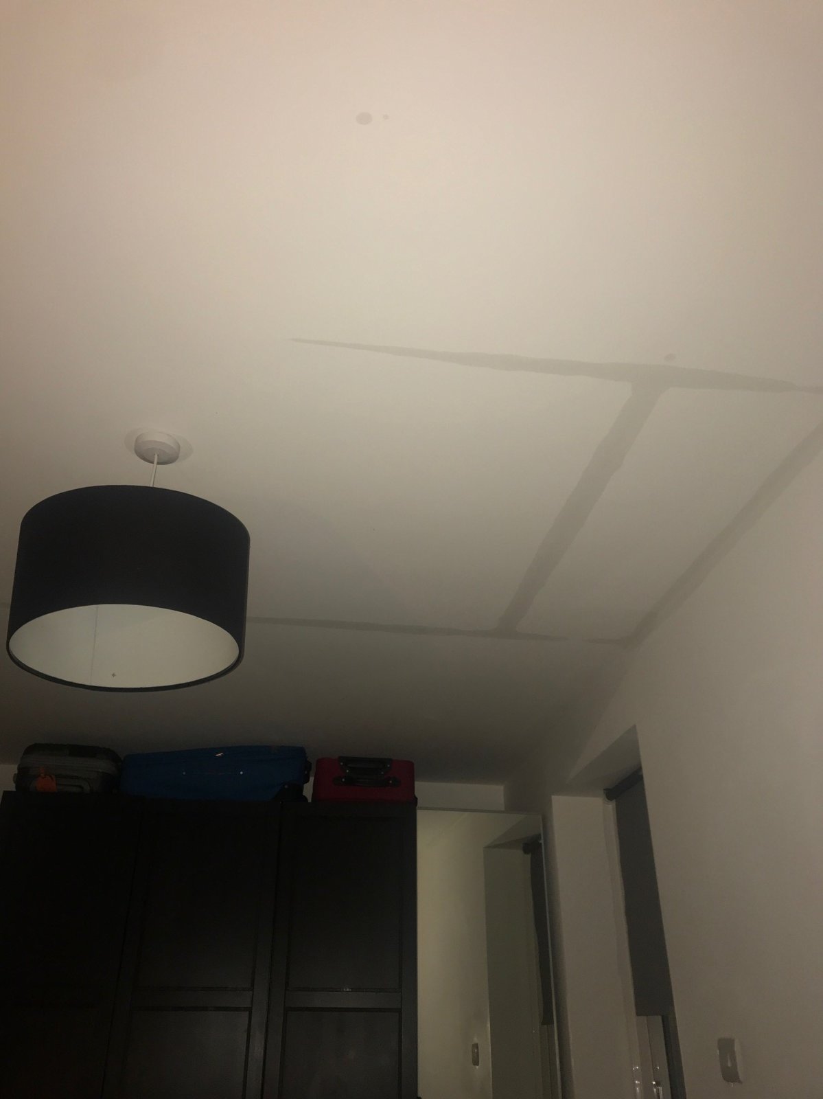

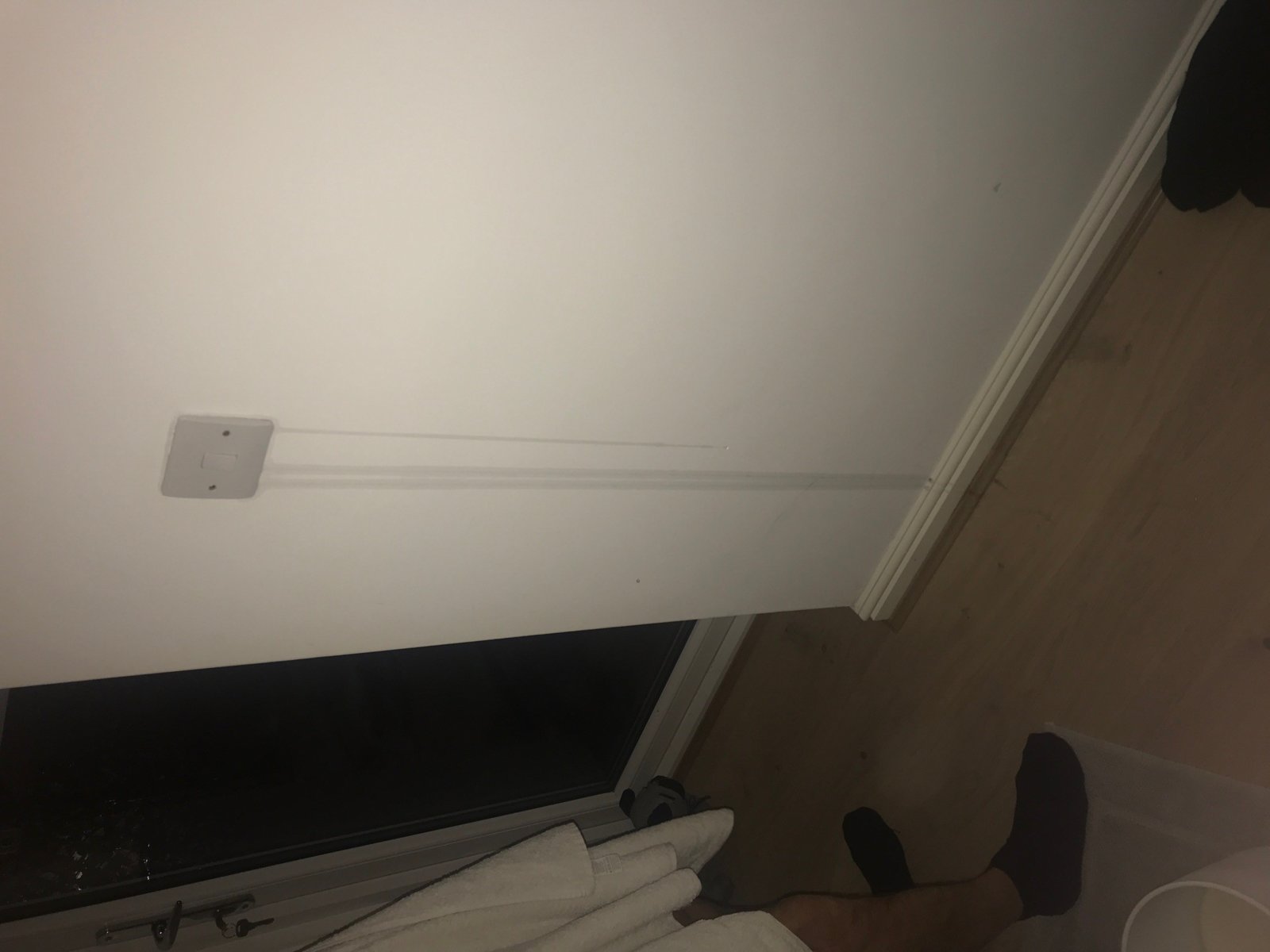

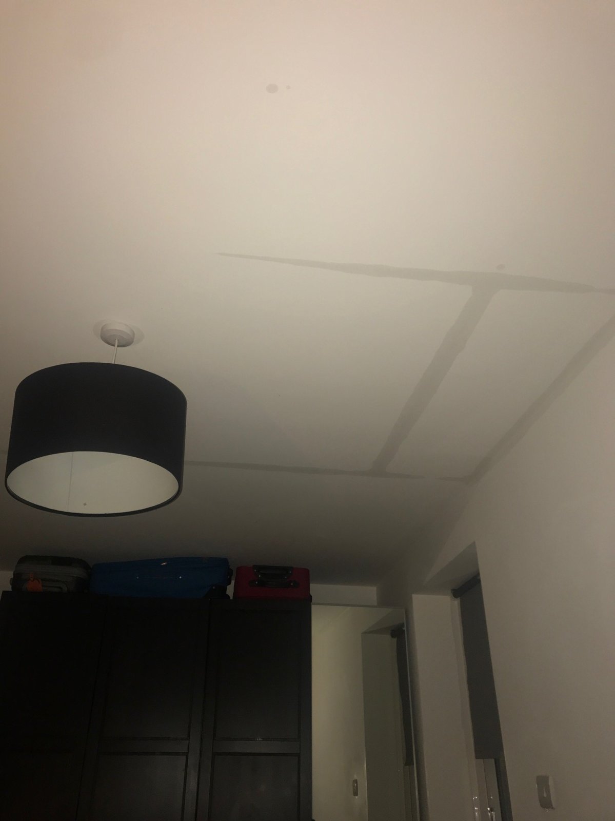

Hi, our residential flat roof is being refurbished due its deterioration caused by bad ventilation and related condensation.
The insurance did not pay for a temporary roof, and both the insurerance adjuster and the roofer that won the contract guaranteed that the work could be done without it (works would have been a bit slower and inconvenient, that was all).
However, last night our flat was literally flooded with multiple leaks, we stayed up all night and placed buckets all over the flat to try to capture the water. The roofers, despite assuring us they would be available at any time for emergency calls, did not reply to our calls.
The materials used for this project is single ply sarnafil.
These are the questions we hope someone could help with:
- Is a temporary roof the only way to get these jobs done? Apparently whatever temporary protection was used proved to be useless.
- Is the impact from hours and hours of extended leaks likely to be structural/serious?
- Does whatever has been done so far (2 weeks of works) need to be re-stripped out and redone, due to the massive watering?
- Does the insurance normally cover the extra costs due to this massive disaster, on top of what has already been paid to the contractor who won the contract?
I appreciate some of the points above can hardly be assessed via internet, but I would be grateful for any opinions on this.
I've attached some pictures.
Thanks in advance for your help.
Cristian

It isnt ideal, but water igress during works is difficult to prevent.
The probelm with temporary protection -usually tarpaulins is that rain water ponds in the creases and runs in somewhere. It is possible to make a roof virtually rain proof, but it takes time to do it.
In reality it will all dry out once the sarnafil has been fitted and you are sealed in.
The water looks dramatic, but its got onto the plaserboard upper face and run across until it reaches a joint.
The water often runs down electrical cables and exits out of the backbox

It's not really easy to capture on pictures, but our kitchen and living room floorboards have curled a bit. The leaks were so intense that even the flat below us was heavily impacted (water flowed throught the walls cavities). It was really a scary scene to be honest.

The couple of pictures provided did not look too scary to me. Permanent damage likely to be low.
