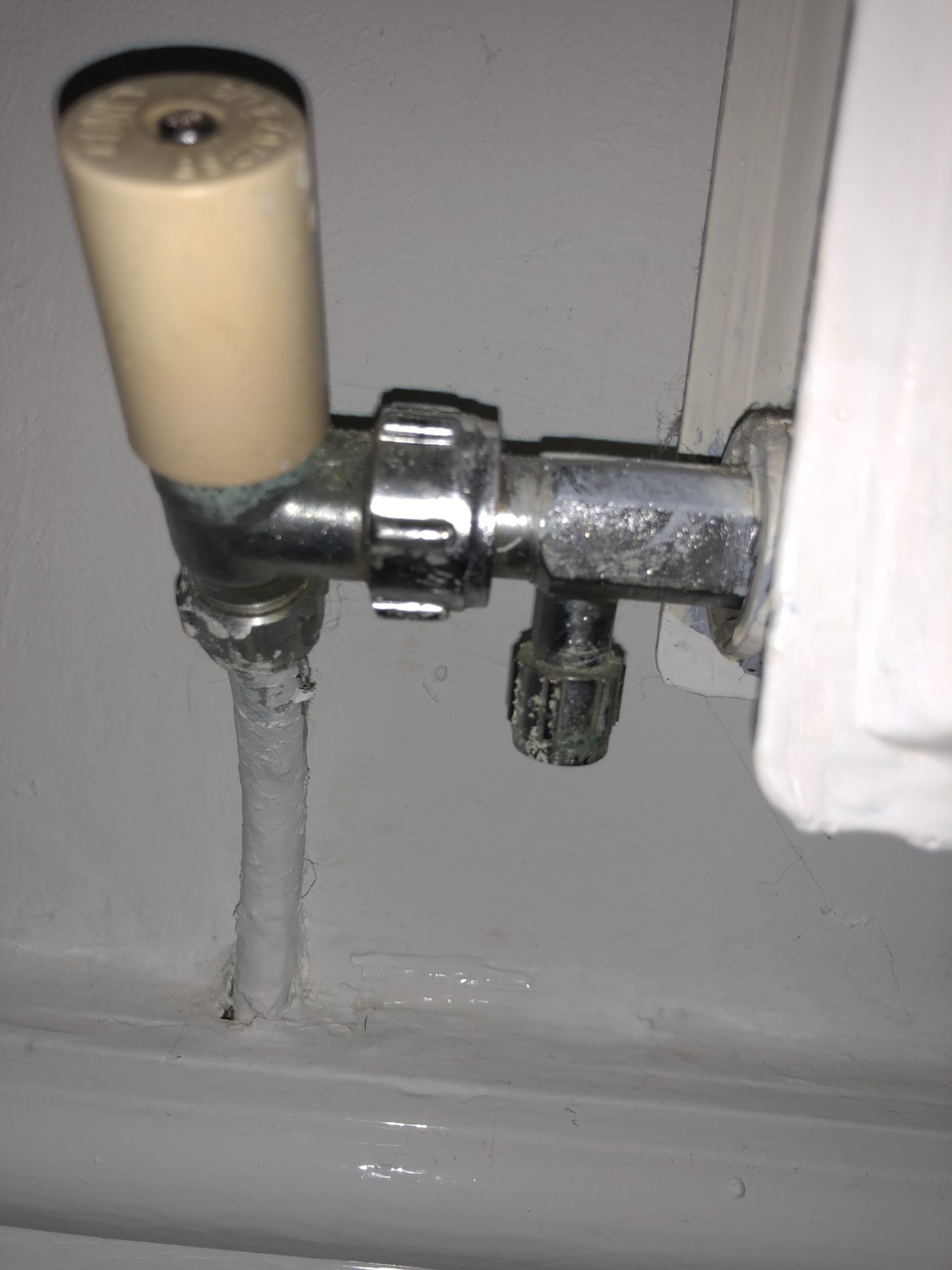

Can anyone help. We have just tried to put our heating system on a contract with BG. The guy came along and predictably offfered a system fpowerflush for £800. We have an issue with the system short cycling. I reckon it might need a clean so I thought I would clean it with fernox. We don’t have any traditional drain vales - but we have these ... what are they. Is the chrome cap a dust cap - or will water pour out if removed. Any help appreciated.
Lol - ok thanks - why? Im guessing its just a corroded drain that will never go back propperly. Should i drain by removing a small rad downstairs. Or maybe just call soemone wheondoesnt charge £800!!

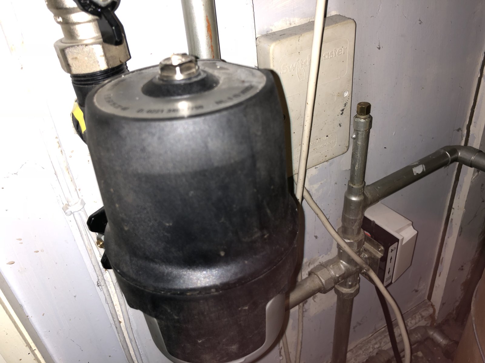

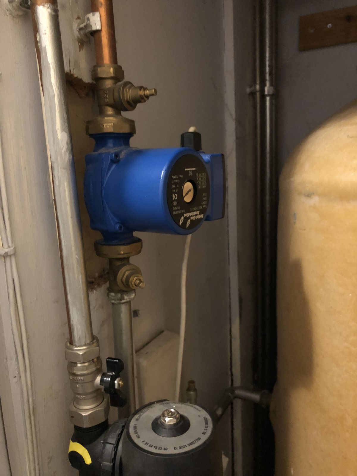

The problem is that when the heating system calls for water heating only - the boiler short cycles. up for 8 seconds then off. We have a BG contract - called them - and they gave the go-to answer - you need an £800 power flush. Magnets also stick to a some of pipes (short horizontal pipes that link large hot water verticals) in the airing cupboard. We have hot water expanding upwards into the tank in the loft to the point where it overflows and drips rapidly from the back of the house. 3 Way actuator has been replaced - and seems to work fine. In the last few days we have also had the boiler shutting down before reaching the requested circulation temp when HEAT and WATER is requested - and the rads running cool, but generally on HEATING ONLY all works fine. Hence the thought it might be circulation of some kind...
Best solution is to get affected pipework cut out and checked / replaced.
Power flushing never removes all of the crap.
Photo would be good.
Nice one Terry I said that you couldn't flush micro bore and had 4-5 people slagging me off saying I was talking out my axxxse but I'll stand by what I said you can't flush micro bore because the cross sectional area isn't big enough to support a sizeable flow.Bob

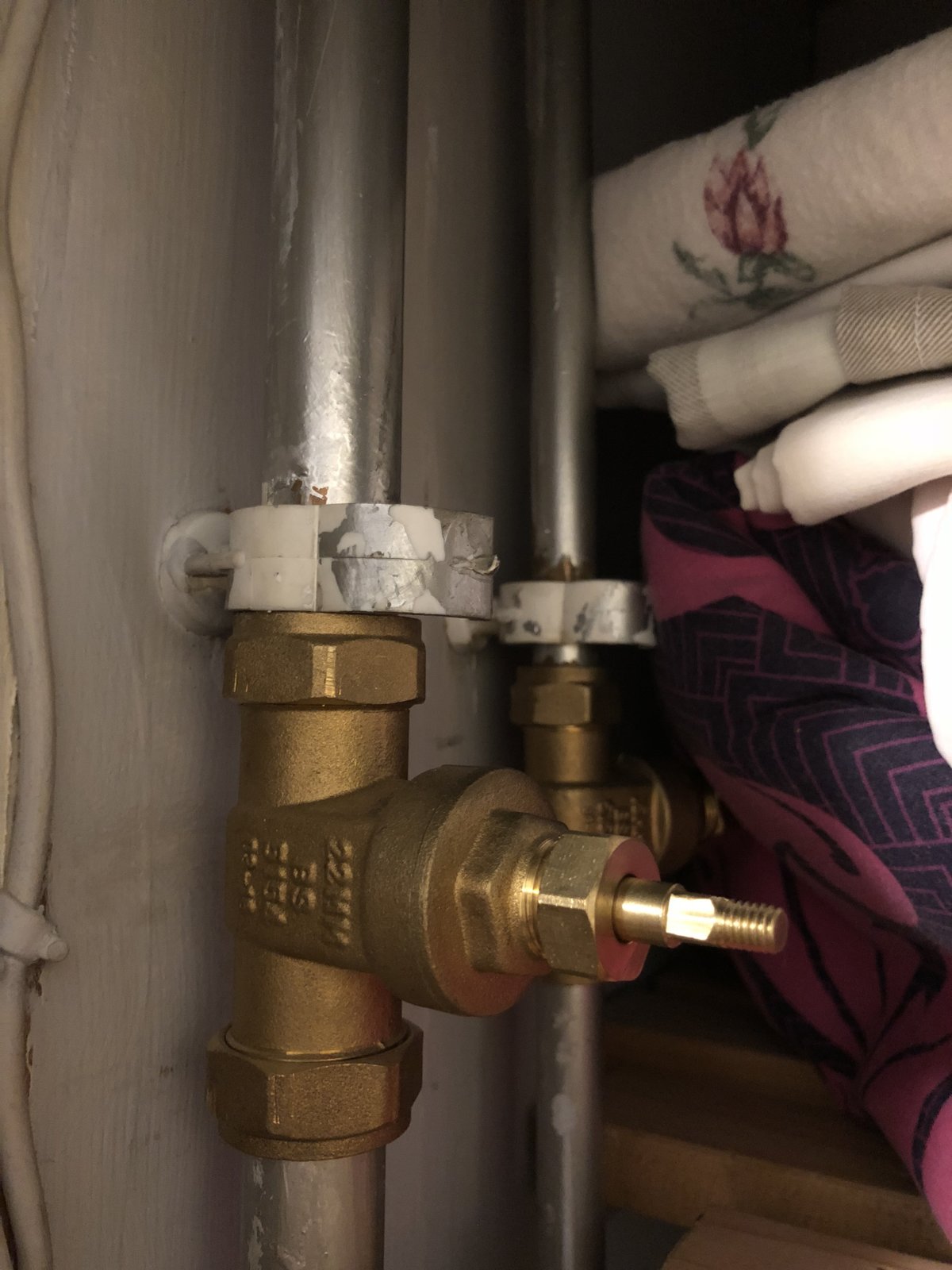

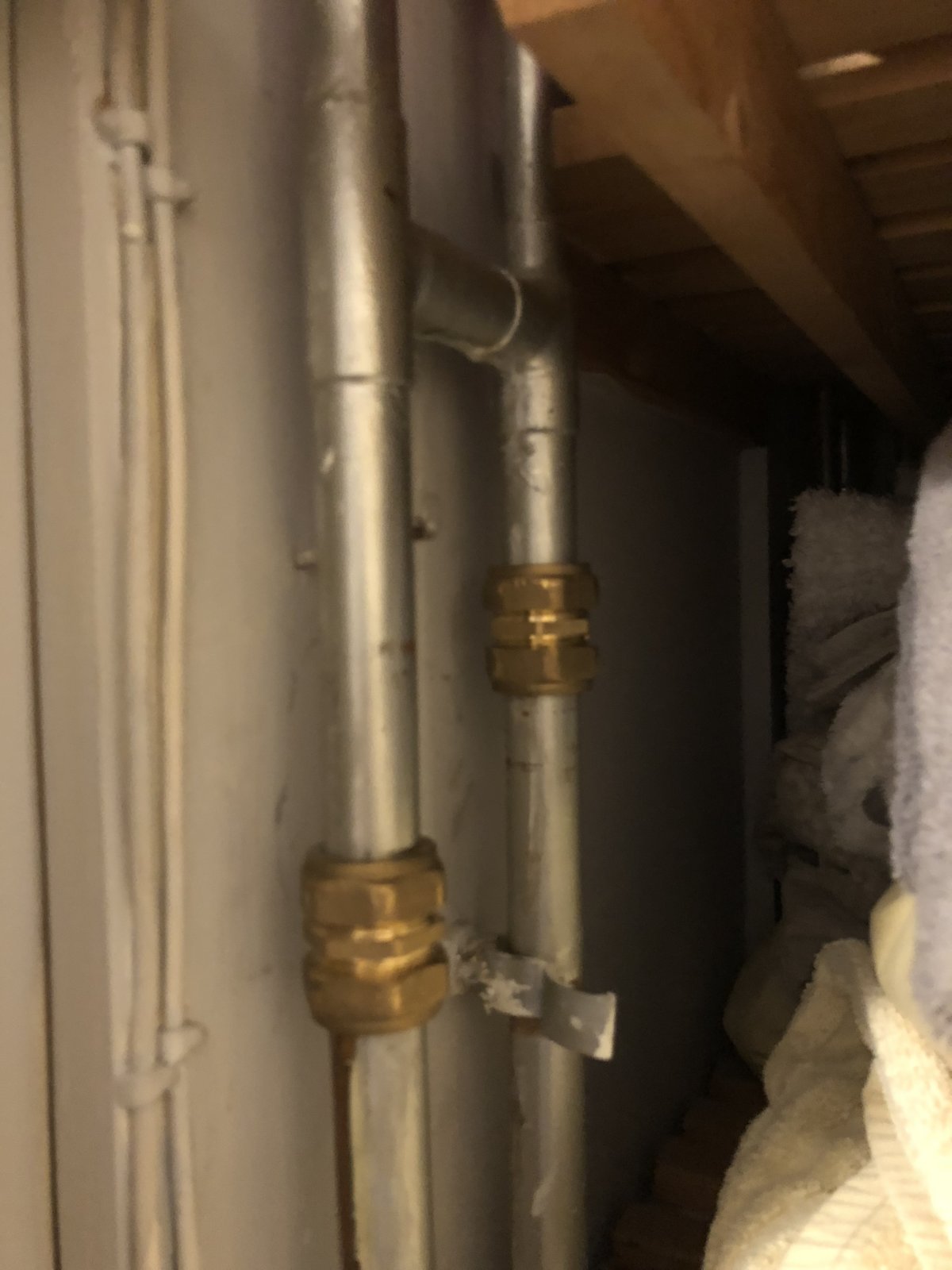

Here we go. Magnets stick to the top and bottom of the horizontal join between these pipes
This is the rest of the (mess?)
