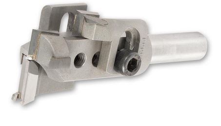

The problem is that the bit you are talking about has both a centre point and spurs at the outsides of the wings which will leave a groove around the outside.
To the OP - if you want to drill this you'll have to accept that drill bits for wood NEED to have a centre point to keep them from wandering off track, which is why even Forstner bits have them, albeit very small ones. Almost all other drill bits will have nickets or wings at the periphery of the cutter which are designed to cleanly slice the fibres to make drilling more accurate and less tiring. So unless you can accept those technical limitations, drilling is out. If you really need to make a perfect hole, then you are going to have to invest in a plunge router, some straight plumge cutters, some guide bushes - and you'll need to invest some time in learning about routers and guide bushes and how to use them.

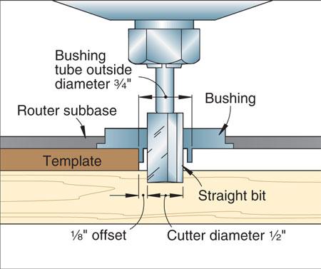

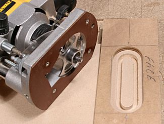

Examples of how a guide bush works:
The reason we use guide bushes is that they are far less prone to causing damage to a template jig than other methods of routing (especially with less experienced operators), but the guide bush most obviously be larger that the cutter, so the hole in the router template jig must be made bigger, e.g. with a 12mm diameter router cutter and a 30mm guide bush the outside edge of the cutter is inset 9mm from the outside of the guide bush. To cut a 45mm diameter hole, the hole in the router jig will need to be 45 + 18mm = 63mm. A 63mm hole in a plywood template could be made with an appropriate-sized hole saw or using the adjustable boring bit proferred above

Ah right I think I understand now. So if I make a template from a hole saw near enough 63mm. Then using the guide bush at 30mm I guide the plunge router round the template giving a perfect hole?
OK so if I use a 12mm bit put it into a 30mm bit that gives the 9mm inset of the bit as it's 9mm on each side of the bit. This is where the 18mm comes from. So then you take the hole you want to make and add the inset giving you the template size? is that correct? I am thinking so I can make other ones in the future.
Then just clamp the template on the wood and just follow it round to make the desired hole? I presume that the guide bush sits inside the template and rotates inside?
Thank you
James
Well almost.....
The 18mm is 2 x the offset from the cutter to the guide bush (inset was my attempt to describe this the other way round....). But fundamentally the idea is to be able to "productionise" the hole making
Yes, however the guide bush doesn't rotate. It just rubs against the edge of the template jig. Otherwise I think you've got it
