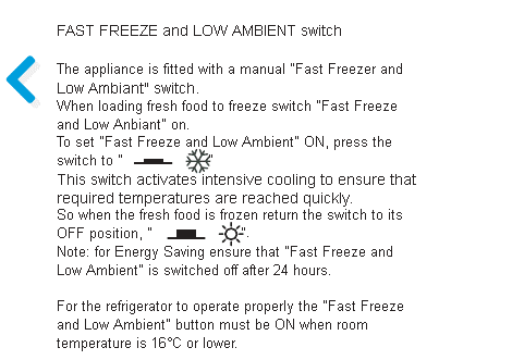

I've got a hot point frost free fridge freezer, it's in flat rented to tenants. The fridge part is iced as in pic attached. It's set to the lowest 1. There is a manual switch, photo and function from manual are also attached. Any ideas?

Would the fridge section get iced if the fast freeze button is pressed all the time? I am going there tomorrow to check ...

I tried everything then called HOTPOINT to have a look, the engineer said fault in the insulation which is at the back of fridge compartment, beyond repair. They didn't charge for the call out; fair play.
