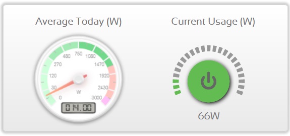

This is the reading from my freezer, it does not tell you much, this
is possibly better as it shows the average, much depends on how your meter displays, mine connects to PC so easy to show what it displays without needing to take a picture. So 14 watt average = 123 kWh/annum which is a bit low so would guess I had not been monitoring long enough to get true reading. At moment letting freezer get very cool as going to turn power off tomorrow, so started to measure around 11 am, and it's showing current 60W and today average 63W that is clearly incorrect as did not start measuring until 11 am and peak is no more than 65W. So should be showing around 40 watt average for whole day.
