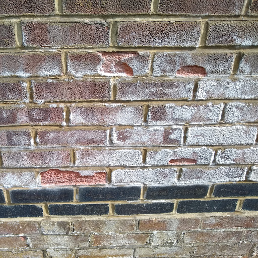

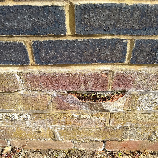

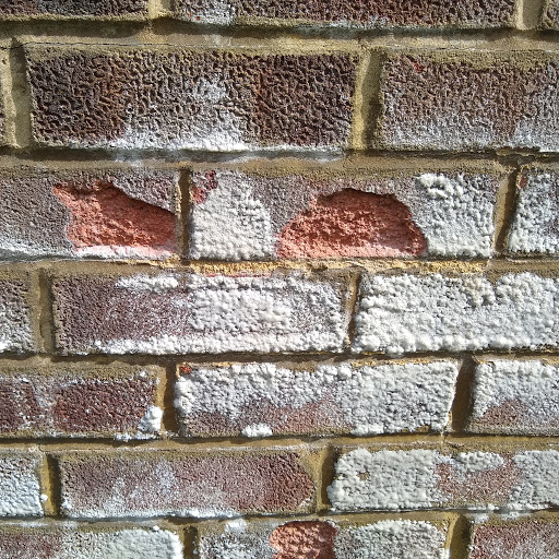

Hi, I am new here and wondered the best way to deal with the frost damage on my front garden wall. I am not up to chopping out bricks but wondered if using frost-proof mortar on the fronts of bricks that have fallen off will be ok, or treatment with a sealant of some kind. many thanks for any help. wall1.jpg wall2.jpg wall3.jpg
Smudge it up with a sharp sand/ cement mix. It won't look any worse than what's there now, and will last as long ad the rest of the wall.
