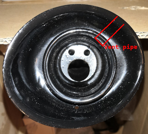

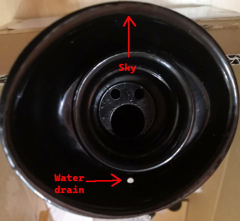

I just received a very reasonably priced china fuel filler neck for micra k12 from an ebay start up. The interior bits are not same as the original unit. So, can anyone tell me if this is OK for use? I think most of the sellers are selling this exact same thing.

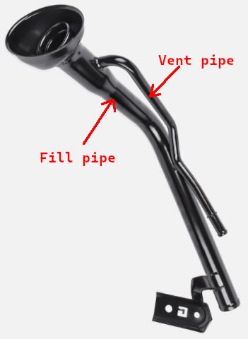

On the original unit, the fill pipe has a small flap that opens to accept the petrol station nozzle. Then, the tank vent pipe vents separately from the fill pipe. On the new unit, both the fill pipe and vent pipe share the same space behind a face plate. The big hole on the face place takes the pump nozzle. The small upper holes enable venting. The vent pipe joins the fill pipe immediately behind the face plate. Is it a problem for the vent pipe not be given an outlet isolated from the fill pipe?

Anyway, I think the bits in the oem neck enables the auto shut off to work for the petrol station pump because the pressure built up in the fill pipe is not immediately vented as this unit does. I am guessing there is no rule that says the car must have this feature. This would explain why german made units appear similar to the chinese ones.
The job was a fail. The china neck didn't fit. Will be returning that for full refund because item wasn't as described. Found a couple of places that sell the genuine part. One place wants £240 for it. Presumably VAT and import duty go on top of that.

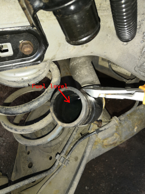

There is an oddity. The fuel gauge says empty, but the hose below the filler neck contains fuel. This seems to suggest the tank is full. In that case, the level sensor in the fuel pump might be defective. Will have to add 5L of fuel by hand to see if the level changes. If not, then at least it would be safe to drive to the petrol station to attempt a top up. Failing to top up will pinpoint the fault to the level sensor.
After examining the original filler neck more closely, I am concluding the aftermarket ones are legit as long as they fit. The original neck also allows the fill pipe and vent pipe to share the same space behind the face plate. The only difference is the OEM unit has a self closing flap for the petrol station nozzle. Nevertheless, both the fill and vent pipes remain permanently vented through the smaller holes on the face plate.
A full refund was obtained for the ebay unit while I am getting to keep the unit. But, I don't have the equipment to bend the mounting bracket into shape so that it could be used. They used thick steel.
Currently returning an aliexpress unit because that didn't fit either. The bracket was easy to bend but the neck was too short. I might have lost money on that because bending that resulted in marks and lost paint.
