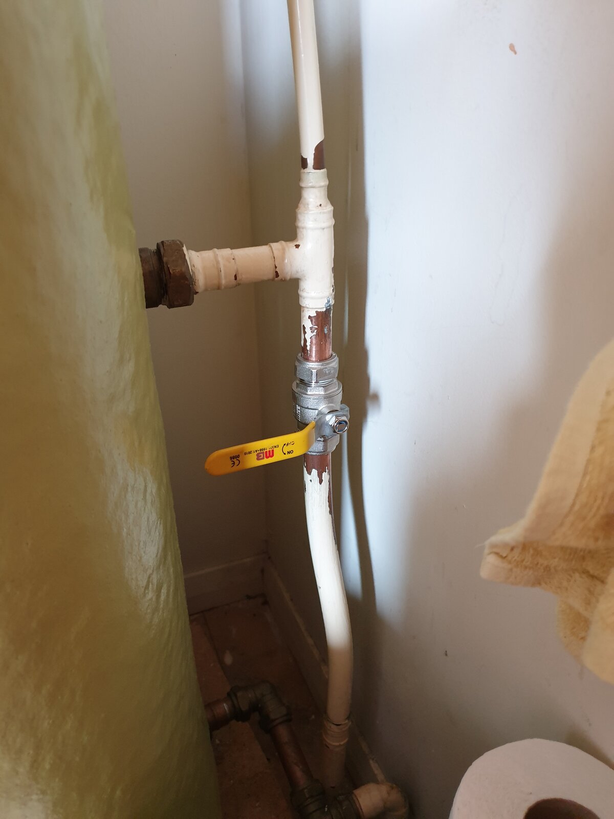

Just a very quick update. I am beyond delighted.
Plumber came a few weeks ago and fitted a valve, he only charged me £20 in total.
Boiler got fixed today.
For the first time ever, I have burning hot radiators, all of them. The radiator in the back bedroom never used to even really get warm before, its now very hot.
Happy with the £20 temporary fix until I can get the whole system redone.
