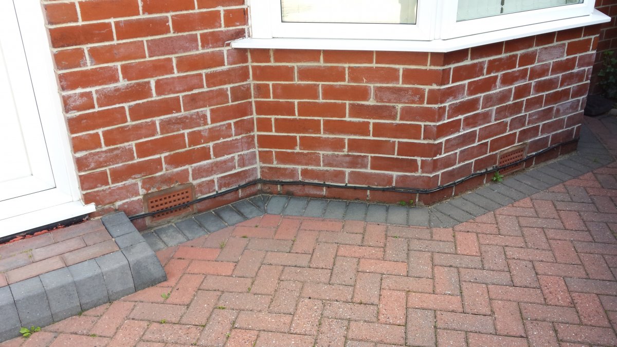

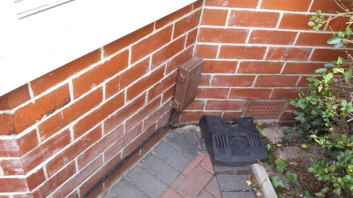

Yes it is.. The block paving sits about 3cm under the air brick see pic.
So looking from the inside it will be just level with the dpc
The dpc level is where the missing brick is.. It's cracks easily if touched, has it had its day? Having said that most of the soil I dug out was at dpc level too.

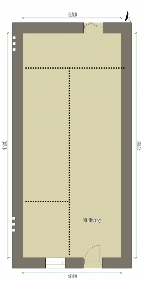

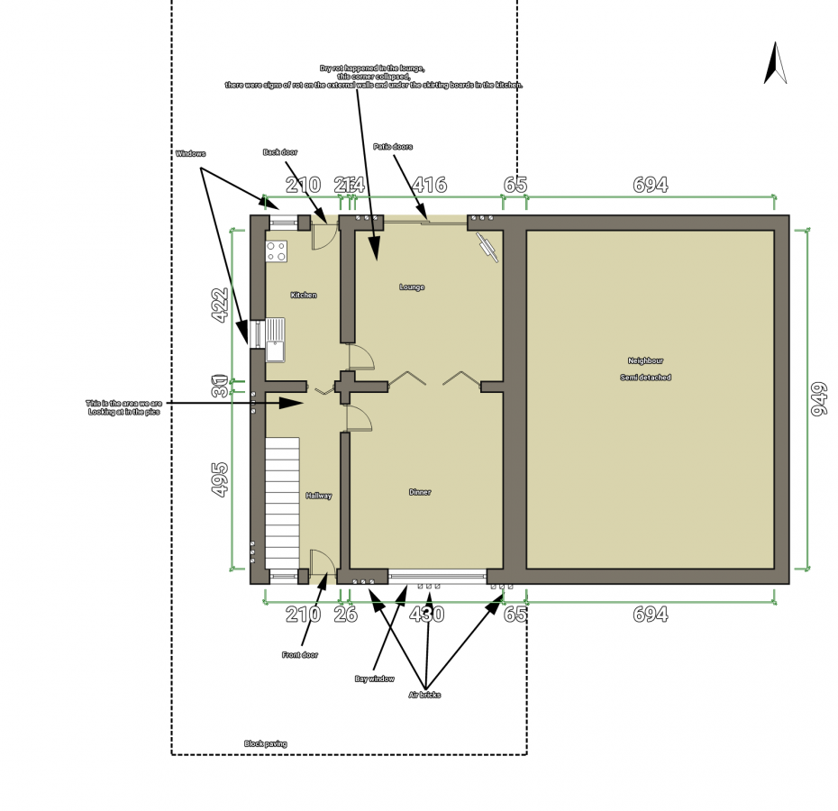

1. post a plan view of your house, a similar one to drpepe's - dont use his sketch its confusing, (perhaps remove the double post you've posted in another forum - thats confusing too).
2. Indicate where the air bricks are all around the house? Are any floors solid?
Air bricks indicated on diagram, only the kitchen floor is solid.
3. indicate the areas shown in the pics. Is this the area of the dry rot attack?
The pics indicate the hallway, kitchen side. The pics are of the outside hall wall.
Dry rot attack was in the lounge, the corner between the outside wall and kitchen wall collapsed.
Have you had damp and timber inspection and report?
Nope.
4. show where the block paving has been installed.
As shown in diagram in dotted lines, it goes all the way round the house.

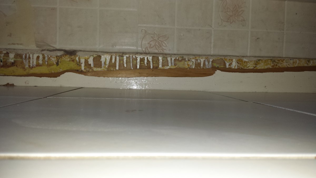

8. a pic of the skirting and interior wall above where the floor collapsed.
Pic to come:
But nothing to see all joists, skirting, wall paper, floorboards, laminate flooring, underlay etc has been replaced by builder/joiner. All cleaned out of rubble and debris.

ref. item 1. thank you for the clear and prompt diagram, it truly helps.
2. you appear to have plenty of air bricks.

4. the block pavement is obviously too high and bridging the outer skin DPC but unless the cavity is full & bridging above the DPC then rising or penetrating damp cannot cross to the inner skin.

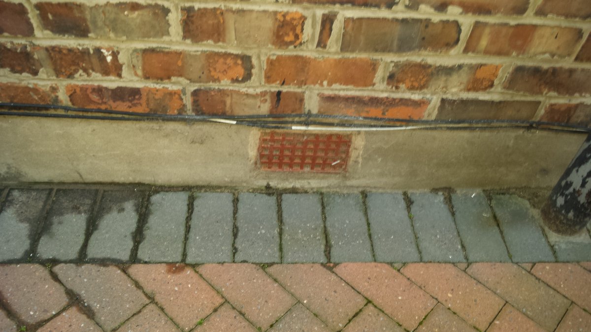

6. the plinth is bridging the outer skin DPC and was perhaps installed as a remedial measure.

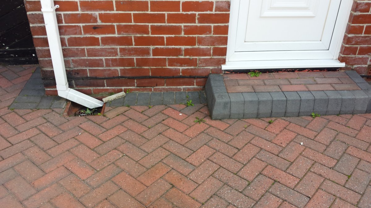

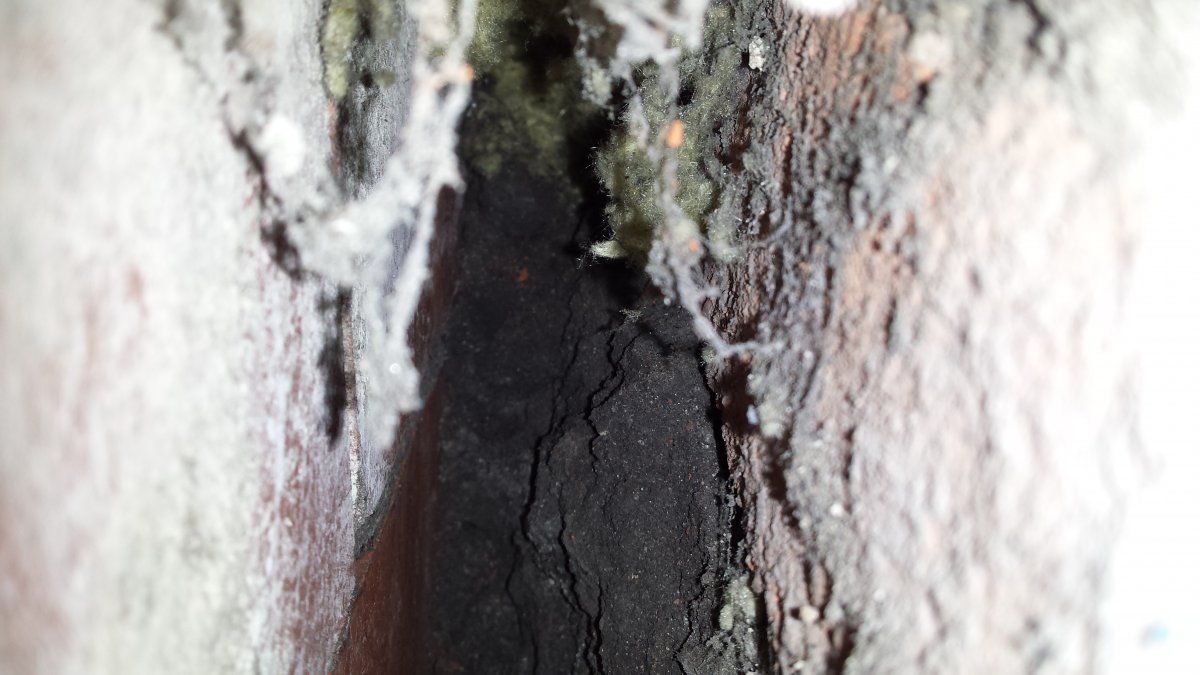

If the cavity is "full" then it must be opened and cleaned out. Cavity pics please.
There may well be bridging in the cavities there is a lot of rubble and soil coming out of the parts I have access too.. I am doing my best to remove what I can?
What kind of remedial measure... Im not 100% certain but I think there were a lot of blow bricks now covered by the plinth? :cry:

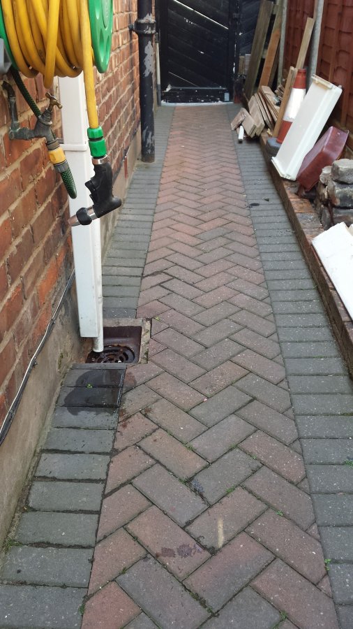

7. pic of the side elevation please.
Side elevation:
Front elevation left to right:

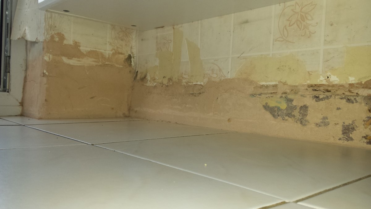

They all seem ok no signs of any horrors
14. there's not much to do or see in the kitchen - look in and behind units and appliances and minutely examine the wall and floor junction with the wall thats had the dry rot work done.
There was rot on the skirting in the kitchen, I ripped the affected parts off and waited to see if it got worse. It didn't and has now dryed out. I knocked it back to the brick just to be sure.. The builder/joiner obviously didn't check this.. Another cowboy.

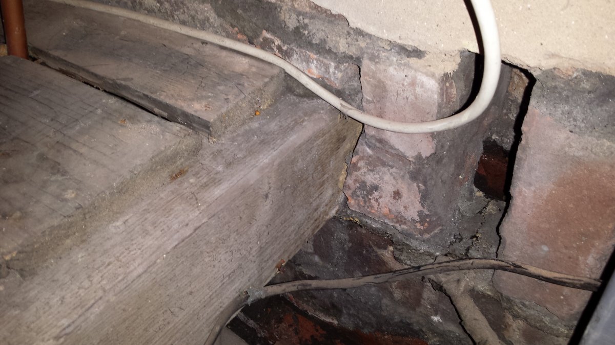

3c. joist tails resting in bays and chimney breast recesses are the most vulnerable to fungal attack.
You seem to have reasonable air brick ventilation at the front elev. altho i cant see an air brick on the front face of the bay? There's also quite a bit of efflorescence to be seen on the front elev - why?
The raised front step is bridging the DPC, and possibly blocking air vents below the door cill?
4. as you have probably realised, you will have to open up the inner wall skin to reach into the cavities.
But all debris must be lowered below the DPC level. Knock down any snots you see clinging to cavity ties.
Sometimes its necessary to open up the cavity from the outside. Done carefully, all the bricks can be preserved and replaced.

6. Retro plinths were typically added as a mistaken remedial measure after discovery of damp in the house or to cover blown bricks. They typically can make things worse by bridging DPC's. Removing a small section might indicate the state of the bricks behind the plinth?

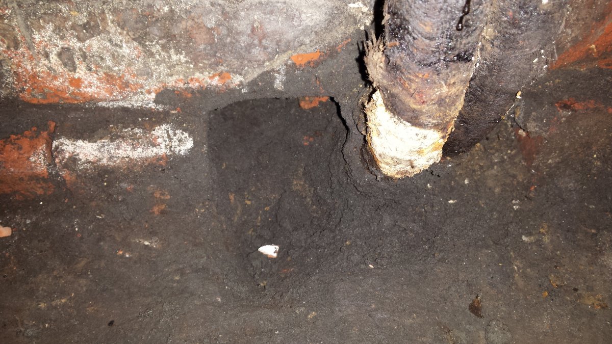

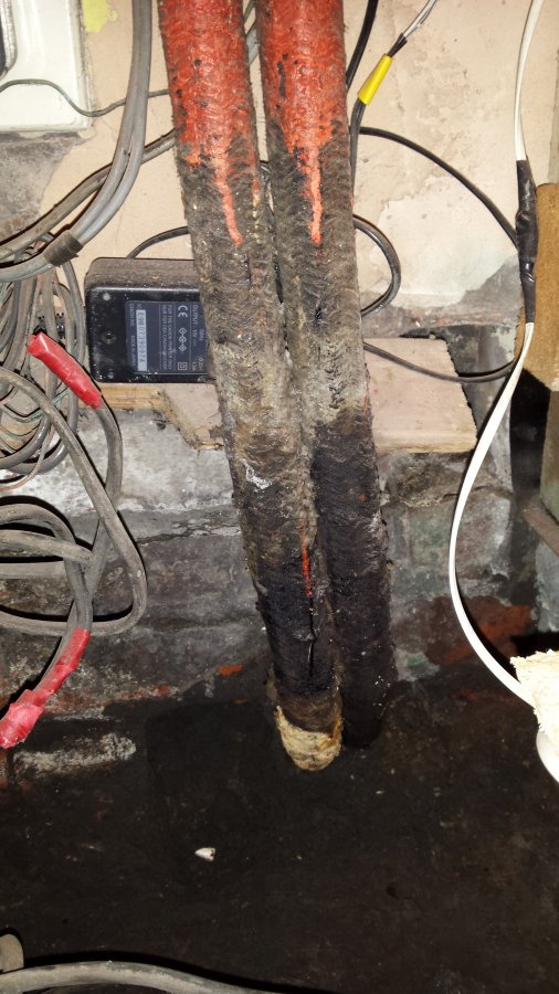

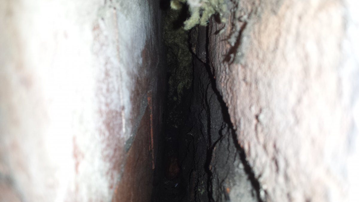

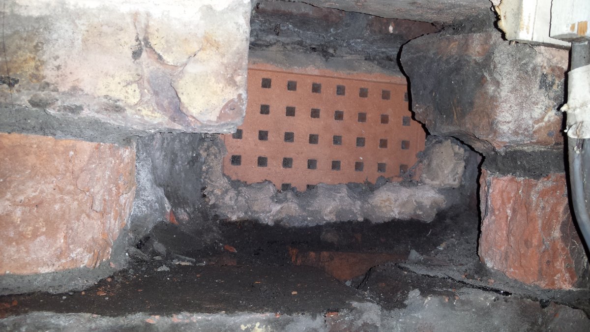

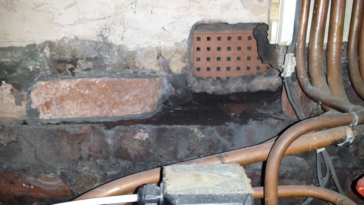

14. What am i seeing in pic 1. - after remedial work or before?
In pic 2. what was the dark cobwebby wispy material on the left?
There are suspicious signs of "something" in the cavity pics - could you hook out and pic some of the green sparkling material, and some of the white stuff (does the white stuff have strands?
The black grainy debris in your cavities is most likely mortar droppings from when the walls were carelessly built.
There is one on the front bay, 3 in total on front evaluation.
I don't think it's efflorescence, some of the faces of the bricks have blown, I don't know why they were like that we we moved in 30 years ago. We had the front elevation repointed, I think k it's the residual white mortar that's embedded in the blown brick faces.
There's no air vent there but I see your point about dpc bridging. I will see if I can get any dpc between the step and wall.
After.
I think you mean the old paint that was under the skirting.
Green stuff is the rock wool insulation that was blown in. The white stuff is not there any more, it was hoovered out, I think it was just cobwebs?
So smells and feels like soil though?

14. If you as DIY'er re-plastered the wall then so be it but if a professional did the work its not up to standard. Plus, we always rendered with S&C or S&L&C never using gypsum plaster (which you have on the wall).
The plaster should have been removed up to the work top(?).
I suspect that the dry rot entered the kitchen thro the cavity.
Just keep a future eye on all "remedial" areas, & the opposite side of that wall.
The "white stuff" was not cobwebs - however if you encounter it again then pic and post please.
It was me(n) I was getting moaned at for it being down to brick for months, so i just put on what i had available at the time. May I just ask why s&c (i presume this means sand and cement) as opposed to gypsum plaster..S&C I always though was mortar, as for bricks, but is it suitable for plastering?..I imagine its a lot tougher when set? does it go on easy too?
It would have been if I had seen it getting worse, luckily it dry up and went away.
I will do you think it was dry rot strings? I thought it was cobwebs covered in dust from the upper cavity, and the fact a huge spider came running out of there :eek:

No, the block paving issue is irrelevant. The cavity in question was the rear elevation cavity. Your difficulties appeared to start with a lack of thro ventilation.
FWIW: in the spider's webs, and on the wall - what was that white stuff?
I don`t know, it might have been thoses crystals again, or is it effervescence? I will see if I can find anymore.

I have shot some video under the floors I will post up soon, no air flow front to back as there are 3 layer brick walls under there.??(n)
Today I was under the stairs and once again i was digging out more rubble and soil, its definatly wet clay like soil thats wedged in the cavities? how has that got in there I dont know?, But also where the mains electric comes into the house, it seems very wet around there? like thick mud, although after digging some out it seems to have dried up a tad?, some white crystal type things too?
Also noticed the joists are not capped and just resting on the damp course, I can also see what looks like saw dust at the bottom of the joist where it enters the wall, I presume this is rotting away....I need to get a closer look..
some pics:
Mains electric in:
Very wet down here:
Un-capped joist into outside wall, there are 3 of these:cry:
In my #18 post i mentioned the possibility of rotting joist tails.
The rats nest at your mains installation should be pic'ed and posted in the elec forum on here. Ask for views. It doesn't look safe, and why is the (live?) meter on its side, & is that black rubberised cable in pic 3 still active?
I'd forget about digging in that vicinity.
