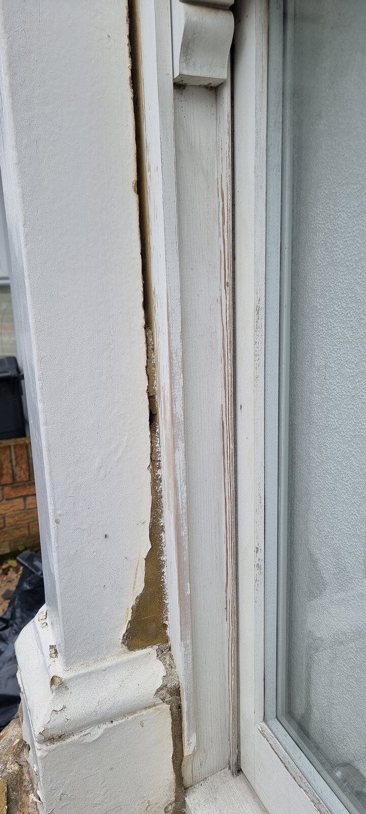

I am redecorating my wooden sash windows. They need repainting obs and the gap needs filling. I'm thinking of using sika mortar fix or a sand/cement mix.
What's best, paint the windows first and then seal or the other way around?
Don't know the sika. I'd use troupret masonry powder filler.

Whats a better way, fill gap first and then paint, or the other way round?
I use clear solvent primer preserver on wood then fill.
You have to wait a week or more before painting over (read data sheet online for guide) but you can carry on and fill.
The primer preserver will get right in the wood protecting that wood.
Some would prime first using waterbased primer but I prefer to use the solvent primer preserver. Lash it in as easy to use. Won't matter on masonry.

Thanks. Sorry if my question was confusing. I meant to ask about filling the gap between the bay and the window frame first and then paint the the windows, or the other way round? Does it matter?
The wooden window/sashes don't need filling.the wood is as good as new although the preserver will prolong its life I'm sure.
I'd prime with undercoat or use the primer preserver before filling against the wood. To protect.. Is that what you wanted to know
