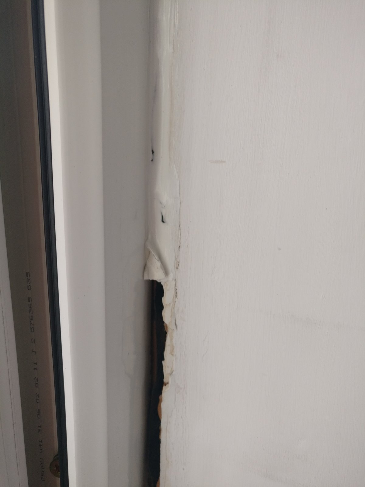

Please see photo attached.
Decorating the spare room and getting rid of the old silicone botch job around the window ready to install a neat window trim.
The silicone is so thick and has exposed a large gap (10mm) from window to where the plasterboard/window sill starts.
Can I just install the trim over the gap? Or I'm thinking of an extra bead of silicone to seal window frame to brick wall as extra protection, then install trim.
Or is there any better ideas?

In no particular order:
1. Filler, light sand, caulk and repaint reveal.
2. Expanding foam and glue on trim
3. More bodging sealant
Should get you started:LOL:
I'd squirt some expanding foam in there and all the way around if you can, it'll do wonders against cold bridging if you were to ever suffer from it, unless you've got a foam gun then a tip is to protect the window with 2" wide masking tape if your going to use a diy can of foam, can be very messy and saves an hour of scraping dried foam off your windows
What's the filler and light sanding for if your going to trim over it! :cool:
