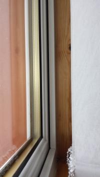

Gap on hinge side of window
5 Oct 2014
2
East Lothian

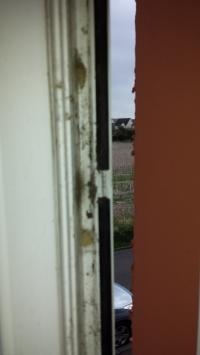

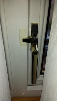

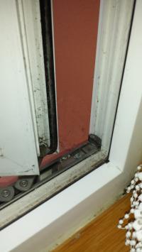

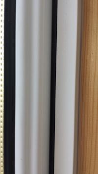

The two upvc windows to the front of my house have slight gaps on the hinge side which is more apparent at the centre is there something that can be fitted that would help pull it tighter? also the rubber strip around the edge seems to have shrunk it an easy job to replace this? the windows are about 16yrs old.

http://www.ebay.co.uk/itm/5-SETS-SASH-SEAL-UPVC-WINDOW-WEDGES-HELP-STOP-DRAUGHTS-/190364204131?pt=LH_DefaultDomain_3&var=&hash=item2c52973c63
Fit one on the frame, one on the sash.
Magic Nooz that's exactly what i'm after thank you :D
Also clean and lubricate your hinges or the gaps will only get worse as the hinges ware out.
