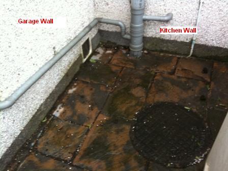

1. The wall opposite the double garage doors (basically the rear wall of the garage) which has paving/patio slabs on the outside that are built up against the garage wall - with no visible drainage in place.
Paving is rather uneven and water that lands on the first two rows actually runs towards the garage wall (I would assume that the concrete base/bed has sunk or dropped over time).

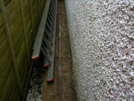

2. The wall opposite the main house which has (on the outside) an approximately 18" wide cement slab with a runoff channel in the centre that runs towards the front of the garage where there is a drain (due to an inconsistent pitch, water does not run effectively).
Between the edge of this slab and the neighbouring fence, is about a 6" drop to what must be the ground level.
Here are two pictures showing the outside of each problem area - you can see a small amount of water pooled in the channel down the side slab in the one photo.

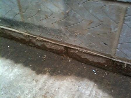

On the inside, all of the way around the base of the garage, there is a single course of bricks, above which is the DPC and then garage block walls.
The damp patches are all coming from that first course of bricks BELOW the DPC.
The top/surface of the slabs/pavers on the outside are an inch or so above the DPC --- I realise this is vague, but I do not know how to do an accurate measurement --- bottomline is that water lying on these these slabs/pavers are definitely higher than that first brick course, but not by a huge amount.
Here is a picture of a damp patch on the inside.

Hi Steve, a quick summary, right, I think the obvious 2 major issues here that are contributing to the damp (although I found your post a bit hard to follow to be honest - but I tried my best to stick with it) are as follows:-
1. The flags / 'cement slab' externally need to be set with a fall away from the external wall of your house.
2. The DPC should be approx 150mm above external ground level - and from your post you are suggesting the DPC is actually below the external ground level. Is that correct? How have you verifed the position of the DPC?
If both the above are true, as a start, it's time to get the shovel and pick out :cry:
As hotrod has said, The ground level outside should be at least 150mm or two bricks below the dpc. If this is not possible without major work then you may get away with digging /cutting a channel 4inch wide channel down to the required depth and then fill this with clean stone. Ideally try to get a slope on the base of it or at least not big hollows in it.
Your other problem which is much harder to deal with is the fact that the damp proof membrane under your garage floor is clearly not overlapped with the dpc in the wall meaning any damp in the cavity caused by your high outside ground level is simply soaking into the floor slab.
I had a customer with the same problem last year and a full land drain next to the affected wall sorted the problem but this was due to the wall being at the base of a slope.

I can confirm (I have tried to make this more apparent in my rewording this morning) that in both cases water is not running away from the walls properly.
This issue is a lot worse at the back --- I was cleaning the pavers with a hose a few weeks back and a pool of water about an inch deep collected right up against the garage wall. From about the second row of pavers, the water then runs away from the walls towards the rear garden.
On the side of the garage, if you look closely at the picture, you can actually see that there is a constant green moss growth along the sourface of the cement slab where it meets the wall --- so I would assume water does not run away from the wall properly?

If the sodden earth is below your dpc then it will only rise up the wall until it hits the dpc but if the earth is touching the wall above your dpc, water will seep into your cavity and then seep into the inner leaf of the wall. It will then climb that wall until it hits your inside dpc and then will not go any further.
BUT Because the concrete slab forming the floor of your garage is below the dpc water will seep out of the inner leaf below the dpc and form pools of water at the joint of floor and wall.
In normal construction there is a membrane under the slab which in run up the wall past the dpc/ tucked in underneath it this forms a continuous barrier against water.
So in conclusion, Simply re-bedding the slabs so water falls away from the house will help but will not fix the problem. To fix it you need to reduce the ground height outside to below dpc.
