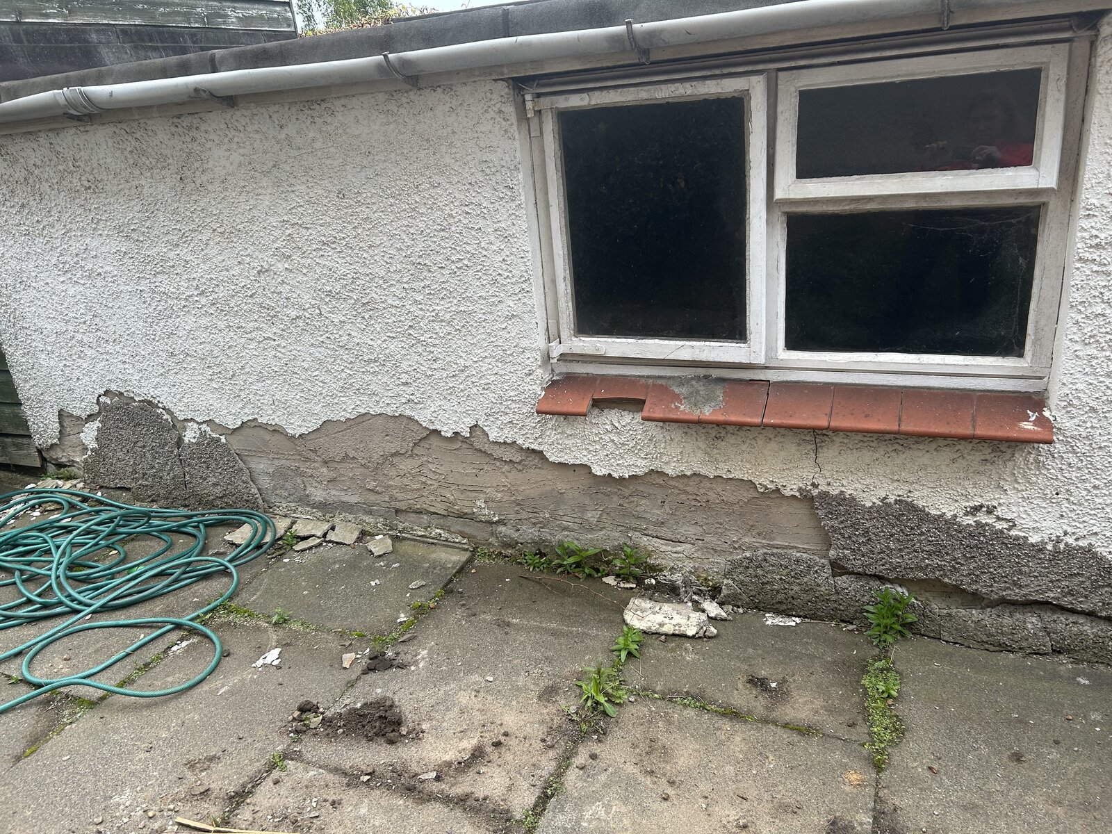

OP,
Take it back to brick.
Scarify the first coat & allow first coat to dry for 24 - 48hrs.
The new render should finish with a plastic Bellcast about 150mm above ground level.
Use plastic angle beads.
FWIW: your gutter is a bit wonky?
