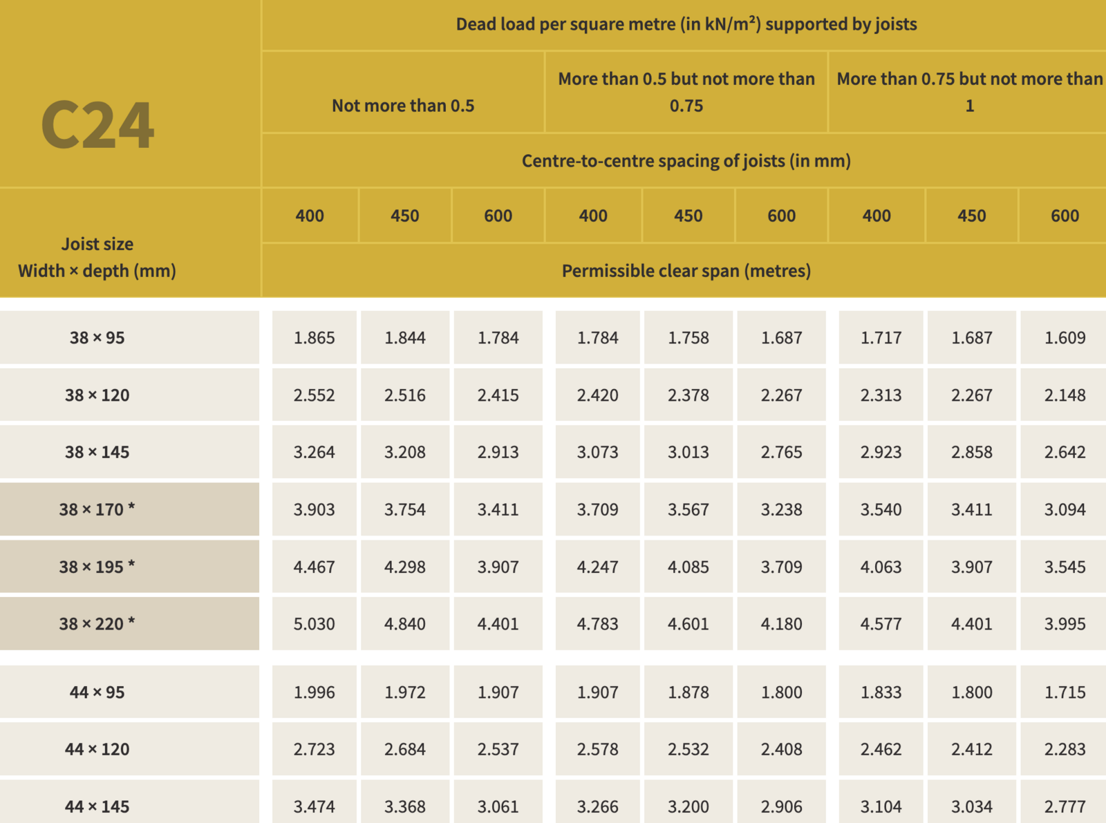

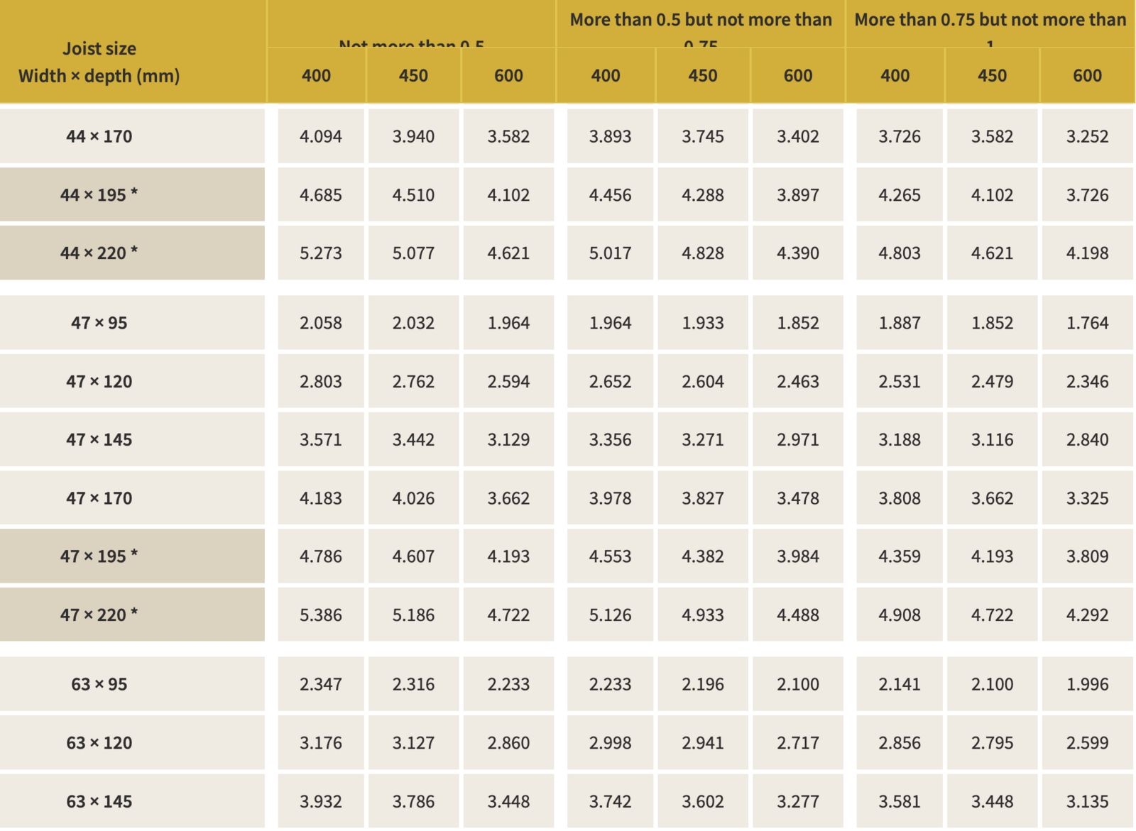

Hi,
2.6M span with 125mm X 47mm C24 @ 600mm centres. Topped with 18mm OSB and epdm rubber. Its a sectional concrete garage (2.6M X 4.8M) looking to replace current roof with a new flat one. Does this sound ok?
many thanks
Ok thanks looks like it will have to be 125mm @ 400mm spacing. Seems like overkill especially when my old shed is only using 50mm thick joists!
Now you got me looking at tables it does seem to be open to interpretation :unsure: Is there much difference between c16 and c24? tanatlised VS untreated?
Treated v untreated relates to its protection against insect, rot, mould attack etc.
For a garage project with a 2.6m span I wouldn't loose any sleep over c16-24.
I would use the deeper joists to prevent sagging under snow loads and foot traffic.
