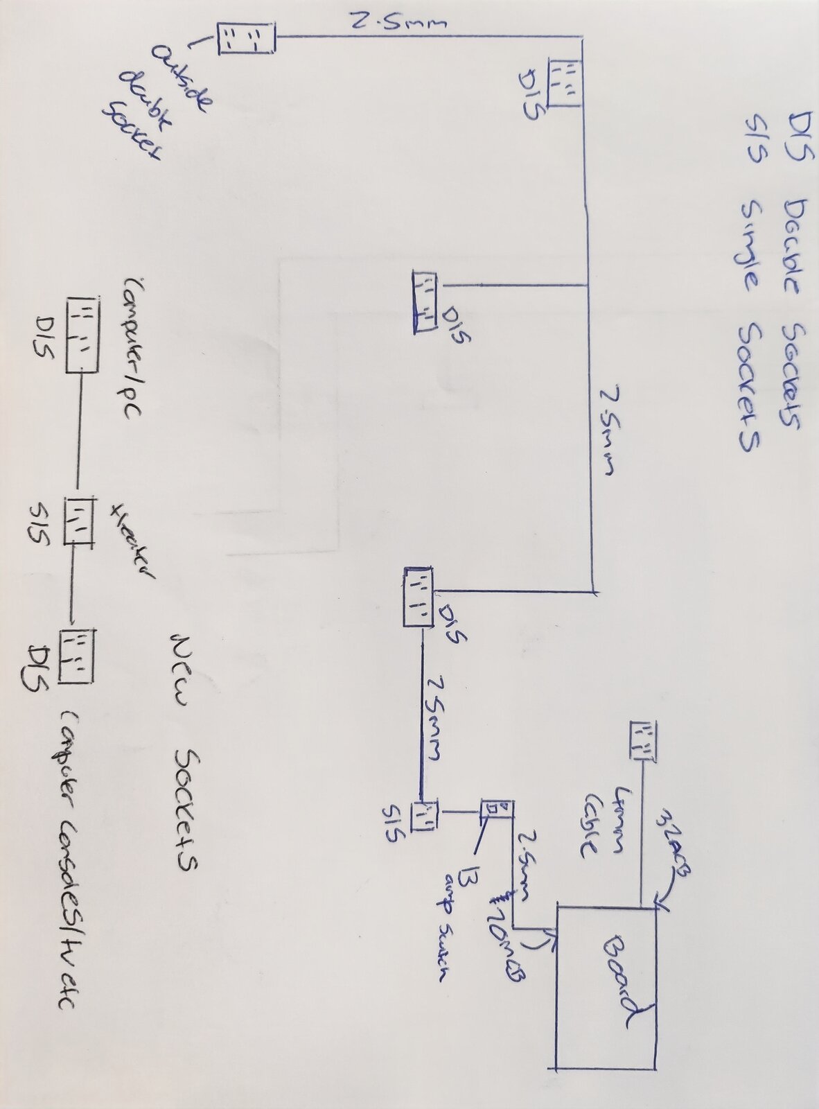

Hi
I'm looking to add some additional sockets in garage shown in black pen. Am i able to connects these to 32mcb socket using 4mm cable on a radial? Does the 2.5mm radial already there look OK?
Can't really tell the difference.
Yes - assuming the cable is clipped to wall or buried in masonry.
Yes - with the same proviso.
You don't need the 13A switch (Fused Connector Unit ?) when there is a 20A MCB.
Thanks. Yer the 13a switch was already there with the 20a mcb.
