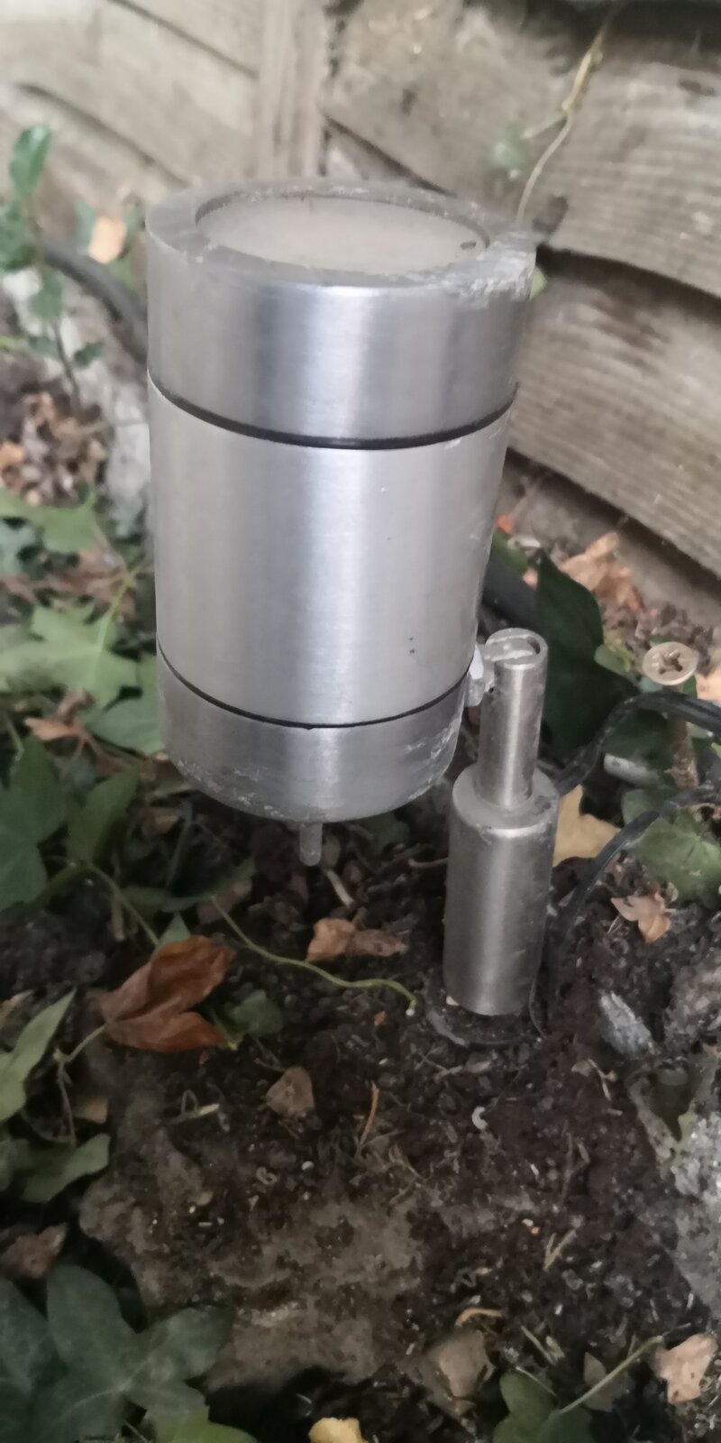

hi,
I inherited these garden lights from the previous owner,not one is not lighting up. Any ideas on how to replace the bulb and also where I can purchase these types of light?
Many thanks.
Can you remove the bulb cover ? If not the light fitting might be sealed for life.
Blup
Struggling to remove the bulb. Rest of the bulbs are working, just this one is off.
My best guess would be that the top or bottom sections unscrews. Get hold of a couple of strap wrenches, as used for car oil filters - Try holding the bottom with one and turning the top section with the other.

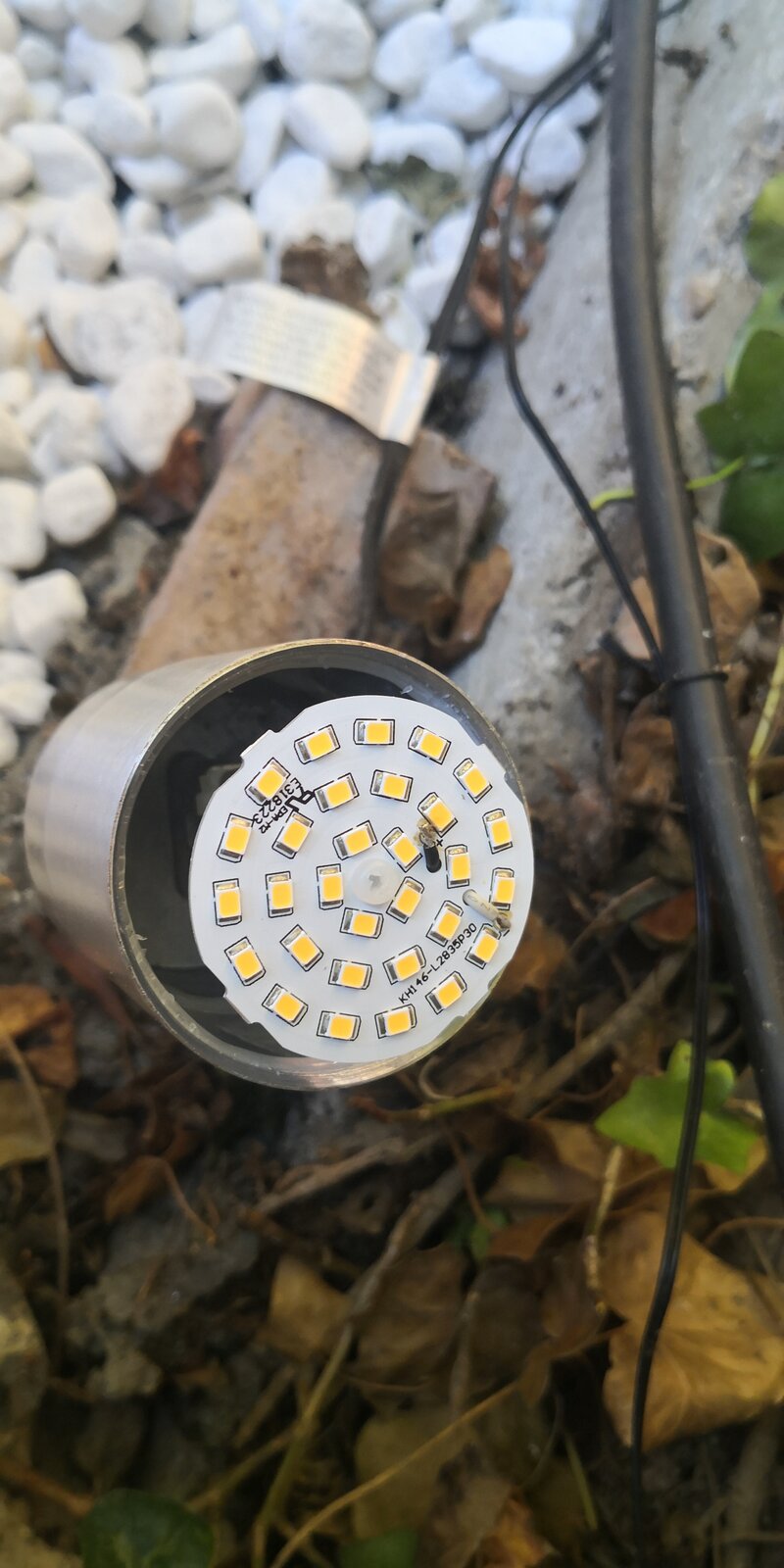

Managed to remove the cap off one of the other lights with my hands..
I don't suppose that LED array can be unplugged to replace it?
Your best way forward, will be to check there is in fact a 240v supply at the light and if there is, maybe see if you can track down someone local with electronics ability to see if the unit can be repaired. It might be something as silly as a capacitor dropper, where the capacitor has gone open circuit.
According to q&a on the website it seems that these have integrated LEDs in non replaceable sealed units.m
Quite expensive, so well worth seeing if a repair might be possible.
I would not expect LED arrays to be replaceable, which was why I suggested it might be possible to find someone knowledgeable to repair the LED array. As said, I would check the unit has a mains supply going to it, before worrying about repairing it.
