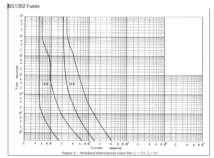

I didn't realise that the fuse would only blow with 22A. Is that continuous or a surge of 22A? Doesn't sound very safe lol
'Continuous', I'm afraid. See the graph below. For it to even blow within 10,000 seconds (nearly 3 hours) (and probably 'ever) would require a continuous current of at least 20A. You have to understand that the purpose of fuses is to protect cables, not to 'limit consumption'.
