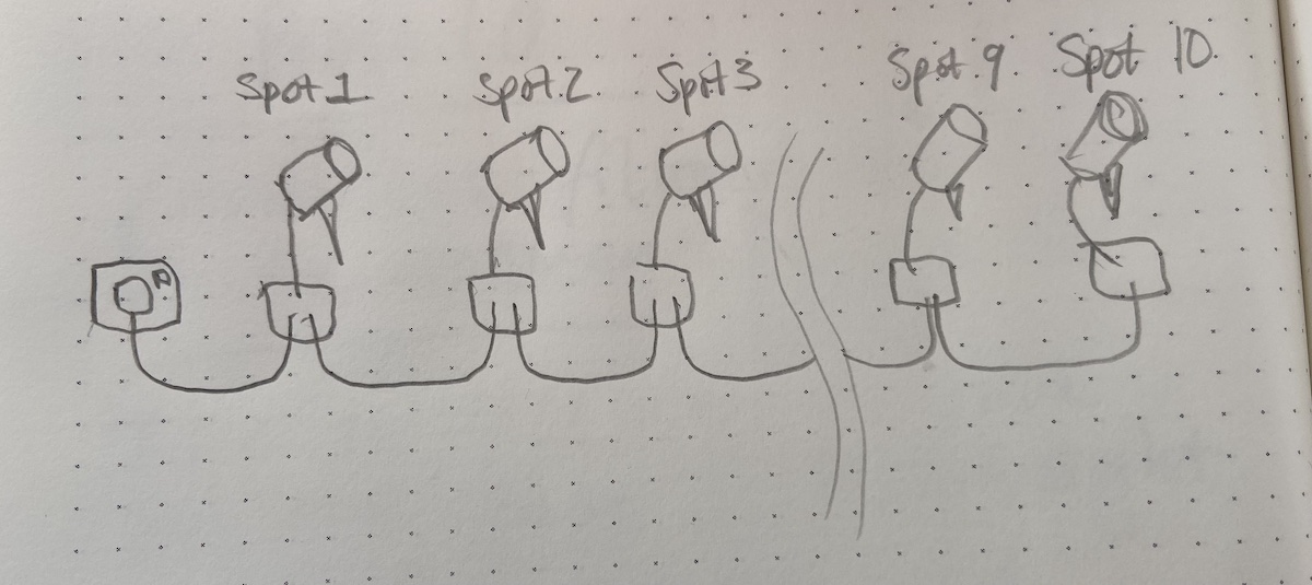

Hi - can someone tell me if the following looks right for connecting 10 garden spiked spot lights to a plug please? Thought I could run armoured cable from a plug to first Wiska box, then between the following boxes with the lights coming off each.

Yep, can use regular flex to the first Wiska box. Probably wouldn't need armoured elsewhere either as can route along a fence.
