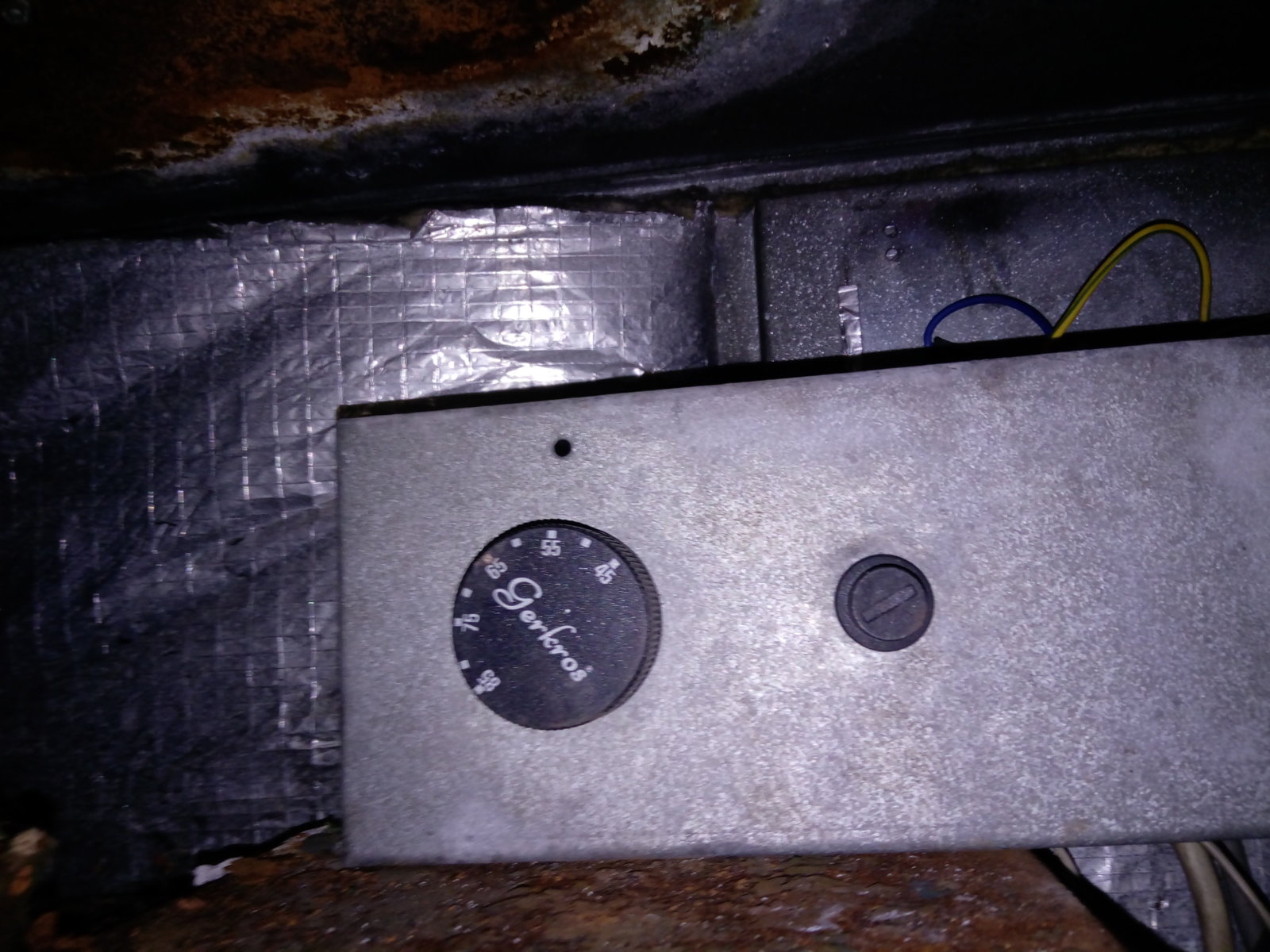

Gerkros thermostat not operating on domestic boiler. Boiler working ok but not cutting out at set temperature. Can a like for like replacement be purchased or can the thermostat be repaired? I have done a quick search online but can't see a similar thermostat
Thanks Oilhead. I actually have a spare IMIT thermostat however the probes on it wont fit into the boiler housing. Can I remove the probes on the IMIT thermostat and replace them with the existing probes on the Gerkfros thermostat?
