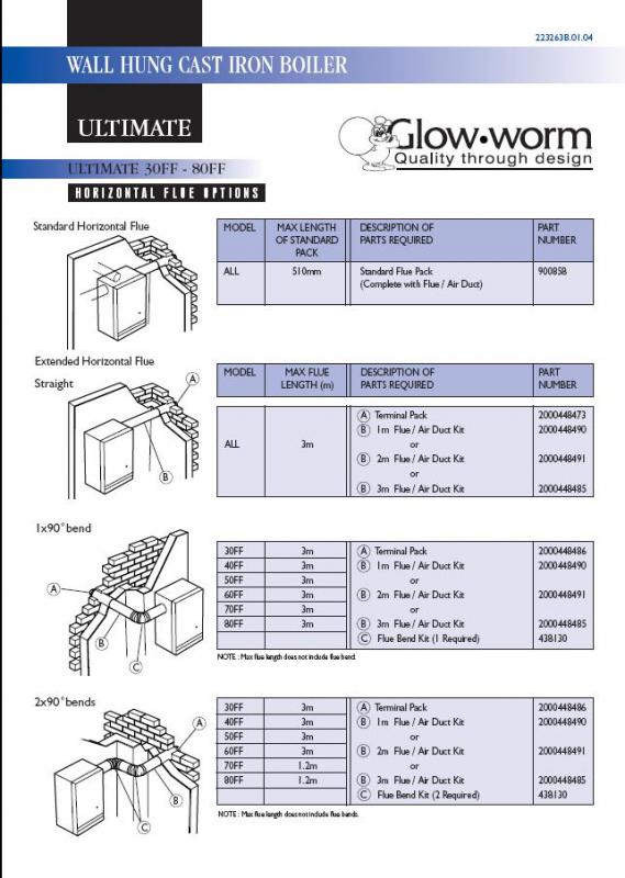

A bit of luck at last, someone kindly sent me Gloworm's flue options list for my boiler, see below, so some part numbers to work with at last
Spirits raised a search on Google revealed a number of pages referring to a part number, my euphoria was soon dashed as one after the other led to ‘dead’ pages from 4 or 5 years ago... Ho hum.. :(
So where do you come in you ask, well for those of you looking for a challenge I’m willing to offer a prize to anyone who can locate the parts listed below... now I did think of offering to have your children but sadly I’m way past childbearing age, so how about a cash prize, works for most, of say £100 plus of course my eternal thanks (probably worth nothing) and as a extra special bonus you can come round and fit it too, am I generous or what :D

So parts required for a Glow-worm Ultimate 50FF are..
2no. 438130 bend kits
2no. 2000448490 1m extension kits (or 1no 2000448491 2m extension kit, or 1no 2000448485 3m extension kit)
1no. 2000208600 weather collar for a tiled picthed roof
