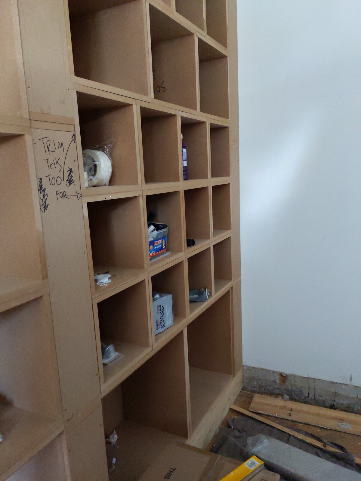

Hi all
Am attaching a pine fascia to raw MDF edges, on a large self-built bookcase.
Am planning to glue and nail the fascia to the MDF, before finishing and painting over.
Do I need to prime the raw edge before I glue, or can I go straight to glueing?
Cheers all
No need to prime, just use sufficient glue so the joint doesn't starve
