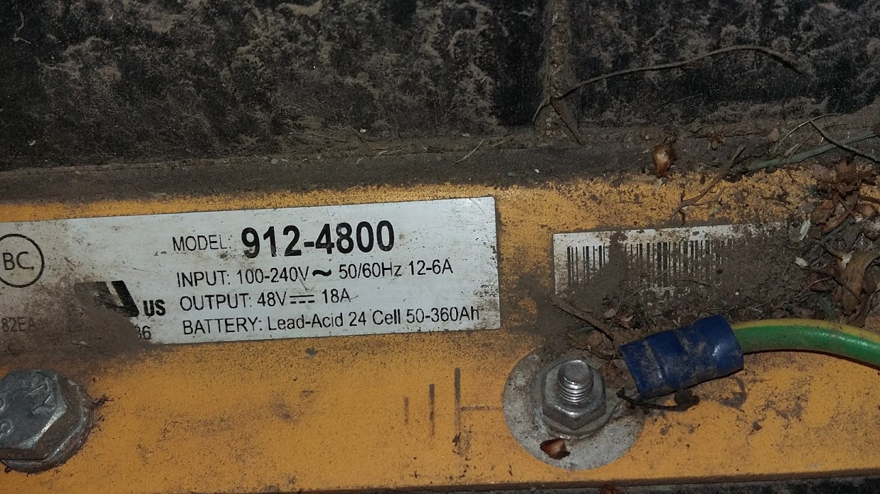

I had the same problem with fork lift chargers, the charger was rated at 100A output at 48 volt, however it would trip the supply at 32A at 230 volt with a C32 MCB.
It was down to in rush of the charger transformer and how low the batteries were, so a day when batteries were only down to 70% charge, the MCB would hold, but if down to 40% which in real teams meant some one forgot to charge them day before, then it would trip.
It seems the chargers and fork lifts were hired so likely original were OK, but they had been swapped by hire company, and plug in and switch on they would trip. Leave them switched on and just plug in and they would hold.
A 13A fuse will stand a huge in rush, we have all seen B32 MCBs trip before a 13A fuse ruptures, not sure if the user puts these golfing trollies on charge, or some employee? It could be all OK if user plugs it in, but if an employee plugs them all in together at end of working day then may cause a problem.
We found with two chargers it depended which was plugged in first.
As to cure, that's not easy, could be just getting the user to plug them in, so all not starting cycle together, but assuming standard three stage charger you have maximum output until voltage hits a pre-set step, at which the voltage is held rather than amps, this time will vary as batteries get older, so it may be when new it only took 1 hour before charge rate dropped now it may be taking 3 hours.
With a simple mobility scooter I found for first 10 years the battery charger took less than 150 watt once charged, but as the batteries got old, then one hears the cooling fan never stops, and they need 250 watt all the time.
