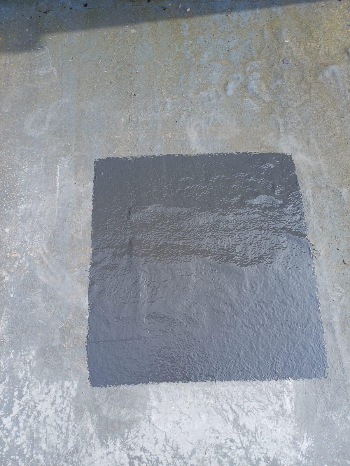

When you say patched up the first time, what did they use? More GRP or some other product?
More GRP

Don't use Acropol, it's not a long-term solution, only really used for emergency patch repairs. Felt and EPDM would fix the problem but it's an expensive solution.
The cheapest option as you have said in your post would be to either locate the areas (pinholes) on the roof where it's leaking and patch it with more GRP or encapsulate the entire roof with another liquid system. I would either go for polyurethane or some of the new hybrid products that don't need a primer or reinforcement. If you are getting a contractor in to do this then they should already know a suitable product but if you're doing it yourself let me know and I'll recommend some products.
